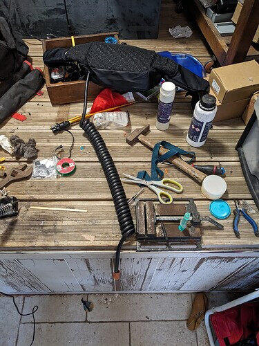

I have used normal rubber cable 3g2.5 combined with spiral waist leash. Keeps the cable out of the water. Use plastic strips in both ends to offload the cable vs leash stretch.

Can you please share some more info regarding the coiled leash length, the 3g2.5 cable length and these plastic strips you mentioned?
Would be great to see some pictures of the leash\cable setup
Thanks

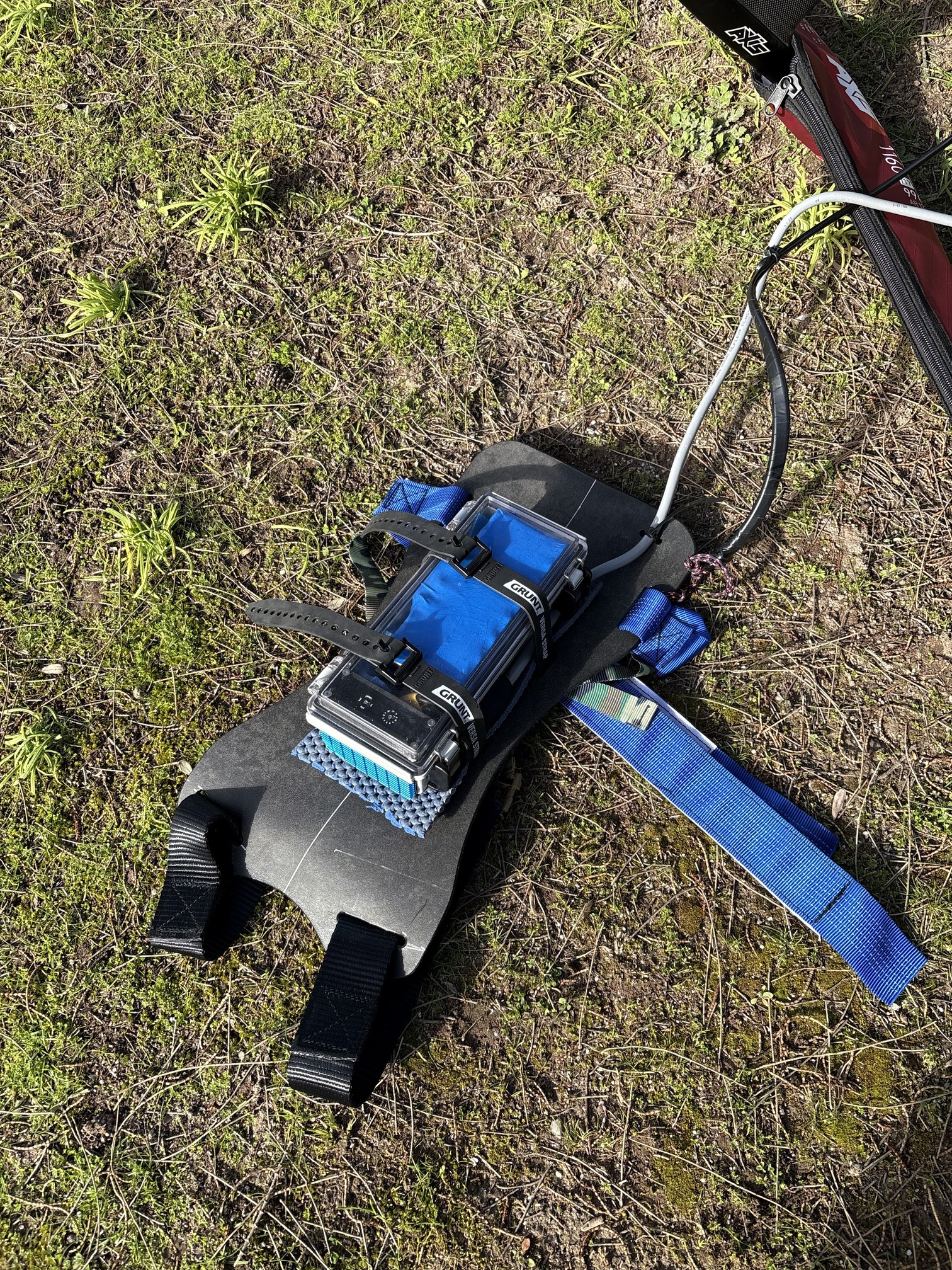

I tried a few options, windsurfing waist harness, small backpack and finally a curved rigid plastic as a fabric free backpack. Lightweight and cools more readily because it’s more exposed to air and water.
The plastic is 6.4mm Kings Starboard, it’s thermosetting HDPE.

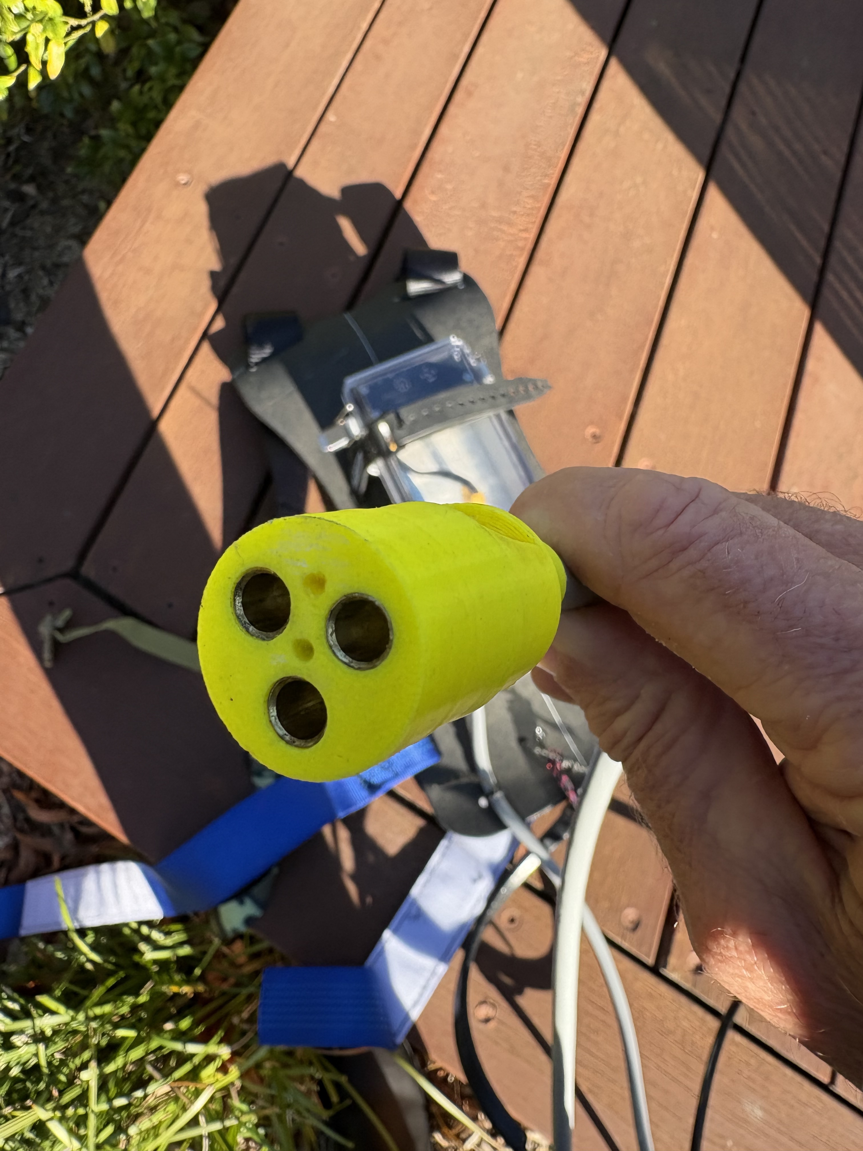

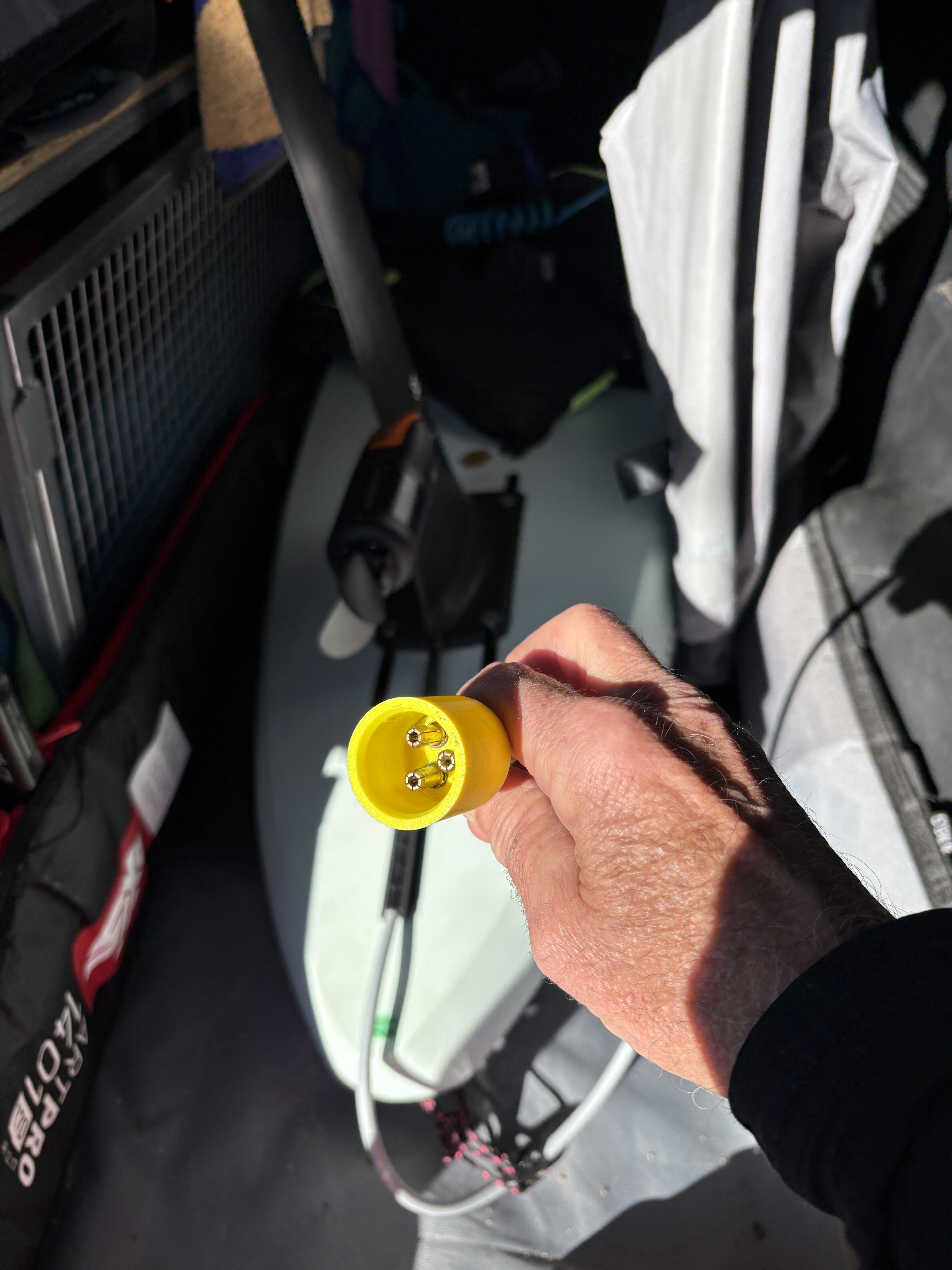

I’ve made a pull apart connector from Tpu that houses three 5.5mm AliExpress bullet connectors. It seals well and the Tpu flexibility works much better than the earlier petg version where alignment was super critical.

This connector will not enable direction switch
No, direction switch is set by wiring and programming - means you don’t have to worry about orientation. Just plug it in and no matter the rotation it goes in the right direction.
Sure you can change it with programming. I suppose it is easy with vesc.
But for example blheli32 testing version works only on windows.
Easiest is to swap wires. But round connector does not help here. I use mr60 after cutting the inside notch.
