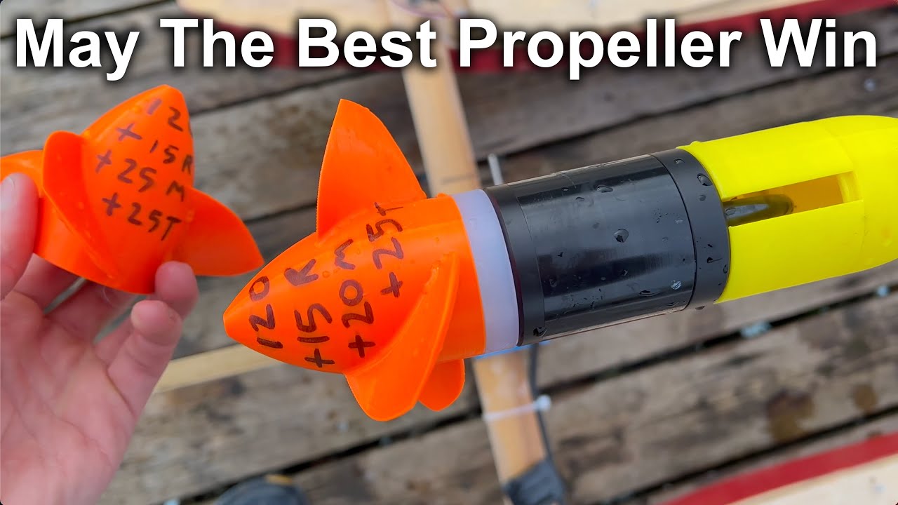

@Kian the YouTube algorithm must serve us some of the same content. I am also curious to see how it goes. He also mentioned in his previous video of the RC air driven self balanced foil board that he wants to make an efoil at some point. So this may eventually lead to an efoil prop.
Seems like a nice parametric design tool that’s freely available in OnShape.
