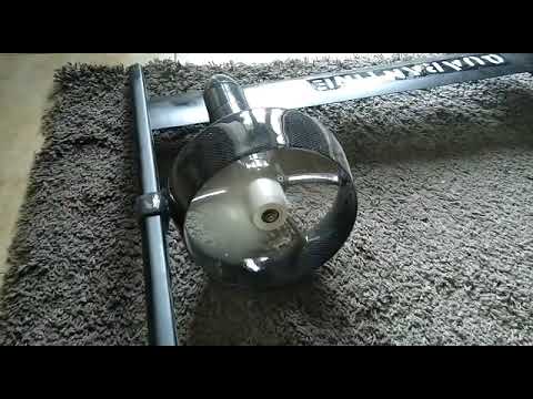

My battery Samsung 30Q 13s12p from Alvilitio came yesterday, I am so happy. It fit well, dimension: 250x240x85mm. The work continnues…
First run of my motor with little problems, I think:
Problem Solved:
