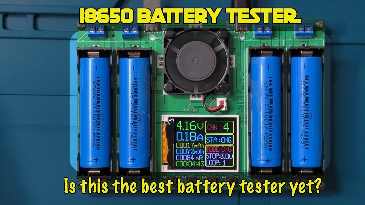

There are cheap battery testers available, like the one shown in this video
Try to find out the real capacity as well as internal resistance and share here.. I have the bad feeling those cells may be too cheap for use in a eFoil battery…

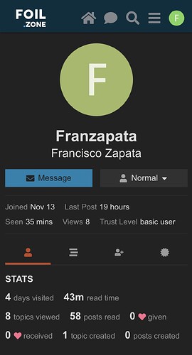

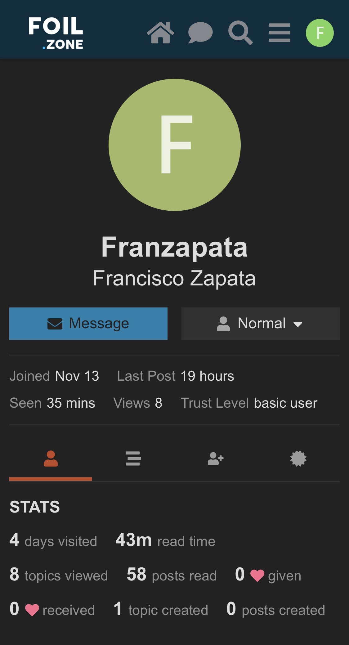

Hmmm you have had 4 people respond and you logged in 35 minutes ago and yet you have not responded.
I’m starting to wonder if are “trolling” :face_with_raised_eyebrow:

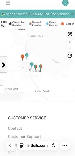

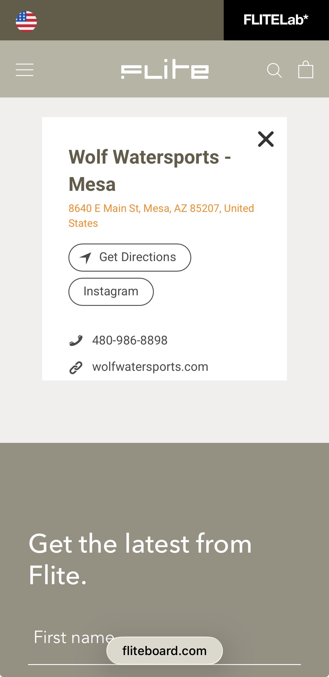

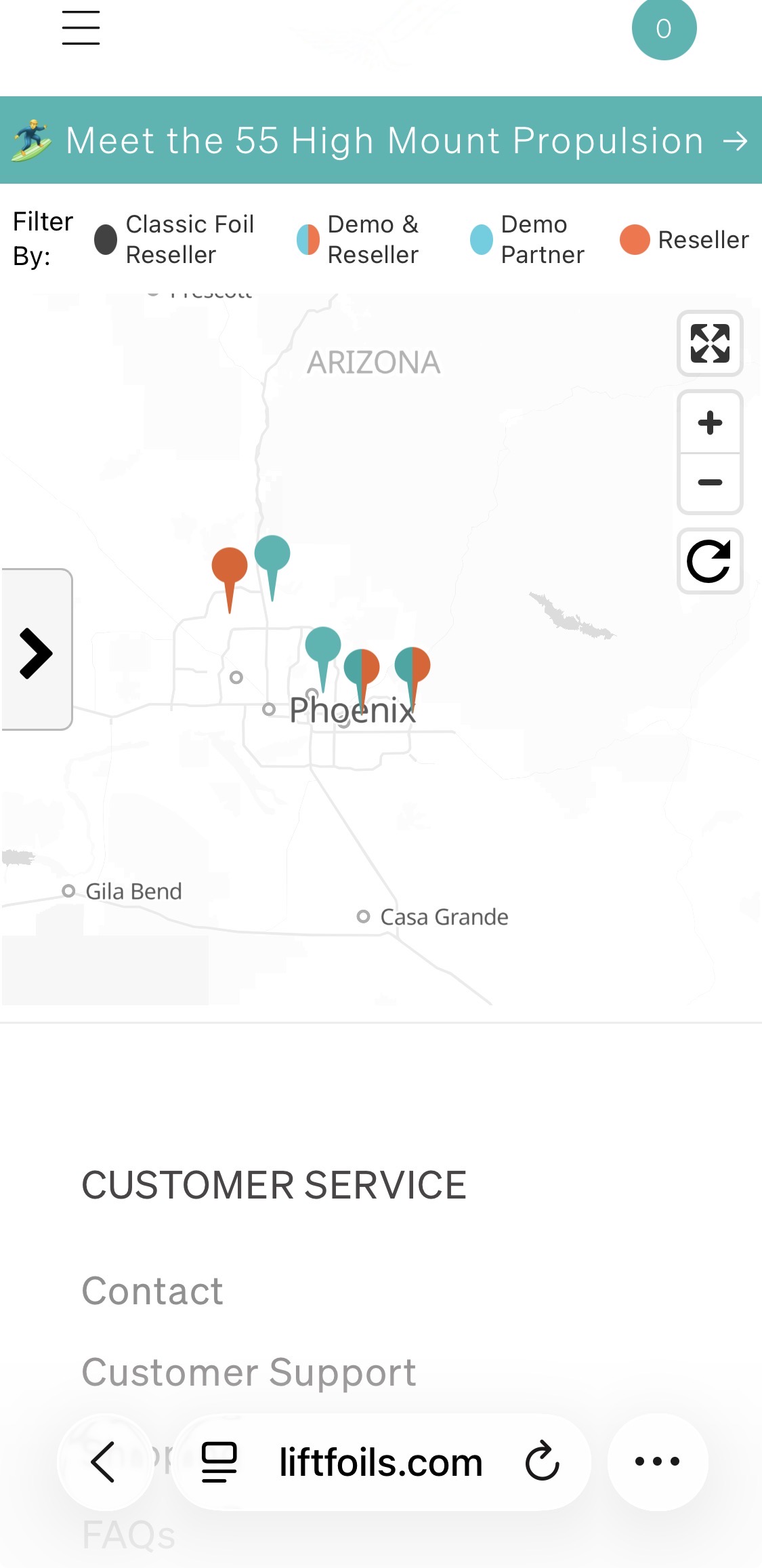

Visit a Fliteboard and/or Liftfoils dealer and see what a top branded efoil setup looks like. Even better take a lesson on water.
Here are locations of both in Arizona
