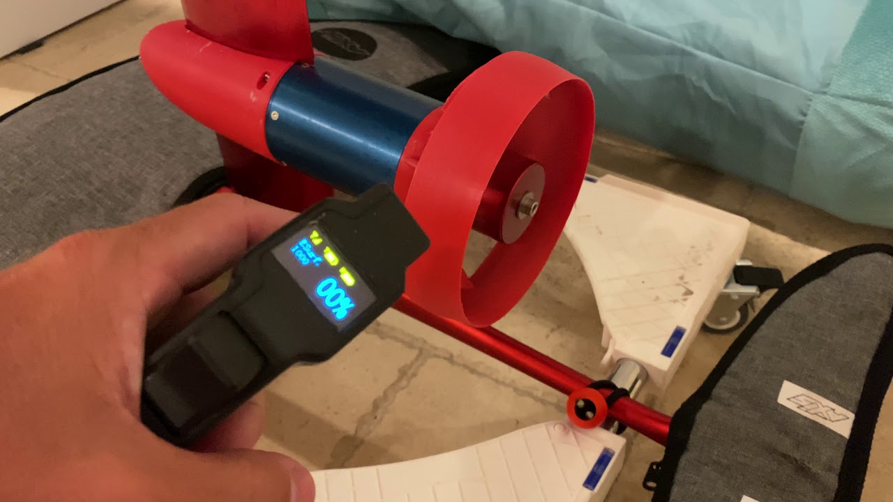

Fast forward to today. I got to talking to @pacificmeister about it and we were wondering if it happened because some remotes like eskateboards have a reverse-neutral-forward concept. Whereas my efoil is basically just neutral-forward with a Maytech remote. Turns out when I turned the efoil on today (out of the water this time) it connected the remote and went full speed reverse straight away! As I moved the throttle to 50% it stopped, and obviously when I went to 100% it went forward.

In the video I see you pressing the remote 2 times before the motor actually responded.
I know that you can program the system by doing short / long presses with the remote.
Could this have caused the reverse option to be set to on?
