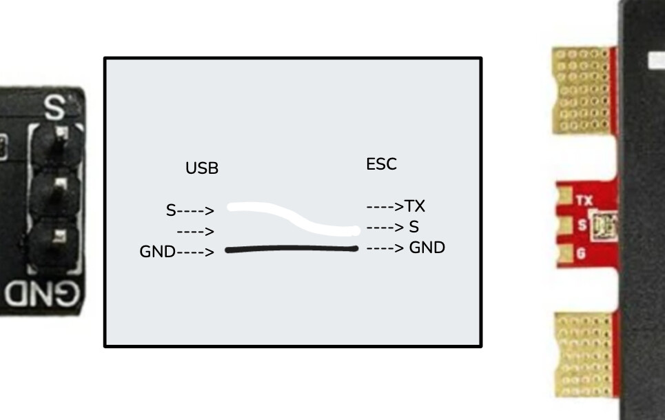

It seems that my issue lies in the need to use BLHeliSuite32 from Sequre, which is Windows OS only. I got it working with UTM emulator running BLHeliSuite32 on Windows.
I will suggest to anyone buying a Sequre ESC to only choose the AM32 version, but I suppose this is relatively common knowledge.
Here is a wiring diagram, as the USB to ESC wiring is not documented (though somewhat obvious )

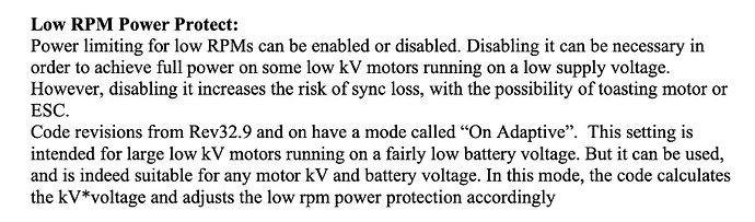

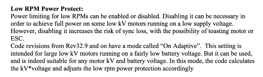

The issue seemed to be the throttle max and throttle centre were 2000 and 1500 which I changed to 1500 and 1250 respectively. I changed some other things too (Low RPM Power Protect = off), but not sure exactly what it was.
Here are the Blheli_32 settings, based on that I suspect it to be the Low RPM Power Protect based on what it does
I am pretty sure I did the same, so that is the setting I would try first.
