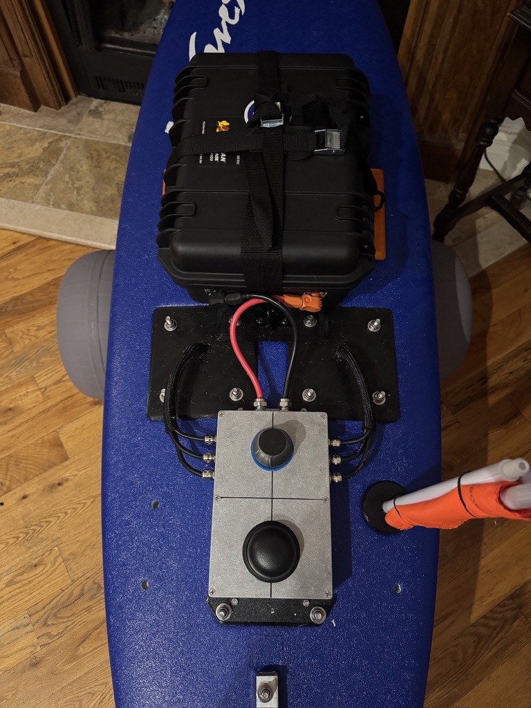

I’m thinking about the possibility to swap from a Pelican case to another for a spare battery on my tow boogie.
It means that I would need to have ESC’s + receiver + cooler in a dedicated box.
For the moment all the elements are in the same Pelican case.
Do you think it’s doable to connect battery wires with amphenol connectors like an efoil but outside or in a wet environment ?
Is there a risk of short circuit if the boogie rolls over ?
Maybe, two Camden boxes back to back.
The battery alone in its separate box (12s5p ?)
yes, thats what I am doing and no problems so far. alu ESC box which acts as a giant heatsink.

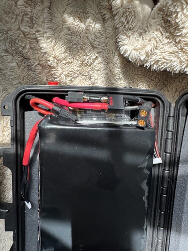

How do you do when you connect your batterie cables with amphenol, are they antispark ? Or you run a BMS ?
It’s 2x 7s12p batteries, connected in series using QS8 connectors, which are anti spark.
I plug the amphenol plugs first with no charge, then the internal QS8 and close the pelican box.
The batteries are stacked on top of each other in the below pic (and yes I’ve covered those exposed neg terminals… this was a wip picture)
