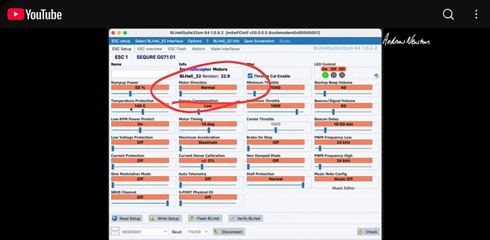

I already did it, I was unable to calibrate the ESC correctly. I had to keep the break pushed to have 0 throttle.
Which esc you are using? Needs to be configurate in the menu of the esc also.
I’ve got 2 Sequre 12200 based on BLheli 32.
I program it with my phone and USB chip.
If you’ve got advices on values to enter for the throttle, I would be please to read it.
Sorry but myself only got settings for vesc 75200 and 75350.Normally you have to switch on the reverse option in the app config from the esc and in the remote itself.
But I found this for you. There you have to change to bidirectional. Hope it will work.
Absolutely :pray:, I’ll go through this function to test and report.

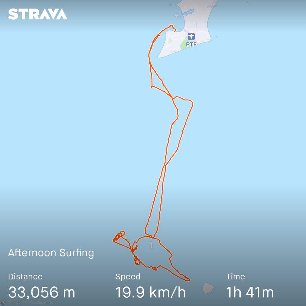

Long mission today down the coast to see what sort of range is possible with two batteries.
As I got closer to home I went exploring a bit more and caught a few waves. So could have made the journey with a bit more battery spare.
Foil was an Armstrong 680 on a 32L board. I’m 95kg.
50 km is great. That’s some awesome range
