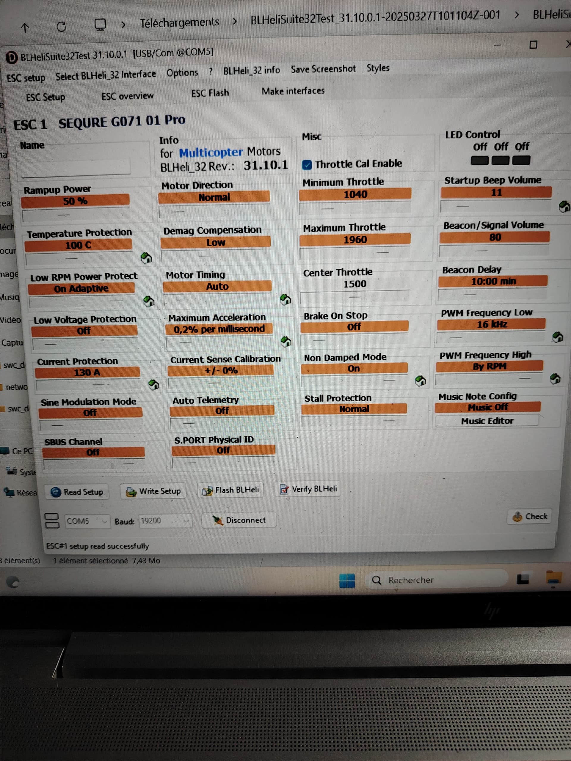

I am using this config for my sequre 12200
Try
Low RPM Power protect = off
I had some issues and managed to resolve it here, and I think it was Low Power RPM
Thanks will give it a try.
Try to set Current Sense calibration to 100%
Ok will do. Not crystal clear for me what this one does. Understood it plays with some variation on the current sensor components but explanation on Google are not straight forward for me.
I try those settings seems a little bit better but my battery was lower so I am not sure Processing: 1000010635.jpg…
