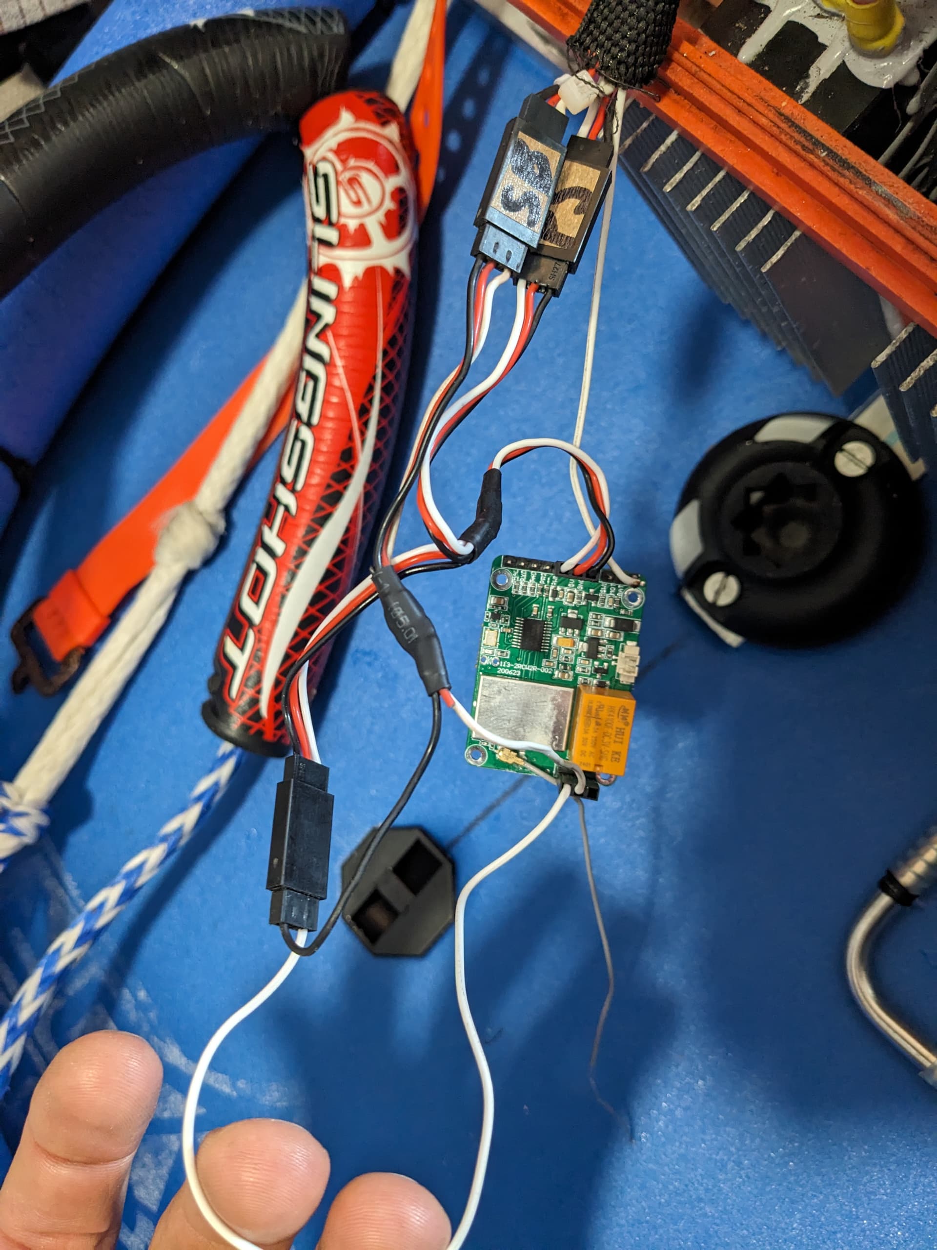

Hi everyone,
Does someone know how to make a propeller spin in the other side with the Maytech Remote please ? In order to change the course of the boogie.
I know how to stop a motor remotely on a dual motor tow boogie with the relay/switch system on the receiver but I would like to find a solution for single motor. (Starboard motor SB on the picture).
You can cut the signal of one motor by pressing 3 times the ON/OFF button. It opens the switch controlled by the orange relay. Originally for lights or pump.
Flipsky VX3 pro remote has motor reverse function integrated by the way !!! Very good to know for single motor boogie users.
Go to ESK8 instead of ESurf Mode in the settings of the remote.
