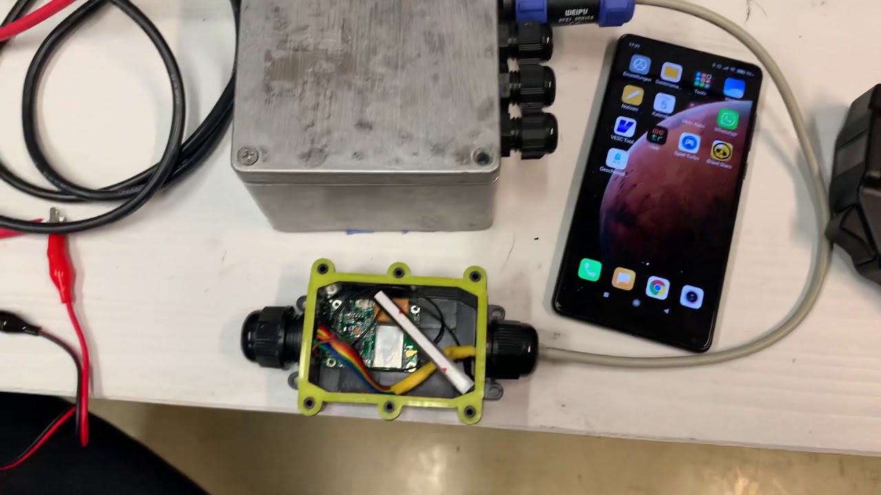

Today i find a little bit time and continuing my V2 project.
I soldered all cables and connect theme.
Powered on the VESC and it seems to me, all is working fine.
