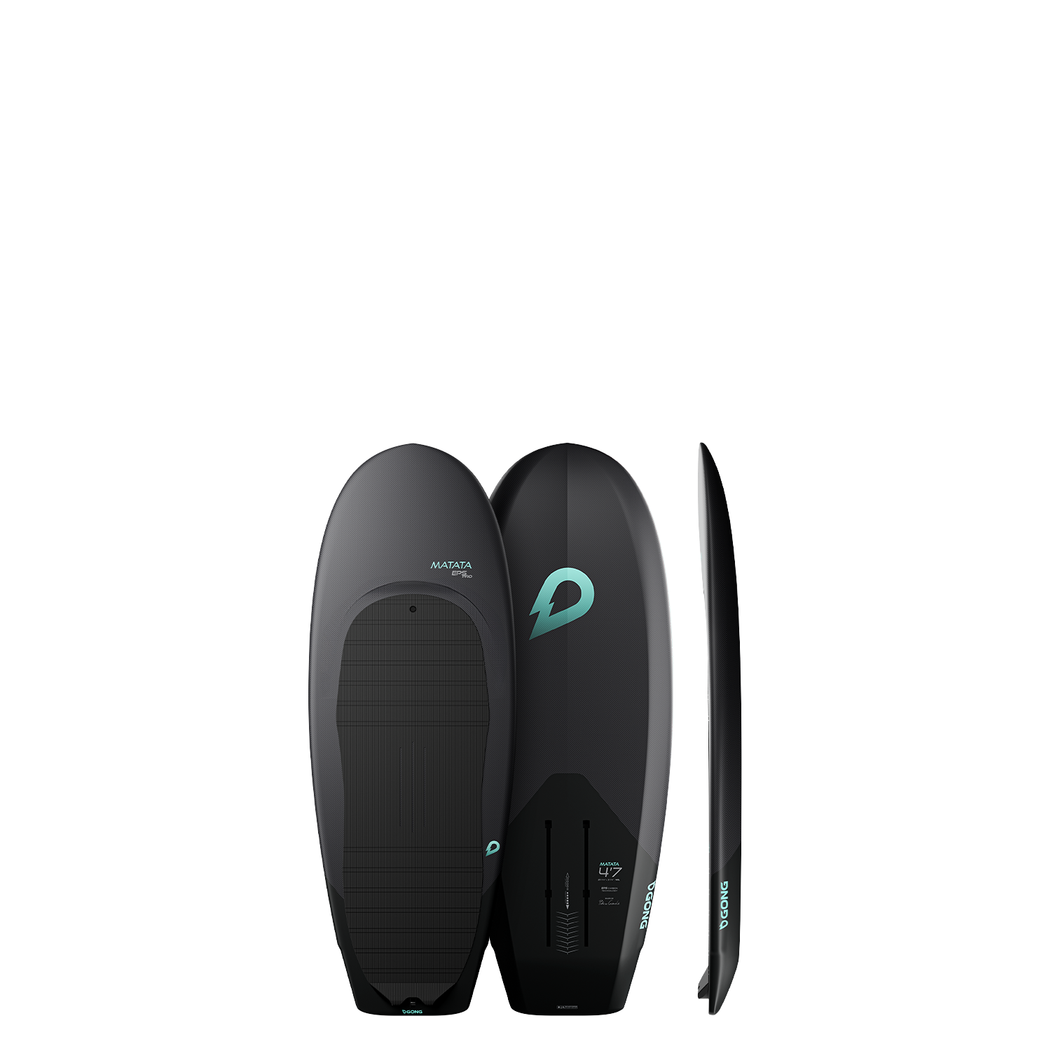

Board: Gong Matata EPS Pro + Aluminium bottom plate + 3d Printed parts 650€

The Gong site has a vast array of items so not sure if this is the board you picked to “modify”
If it is I would point out that with the double concave bottom shape I think you would be hard pressed to find the depth for battery and/or vesc inside the board especially combined with the fairly short length and low volume.
If it won’t fit inside you wouldn’t have deck space to mount externally
It was just an example board to use :slight_smile:
