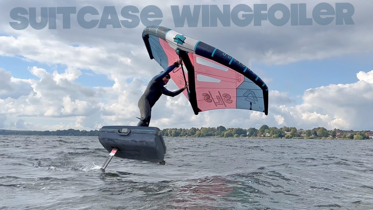

Instead of a rifle case you could also use a suitcase I guess.
It did not work for this person, but this was with wing foiling.
Add a motor, and it should work ![]()
