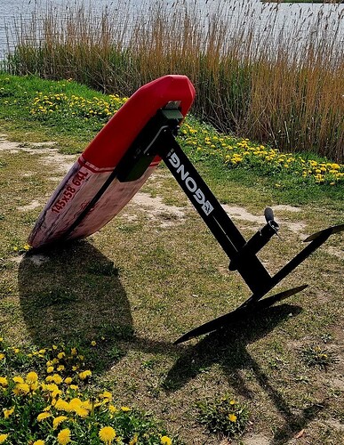

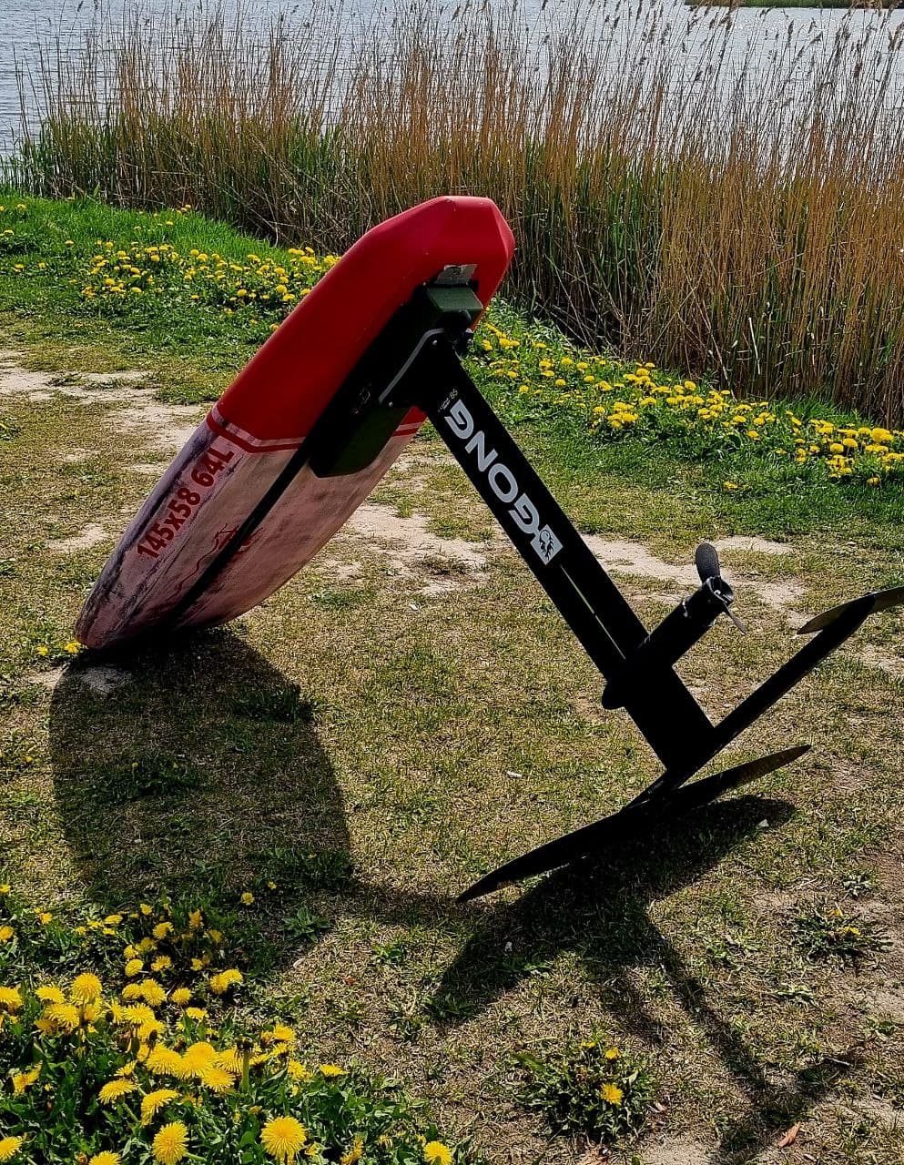

145x58 64L. Battery 12s 3p 12 A/h. I would like a smaller board, 35-40 liters. Something like Cabrinha Bump. The wing (Gong Veloce 1600) and mast were just lying around in the garage, and now I finally found a use for them.
