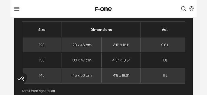

I searched for your board specs and came up with this
Assuming it’s the 11L board I think you are going to have a lot of trouble using it to efoil
You have approx 7kg of battery and 3kg of motor plus the weight of the foil and other items required so not much for body weight.
I weigh 85kg and use a 100l Fliteboard and while at standstill when I’m laying on it it’s about 1/2 submerged. Lots of volume to get up easily - can’t imagine the struggle to launch a board with 1/10 the volume!
