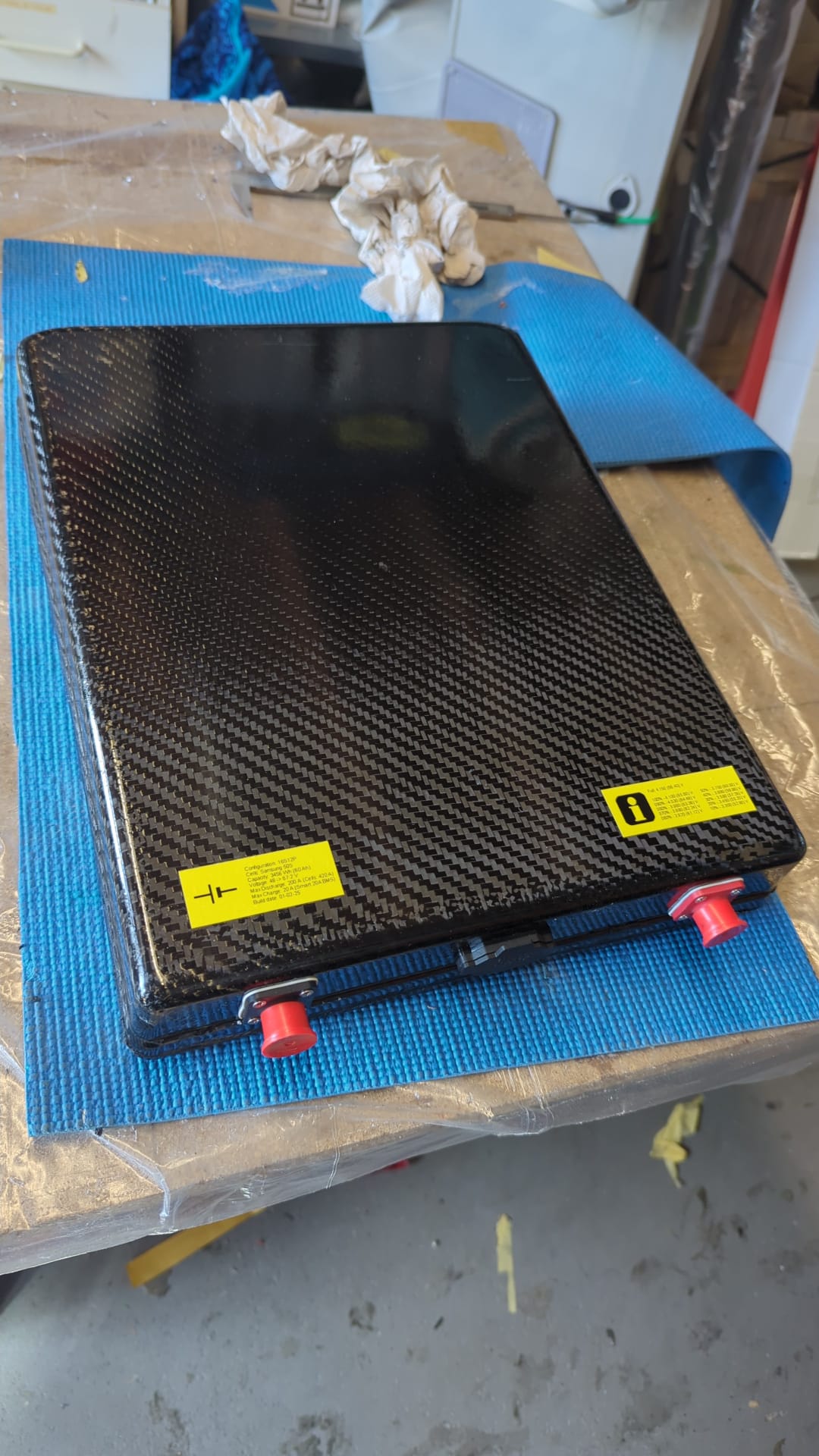

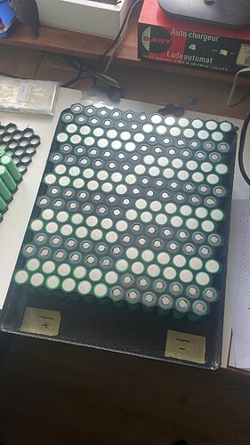

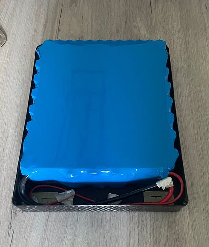

Nice looking battery.
What nickel or steel strips do you use?
Also do you have an example an image of the series connections for this battery?
Great setup, but did you make the box yourself? Can I know what cells you used? Or above all, why do many of you choose high-amperage cells, since parallel configurations add up? No more energy is wasted and the battery drains faster. Aren’t 5000mAh cells with a max 15 amps enough?
