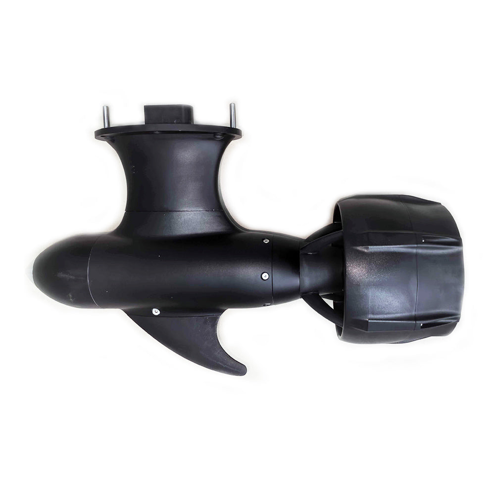

Dolphin 3-The Next Generation Water Rescue Robot :eyes:
Hey guys, I am attracted to the single motor pivot set up - does anyone know where I can buy a motor that pivots? Flipsky? surely this would be cheaper than building a dual motor setup?

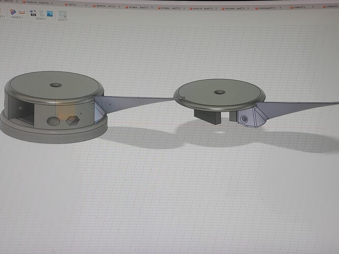

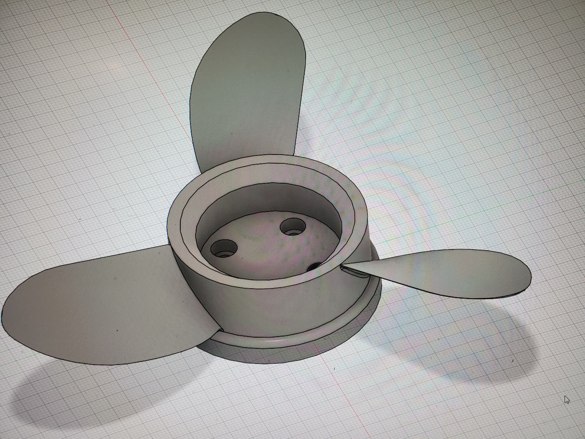

I made it a long time ago, but haven’t tested it.
I started to doubt whether this was a good idea and whether it wouldn’t be easier to make removable inserts that hold the blades in place.

It’s probably better to have individual blades and sandwich them between a two piece hub so that they cannot close?
It’s bad not to know the language. That’s basically what I meant.
I used a 3D print slicer software to mirror before sending it off for 3D aluminium printing. 3 original, 3 mirrored.

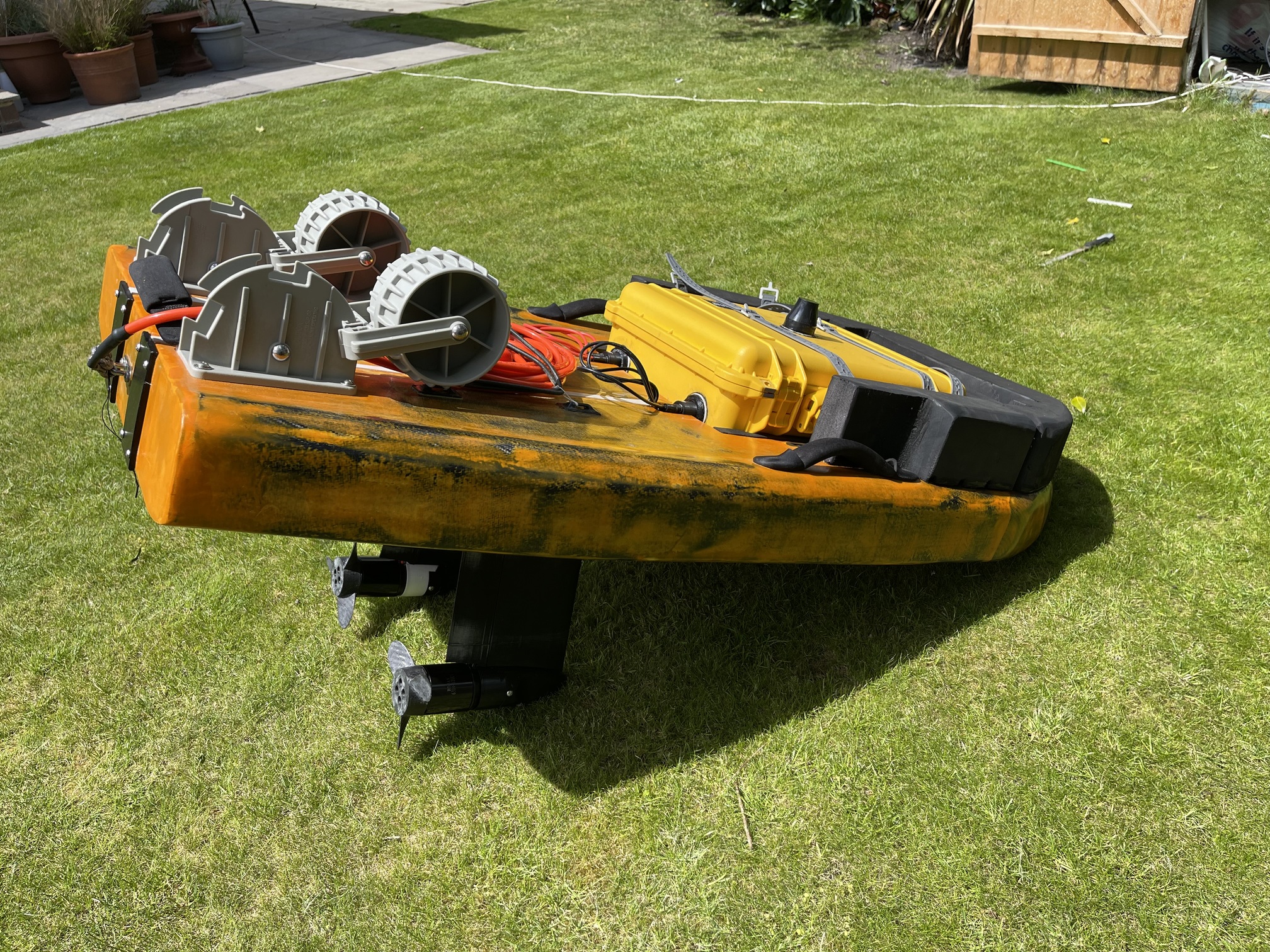

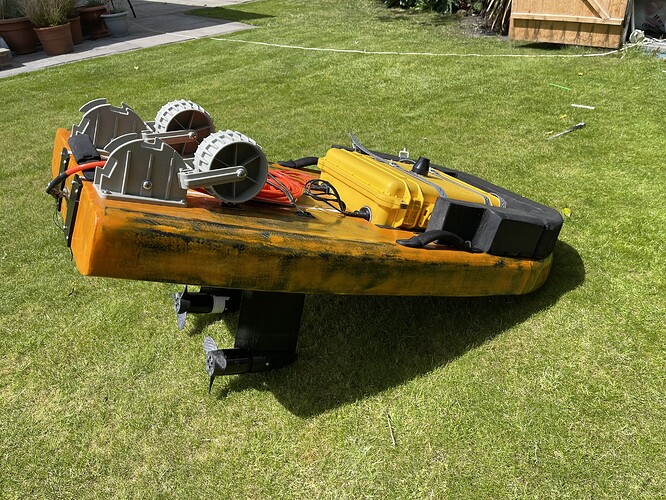

I don’t have a problem with the folding props either. It is the fixed props that i had problems with. I designed a 3 blade prop which was basically the same as the same as my 3 blade aluminium folding prop when fully folded out and it ran great. Better than folding but turned out to be no good without the c clip holding the can in place.
I use these folding wheels to get my boogie to the beach. Working well so far.
