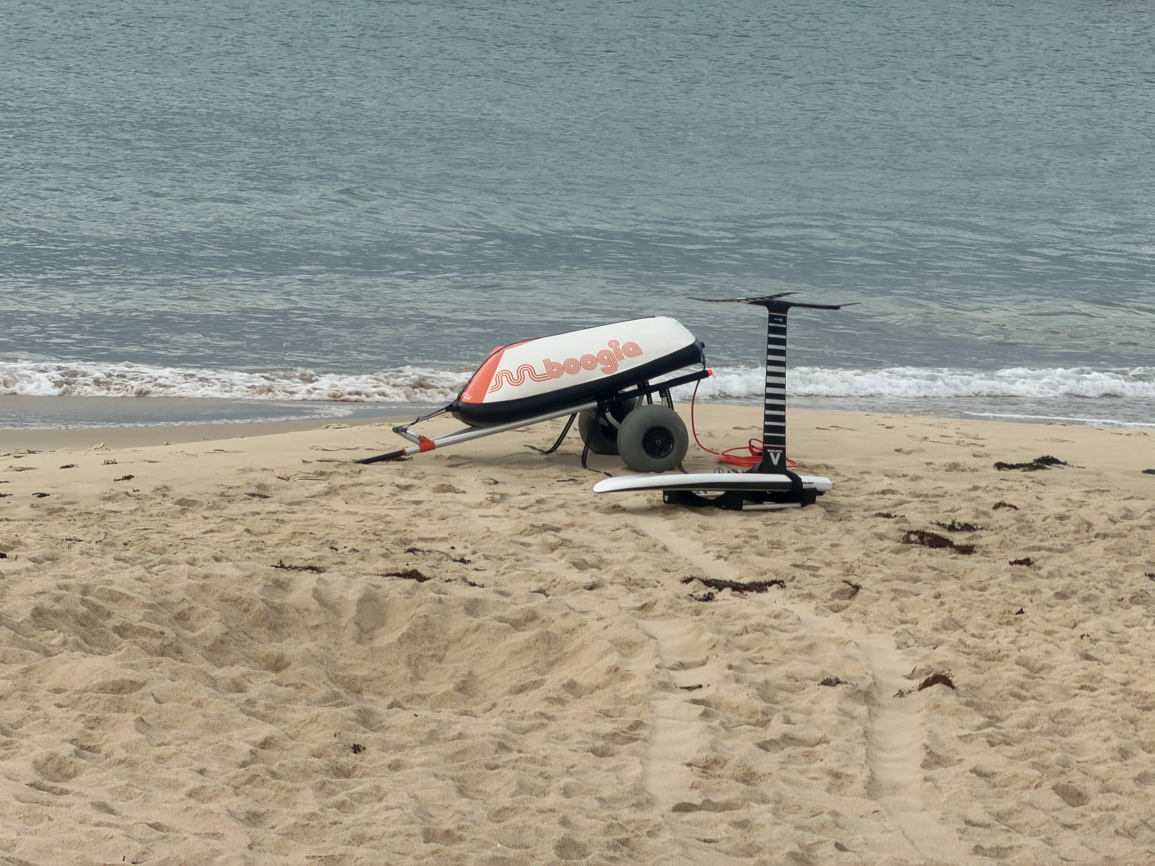

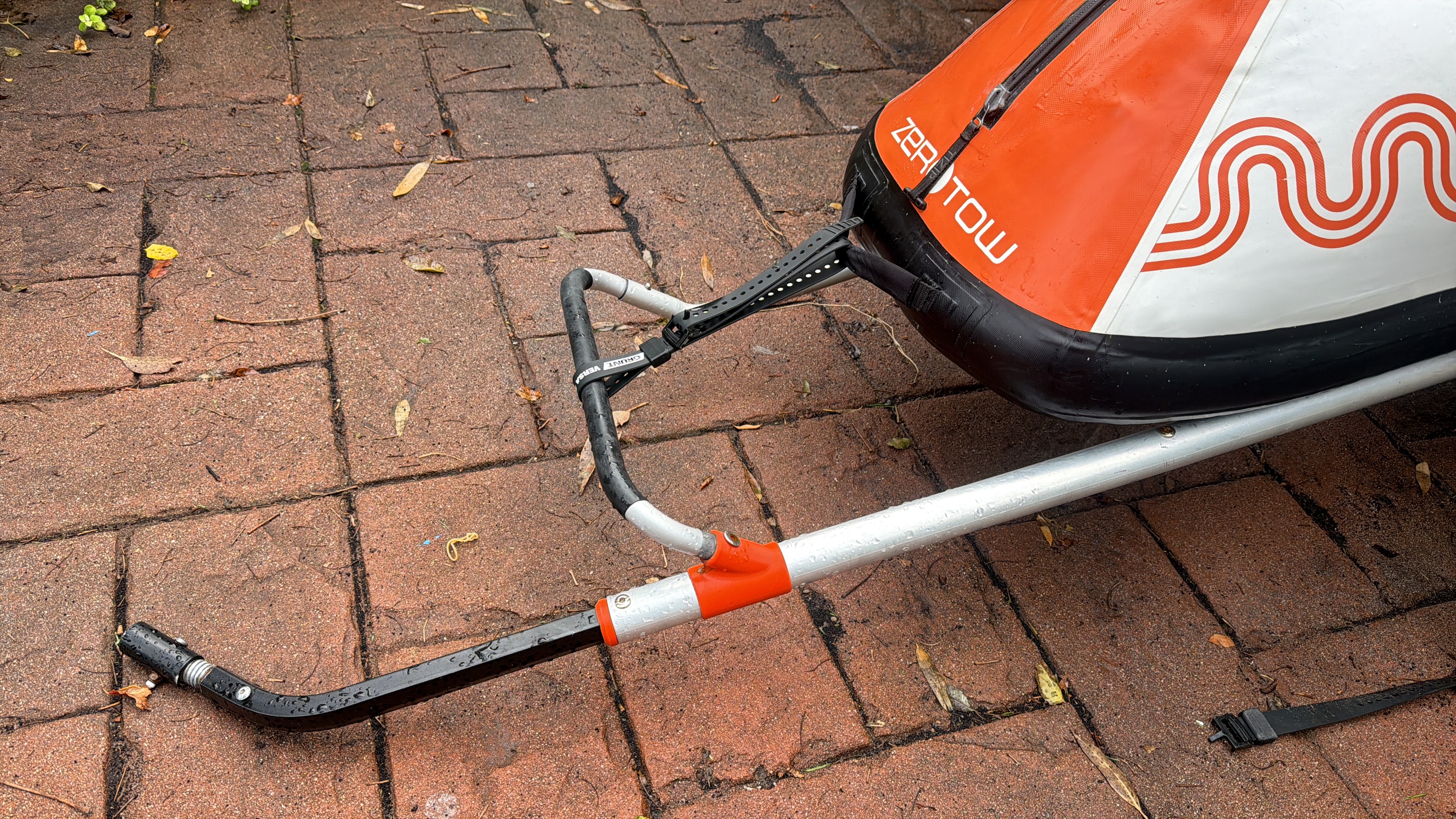

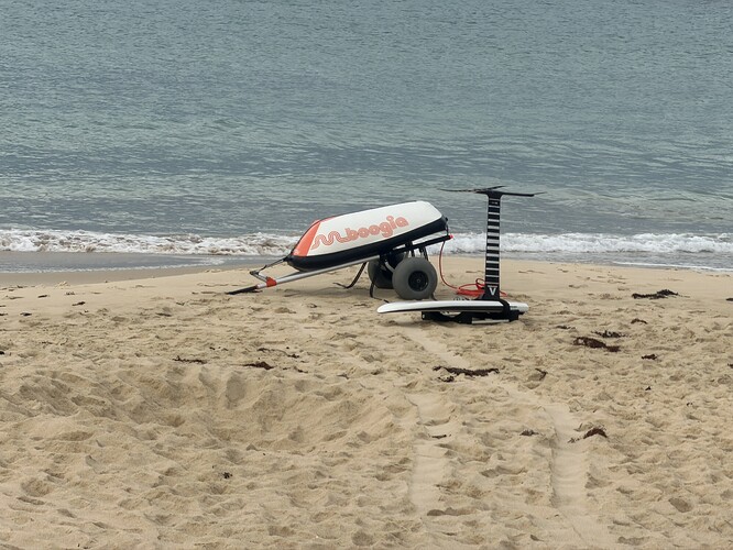

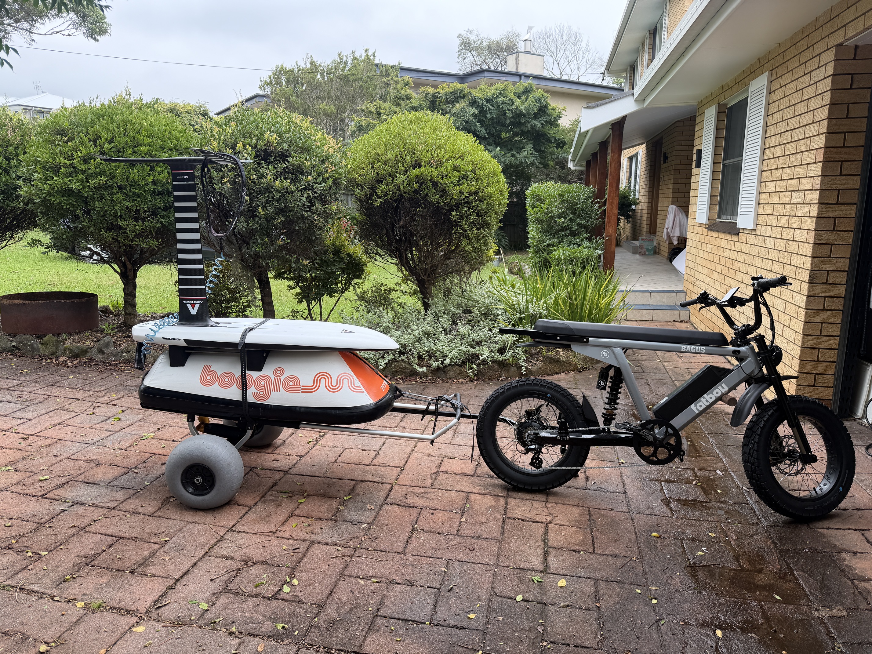

Have a look at the trolley that we do for inspiration- my boogie lives on it makes the process really easy. Can do almost no lifting if you have a good launch spot.
I modified it for my e-bike as well, works great but need to upgrade to proper bearings, have already worn though a set of aluminum axles.
I use your trolley for my boogie so much easier to get it down beach launch now.

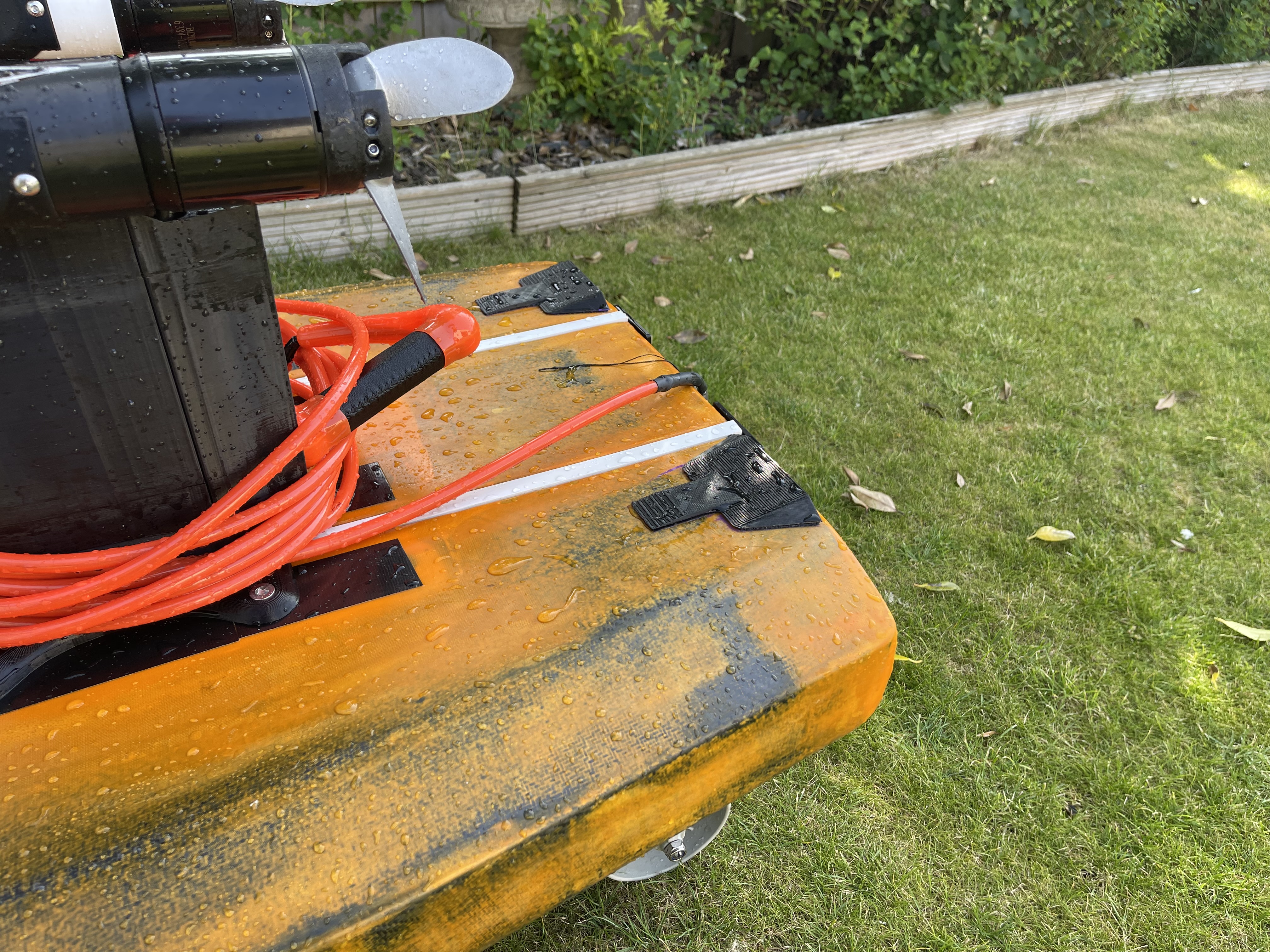

@rttn was it yourself that shared your trim tabs with me via my YouTube channel? If so, thanks so much. I’ve now got a boogie that is rock solid in surf and relatively bumpy conditions. My set up needs the motors only 11” from the rear and on 2 degree shims to tilt the motors down followed by these rim shims at 1cm high.
Yes, that was me. Glad it worked out for you.

I printed some and added to the board today.
Now it goes straight easily, but turns far far harder.
Not sure what I prefer. Probably trying smaller ones next.
How far apart are your motors? That played quite a big part in turning angle for me. I printed my base plate at different angles until I had the motors at a distance apart that worked well.
About 18cm.
But it turned fine before and the flaps also added too much drag for my setup.
Was a good test considering it took only a few minutes to set up.
I will try again with smaller ones and closer to the center line.

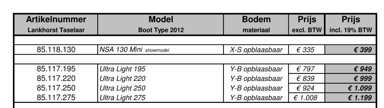

Hello friends,

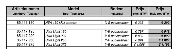

Good news, another brand registered for inflatable hulls : Lodestar NSA 130 mini Showmodel ( Ref 85.118.130)
https://www.youtube.com/watch?v=bfVy3Rqh53o
But where can you actually get them. I can’t find a purchase link.
From a 2012 Brochure with weblinks which are now broken. I’d love to buy one, especially for 335 euros.
