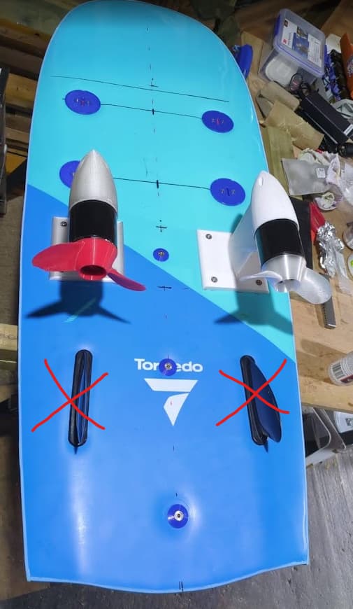

Depends on your setup. For a boogie with Differential steering, I took my fins off because they increased the radius of the turning circle by a large amount. I use Bremote V2 which has calibration options for tuning the power to each motor, fixing any tendency to drift in one direction.
How do you deal with the board yawing from side to side at high speeds?
I considered installing two fina as well but ended up putting only one in in the aft, center.
I also noticed you have no trim tabs, I assume you have no issues with the nose going up?

I wouldn’t give any definitive advice. If you’re happy with everything, there’s no point in changing anything. Trimmers also have their drawbacks. They drain the battery slightly. If you’re riding fast and suddenly release the trigger, the nose of the board may drop, and if you don’t let it level out and then press the throttle again, the board will start to dive. But if you want your board to fly like an arrow or take turns at full speed, then there’s no alternative to trimmers. I think I’ll give you one piece of advice, though. You can print out trimmers and install them with double-sided tape to see if they’re necessary.
Thanks. Agree that’s an easy and quick task to try them out.
Thanks for the tabs, I ended up printing them and today was the first time I ran with them.
What a night and day difference, simply wow!!
The boogie is stable, I get very little ventilation in comparison to what I used to get. Prior to using the tabs, I had to drop the throttle immediately after getting on the foil - slack line would prompt boogie to gain speed and lift the nose way up, exposing one side and grabbing air. If not corrected, it would capsize, which was very annoying.
I had to learn to deal with it but after installing the tabs I’m happy to report that not only it is way more stable at high speed with no rider load, I was also able to drop one gear down. Crazy.
The only downside is that the boogie I have, has channels in the aft and I had to use a double sided tape + a regular tape to cover up the gaps in between the tabs and the bottom. I suppose next step would be to tweak the tabs to match the curvature of the channels.
Either way, it’s great, I had a blast of a session.
