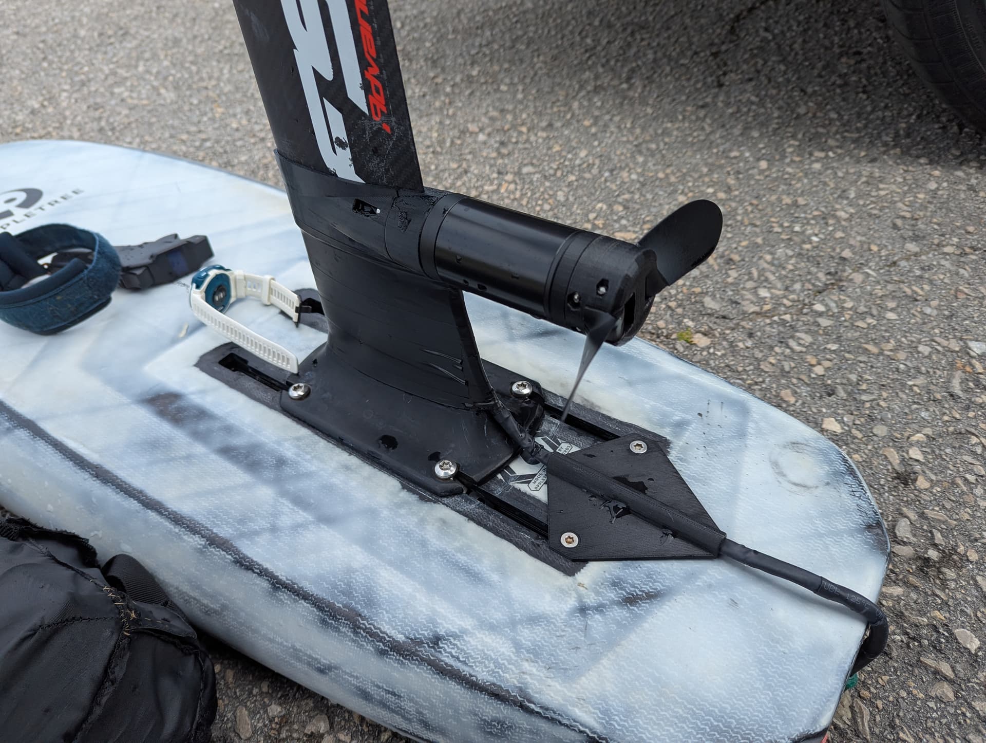

Hello, I am in Santander at the moment unfortunately. Usually in south portugal winter time. It’s the LD28 docking, longest version of the 3 options. For the cable, 3core 13AWG, stretch 2 meter (actual uncoiled length is about 3.5m), https://es.aliexpress.com/item/1005003176716502.html?spm=a2g0o.order_list.order_list_main.85.5d361802lU2K4D&gatewayAdapt=glo2esp
For the ozone wingfoil leash (one size I think), I cut it about 20% so that maximum stretched length is 2 meters, coiled cable is 2.5m, this way it takes all the force and protects the coiled cable.

Thanks for the reply ! Do you cut the coiled cable so its then 2,5 uncoiled ?
Yes! And the leash is 2m so it’s really safe. Both could be a bit shorter to save weight if only dealing with small waves

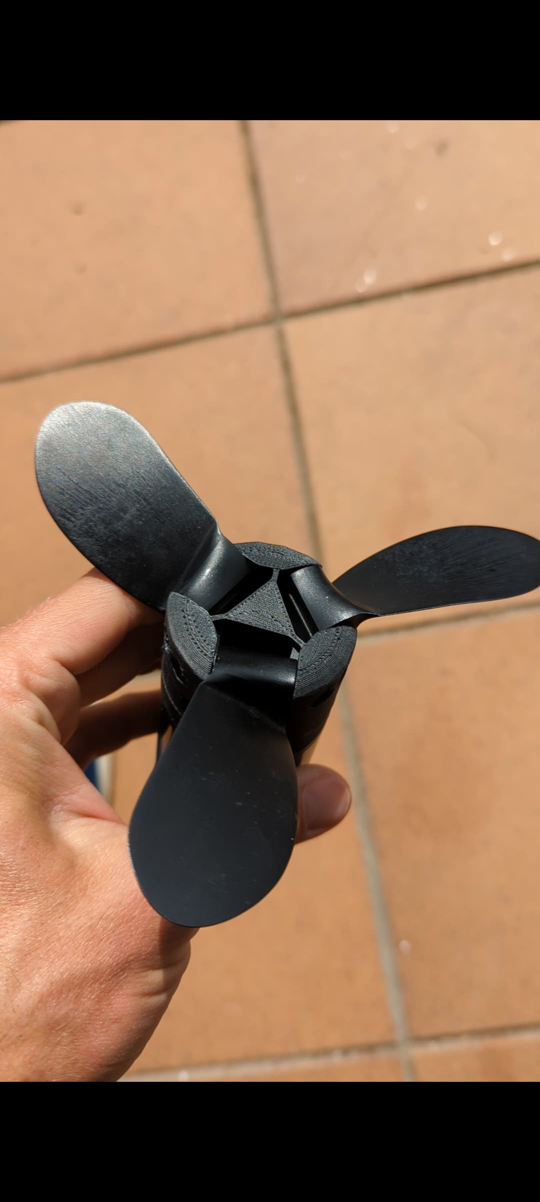

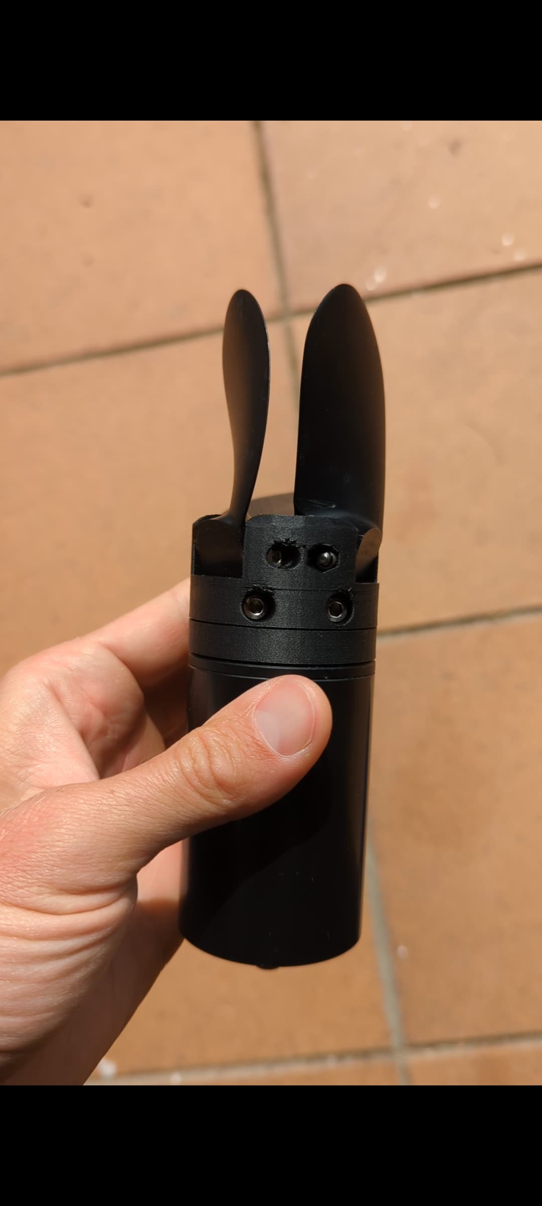

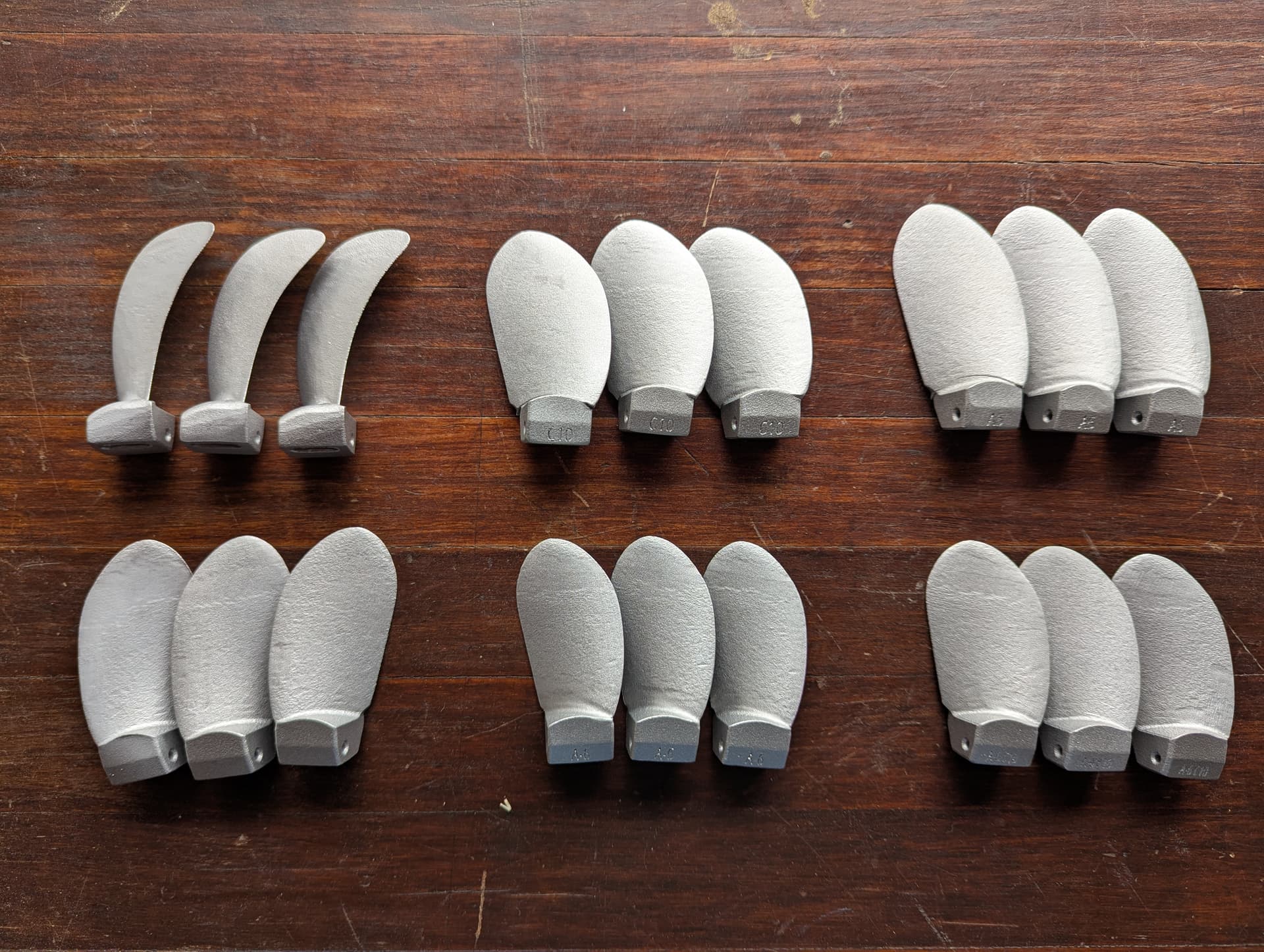

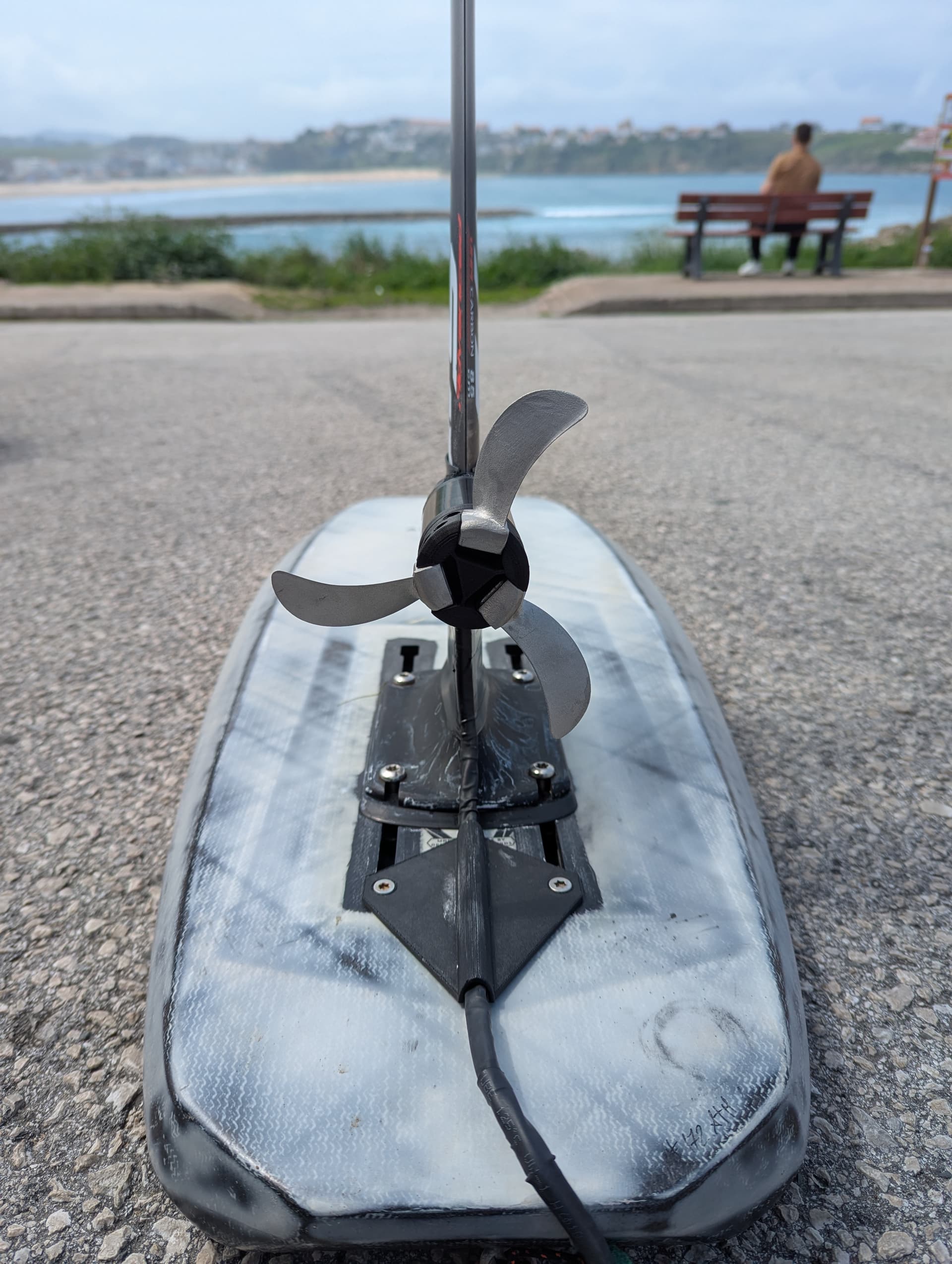

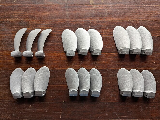

I am using 3 foildrive alu blades. I tried 2 blades and I would say it’s not as good, less low end, more top end, more energy consumption it seems (5-10%) as the motor needs to run faster to produce the same thrust. I tried a bunch of proto blades but I have not found better so far. Currently running the 750 silk v2 and able to flat water start quite easily, I get around 13km of session out of 13ah battery which is great, same as the 6384 motor I would say.
These? Aluminium Propellers (Three)
What are you using for the hub? Thanks. I have 5085 and looking for a prop
Yes, I am using the kparts blades that are supposedly the same. For the hub I made my own model that is on tinkercad if you want it, it has a diagonal bottom mount to swap hubs/blades easily. 3d printed in petg-cf 30 walls, it’s basically 100% filled.
