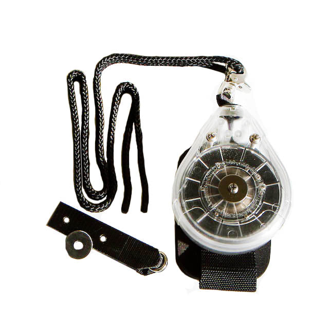

I have not yet foiled but I was thinking of using a retractable style kiting leash to stay attached while still safely away from the board doing crazy things.
I was thinking of getting this:
