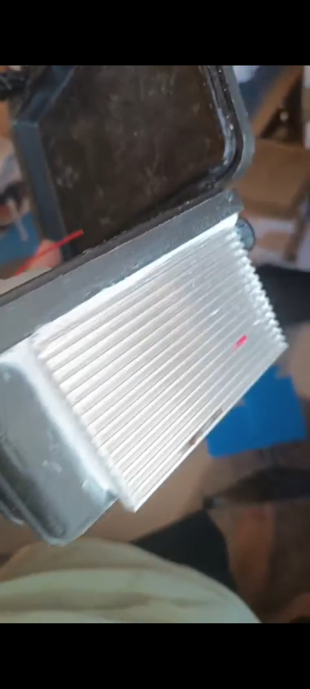

@salomon
Similar to your radiator :smiley:

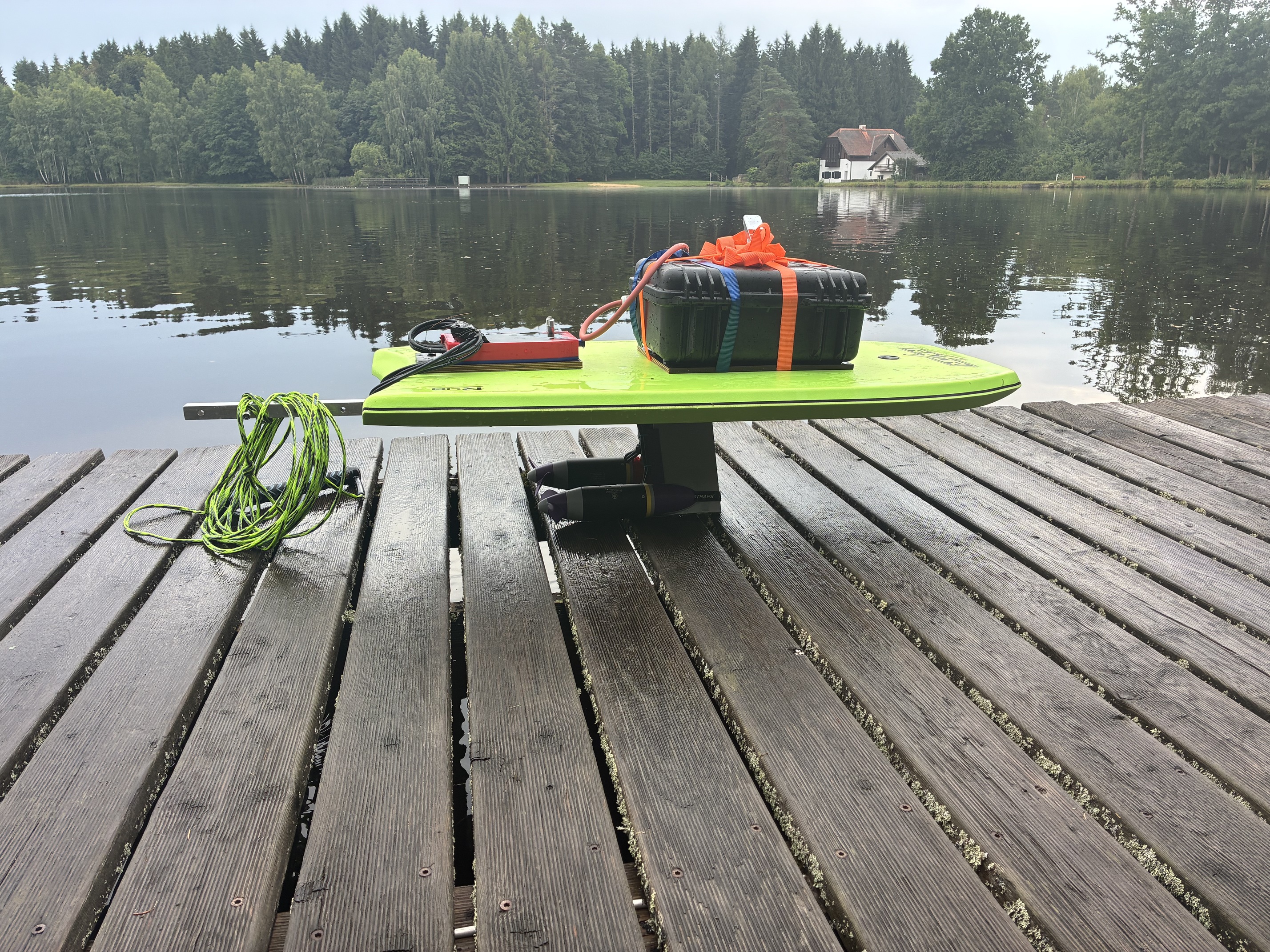

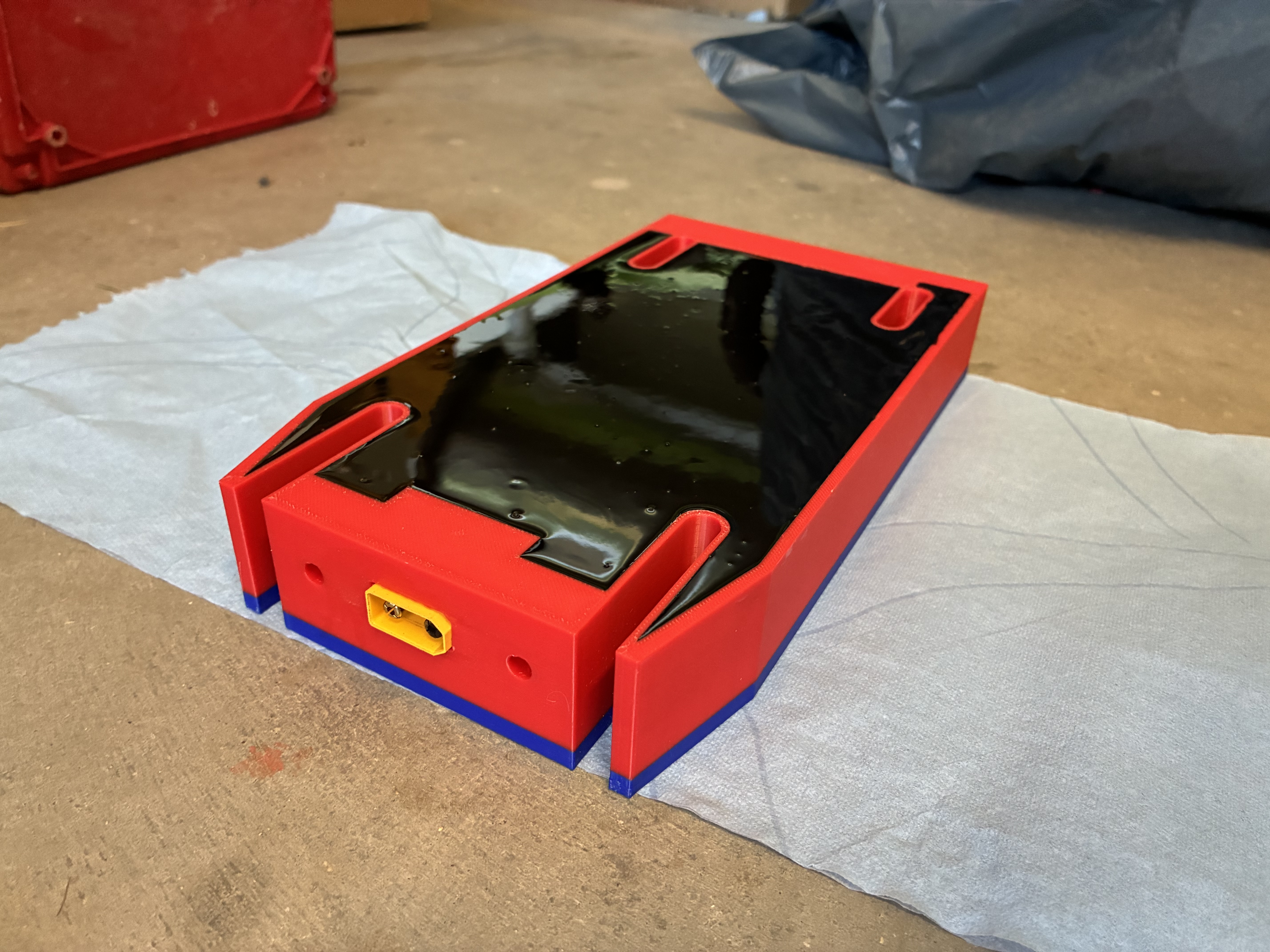

First test in waves was successful. The Overboard bag is IP66 as stated, there where a small drip or two inside the bag after 5 minutes of cruising around (not fully charged battery to keep voltage down). Felt scary to only have plastic bags around the battery (in addition to 3d printed housings) so I plan on adding a fuse to each battery cable in case of XT90 shorting on water ingress. Will look into ways of improving the bags folding seal, it’s really comfortable. Input on risk and mitigations are welcome.
I have had no water issues in my new bag until now. Not even one drop. But it looks like there is some steam in the bags of the battery after usage. Propably because of the heating and cooling down afterwards. Until now I had no issues at all, but I am testing in fresh water.

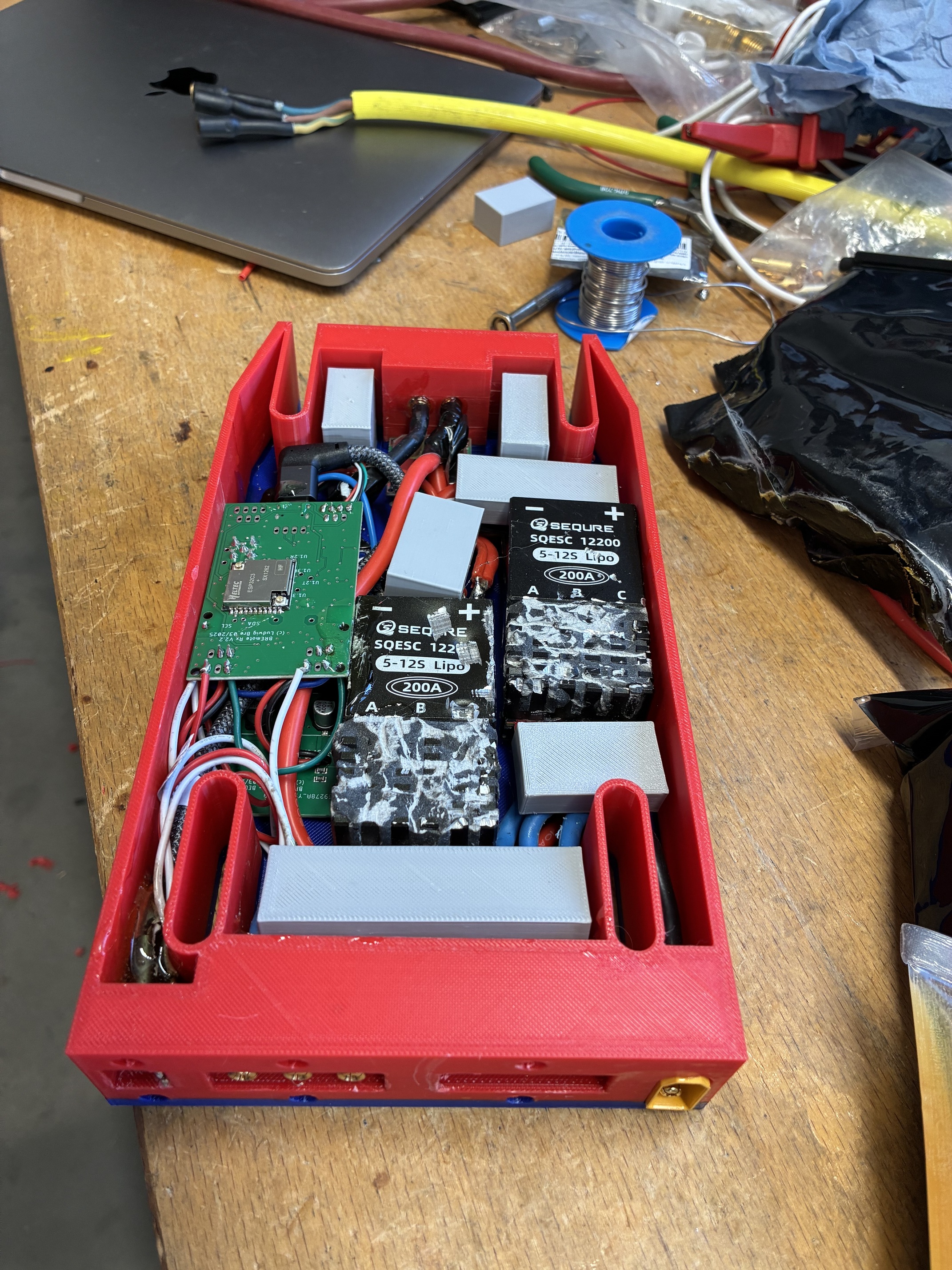

Last time I did a lot of deep water starts on my 14 Liter board and still had no heat issue with the Makerbase VESC 84100 without additional cooling.

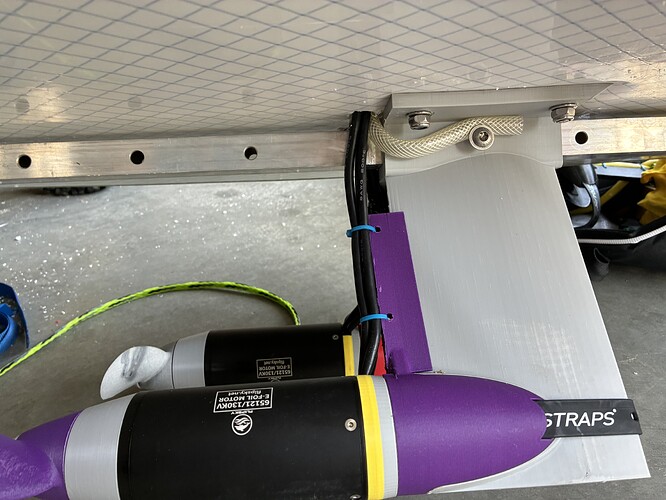

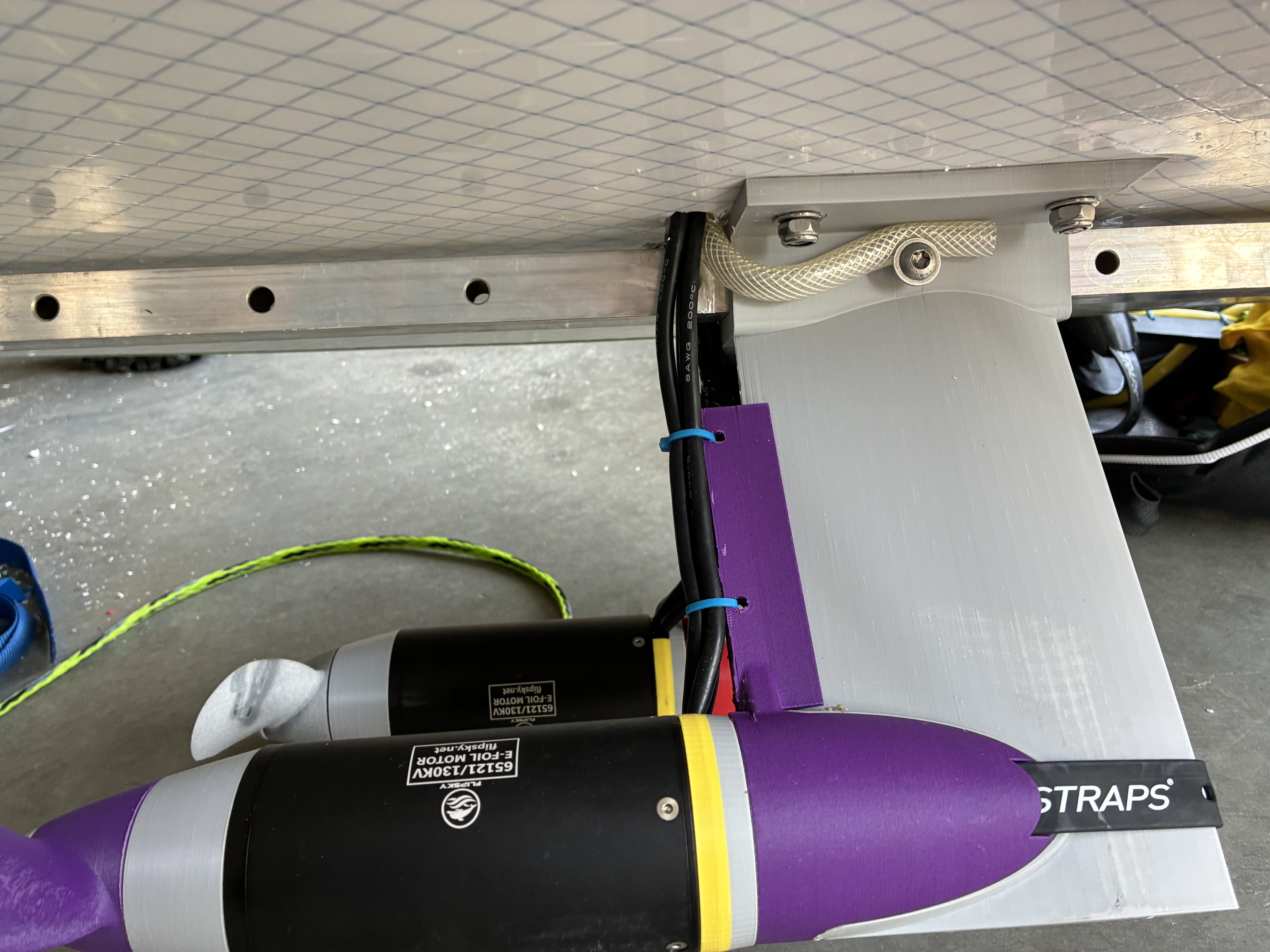

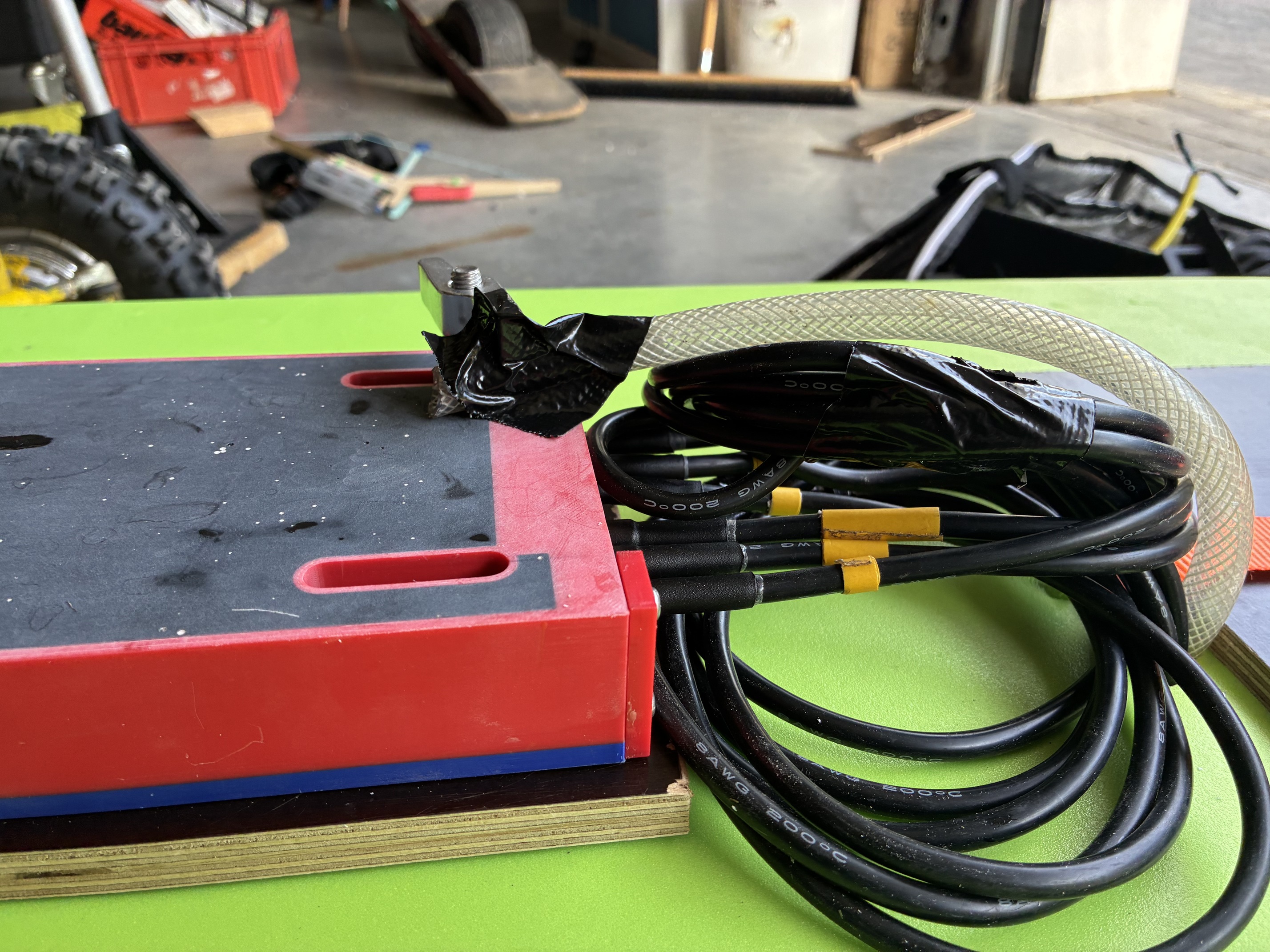

One thing I don’t like is that the motor cable does not swim, which is a bad feeling on a smal board (I could touch the propeller…).
Any ideas to make it swim and still look good?

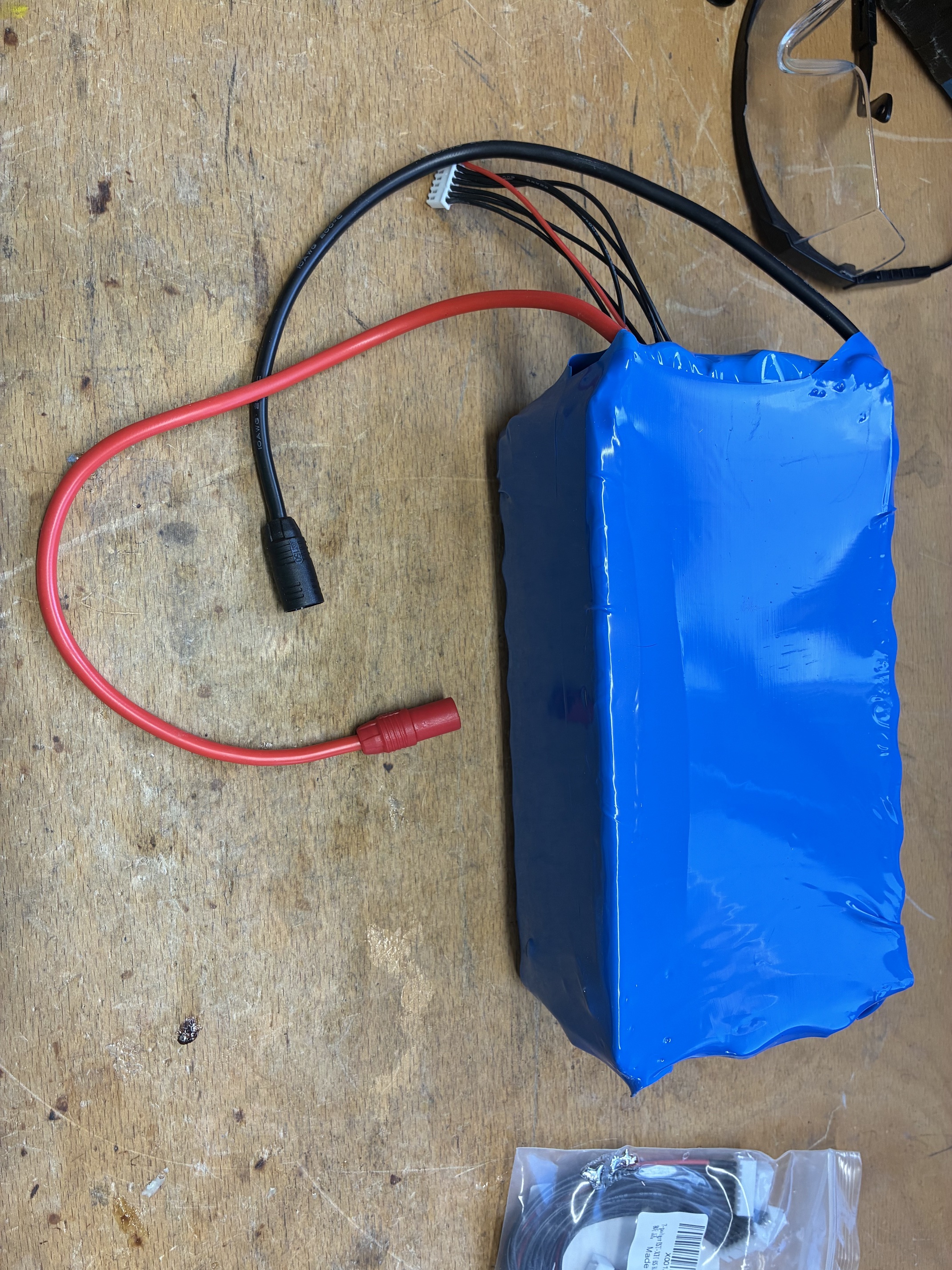

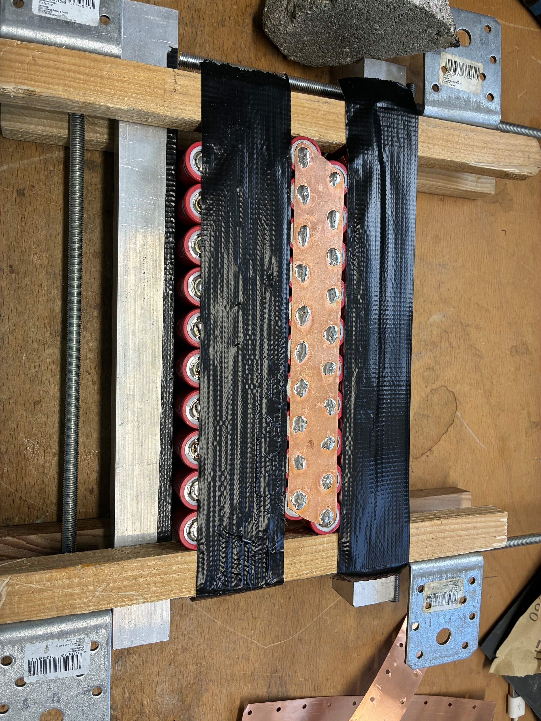

I usually solder my high amp batteries.
See:
I needed a new battery because I build a tow based on 65121. it pulls like a horse
what cells are you using and no BMS right?
Until now I used Samsung INR21700-50S, molicel, Tenpower INR21700-40TG. …
Never had any issues after soldering.
You need to use a high watt solder
OK nice thanks! What do you charge with, multi balance charger?
If I understand, you have only batteries in your Pelicase.
So which connectors do you use between the case and the ESC+receiver aft dedicated box ? Tks
I use a waterproof xt90

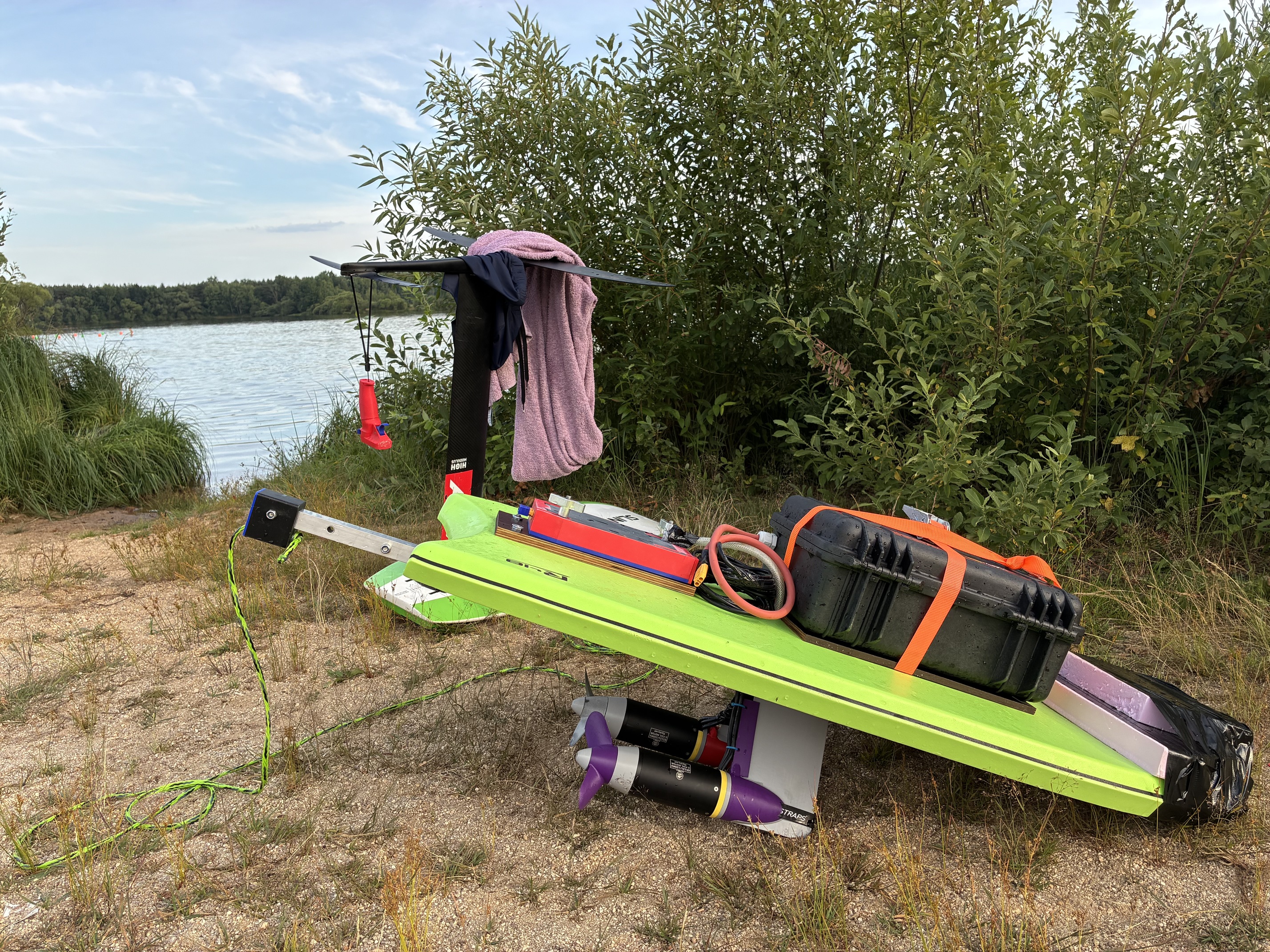

Today’s session with 840 spitfire on a 14 liter board. Also added water cooling:
BTW, I have to mention that the range of the bremote v2 is amazing. I configured rx and tx at 20db and can even start with the tx 20cm below the water. That’s handy for the 14 liter board on the tow…

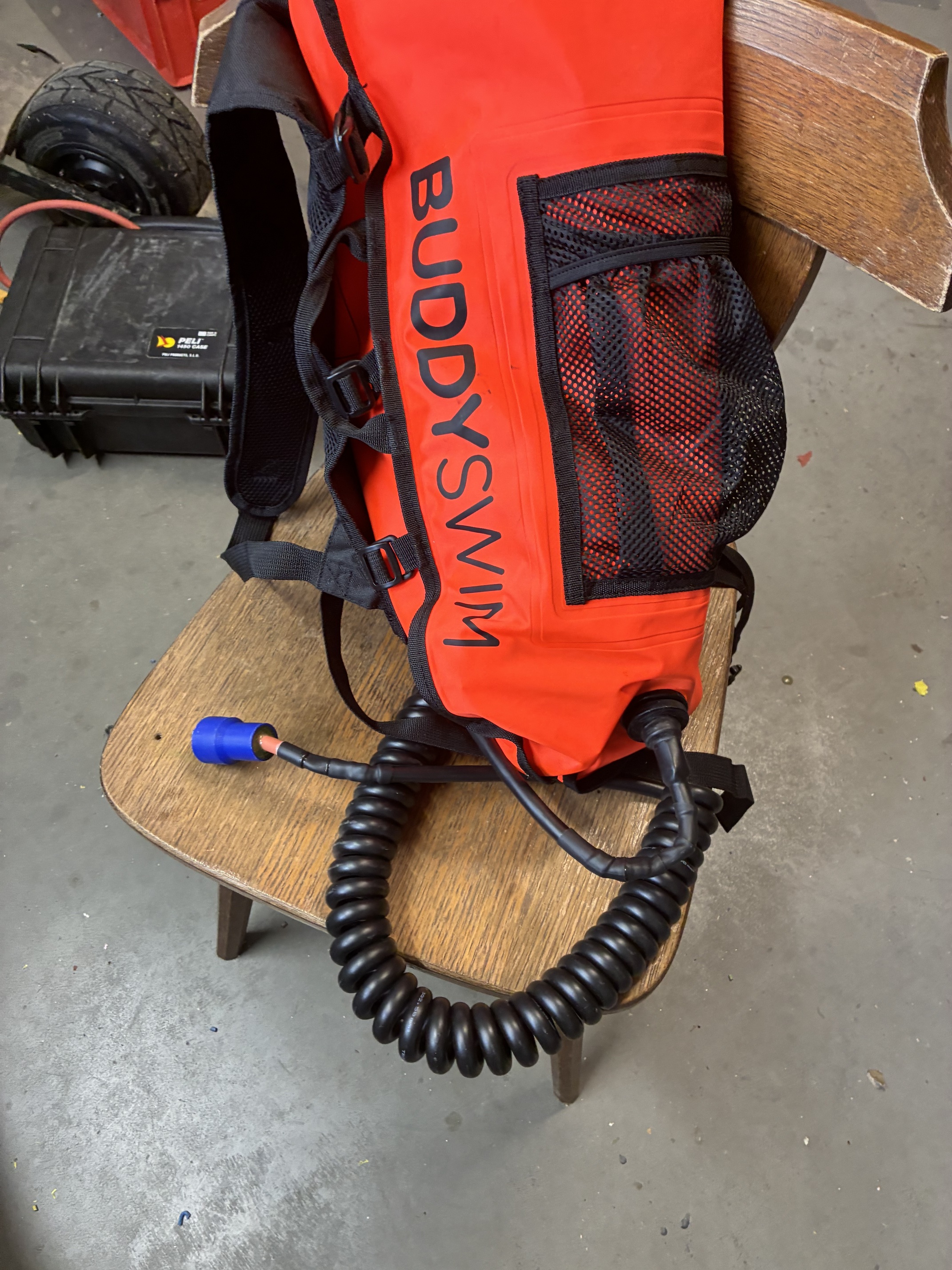

Cutted my cable at the backpack. Testing spiral cable now:
Too much stuff for a windy day…
What is the cross section of the wire, 11 awg?
It is 2,5mm2. My non spiral wire was 2,5 too
Yes, it is approximately 11 awg. And what is the length of the coiled cable, does it stretch well, does it not heat up and if possible, general impressions of use. Thanks.
2m stretched. Feels good when I stand on the board. Will test on the weekend
I have tested the spiral cable and like it.
I am using a cow hitch on the cable and connect it with a “kite knob” to the board (second cow hitch on the board).
You can easely move the cow hitch on the cable and adapt it to each board requirements. I am using the cable as the leash…

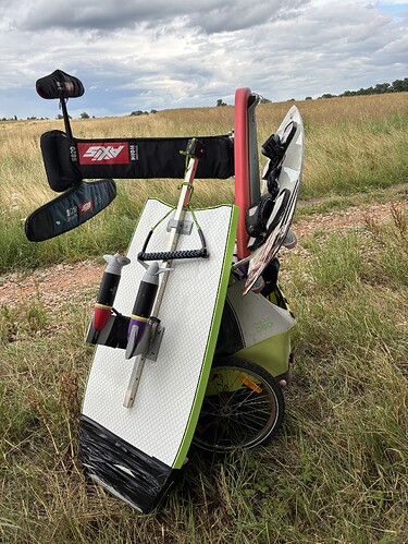

Just have this picture around:
