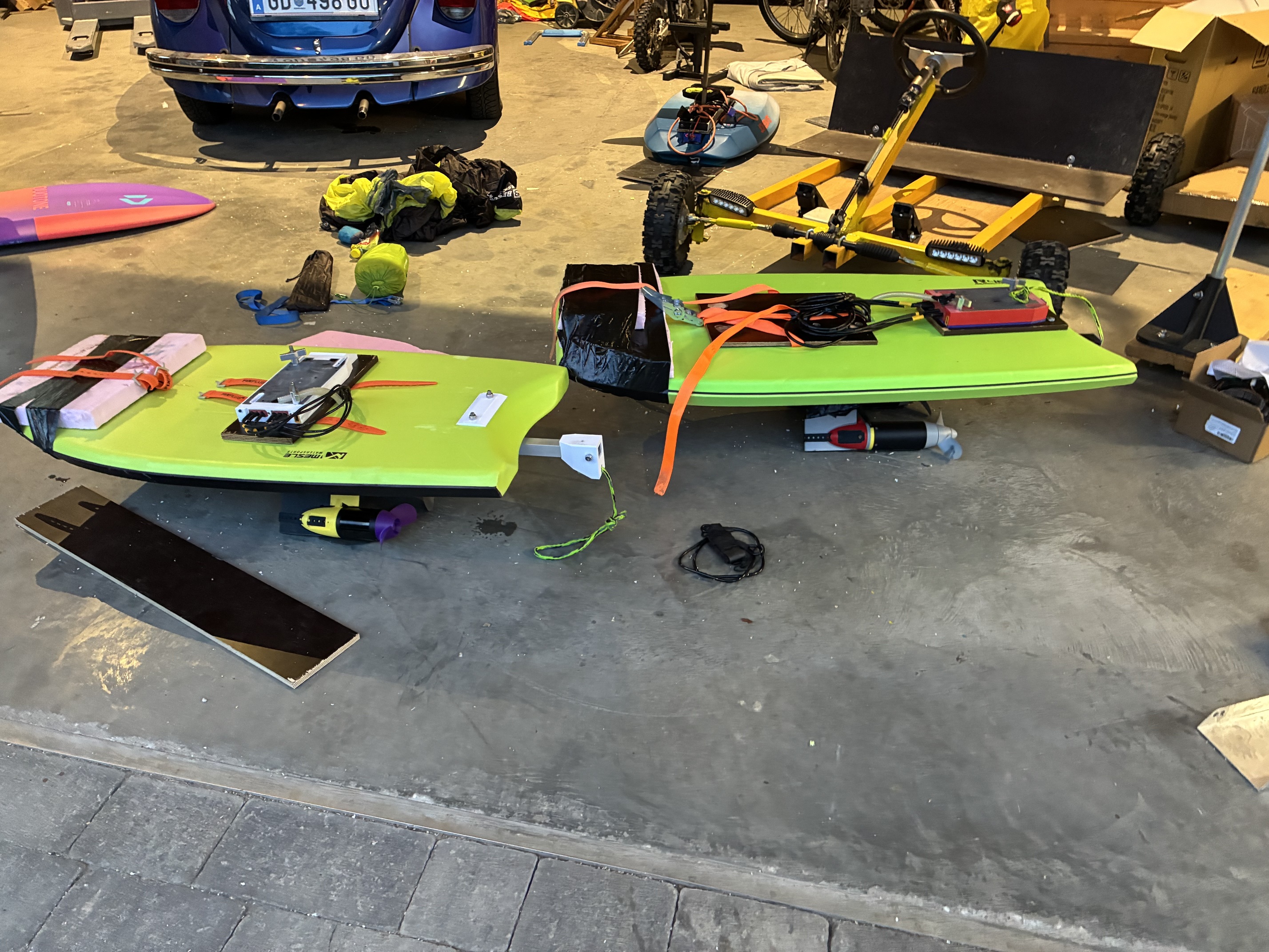

Got the high down to 28mm.
And build I little sister of the tow which is airline compatible.
I have now one week of testing in the waves and can switch between gen2, backpack and tow.
Going to be fun :slight_smile:

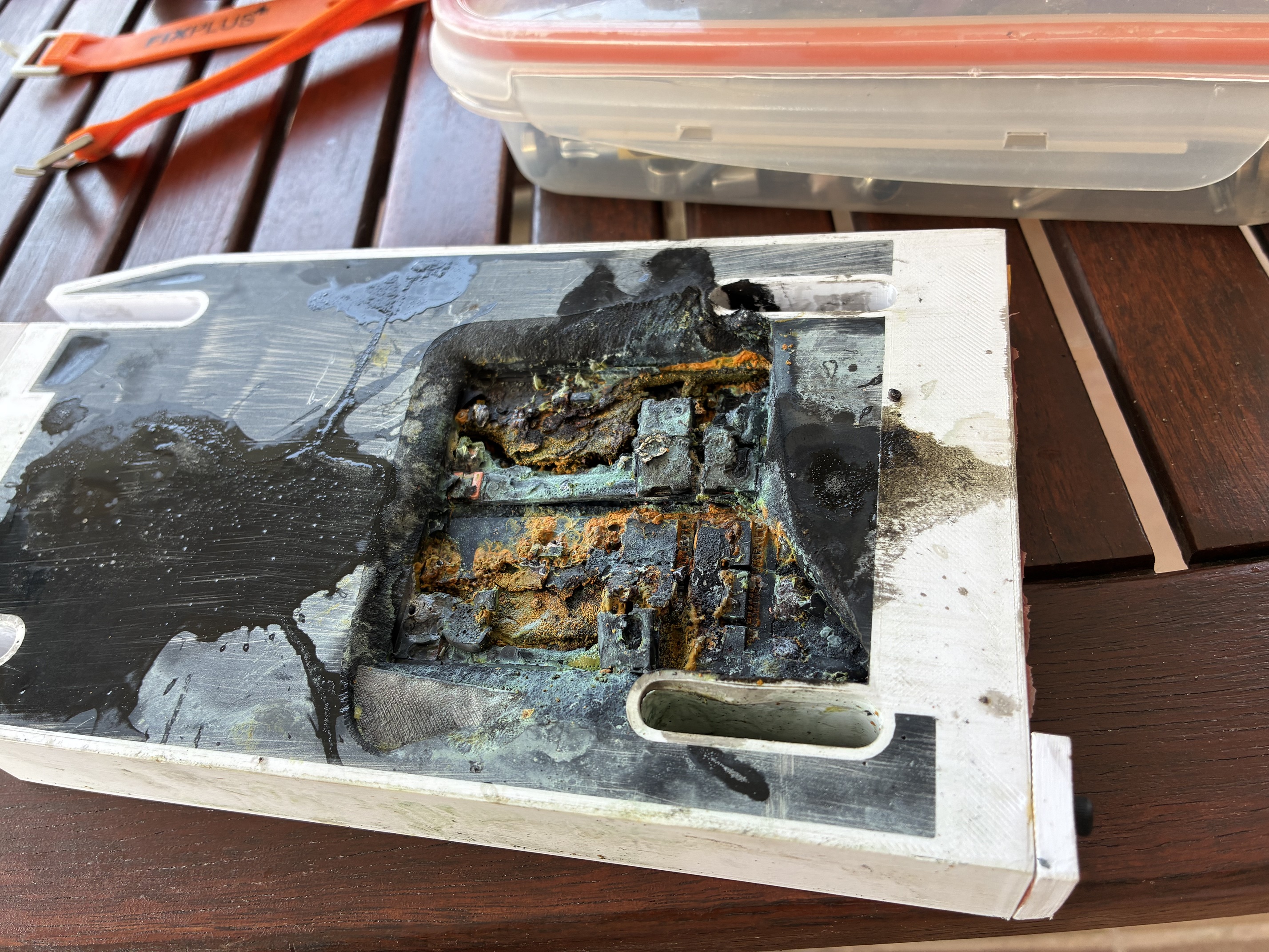

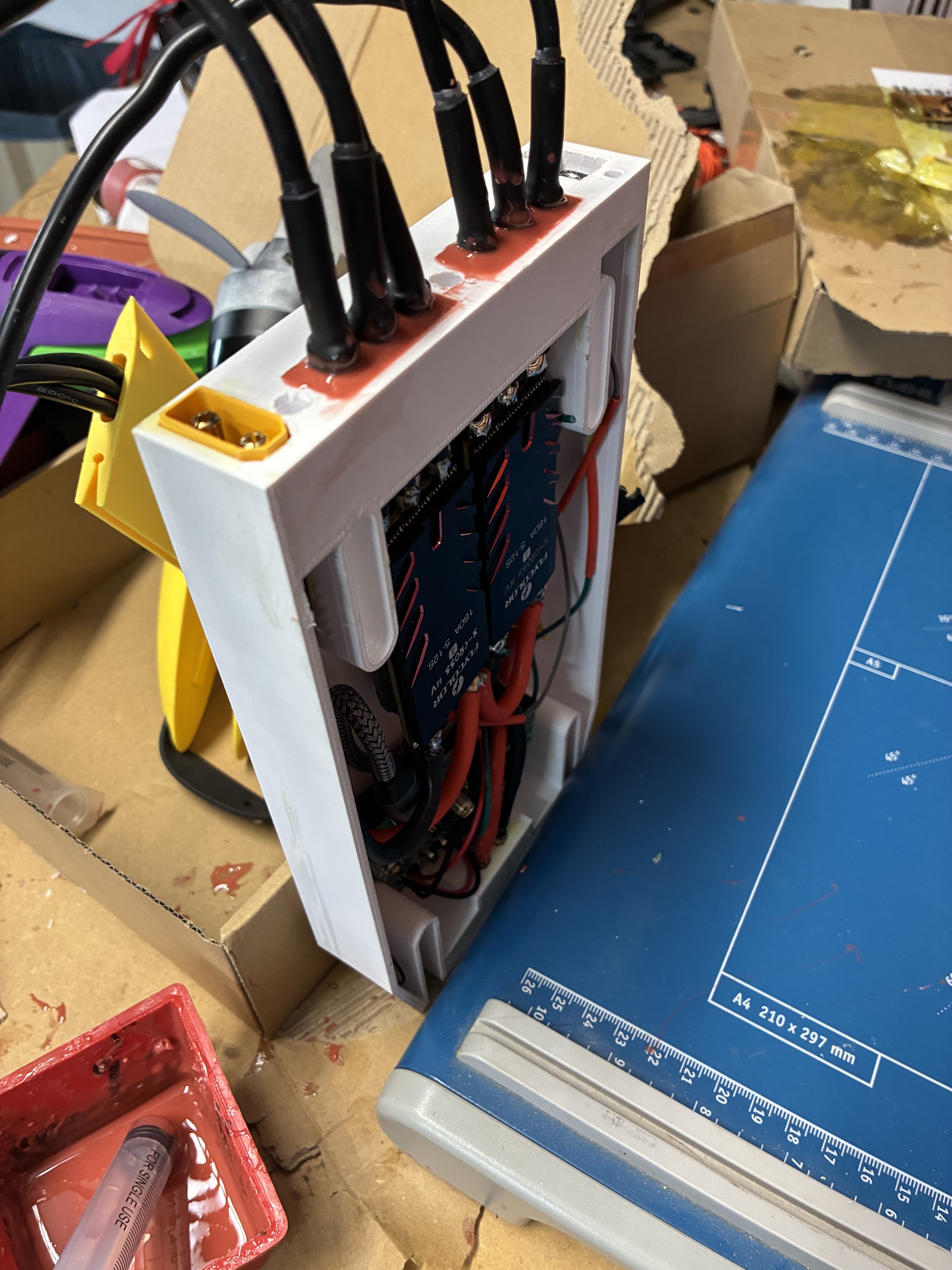

I had two great sessions in salt water and then this happened (in tow setup).
Unfortunately I have only this flycolor 160a based Controller with me. I had not really tested this one before at home. Therefore I am not sure what really caused the issue.
I would appreciate some ideas!?
  • heat issue?
  • shortcut at the motor plugs ( salt water)?
  • flycolor just not reliable?
I have used the same setup a lot with two SQESC 12200 (20 sessions in fresh water) without any issue.
I would like to find out if it was a salt water based issue. I don’t want to run in the same problem at my next vacation!
Bzw, if anyone is in Mallorca and had has some gear here please met me know :slight_smile:
Did it just stop? No detached motor cables when you left the water? If they potentially disconnected at full throttle was my question.
I’d guess that heat cracked the epoxy and then water got in.
The 12200 seems more robust and has better cooling if I remember from seeing in another thread.
It exploded/burned when I was pumping in the waves and riding the tow next to me. So, it had not much load, but fast running and „ oscillating“ motors.
Any feedback is welcome!
Sorry to hear about the failure. Do this ESC feature temp protection? Did you have the ESC alu plate with some sort of external heat sink?
It is strange that both ESC exploded. I would have to agree with @Jezza
I dont see any ESC cooling ribs on the pics prior to potting the unit, so based on that I support Jezza’s theory on overheating, but you know your stuff so I assume you already tested and measured temp rise?
I also tried this cable, it is extremely heavy and massively strong, I take the load off cable glands with some rope to the cable from the bag. The coil is great as it prevents shock loading, but I will try a thinner version, maybe 1.5mm as this one has too much weight for the need (I find on backpack I only need 60% throttle on 12S 6384).
Thanks for the feedback. I thing @Jezza is right.
This will not happen to me again…

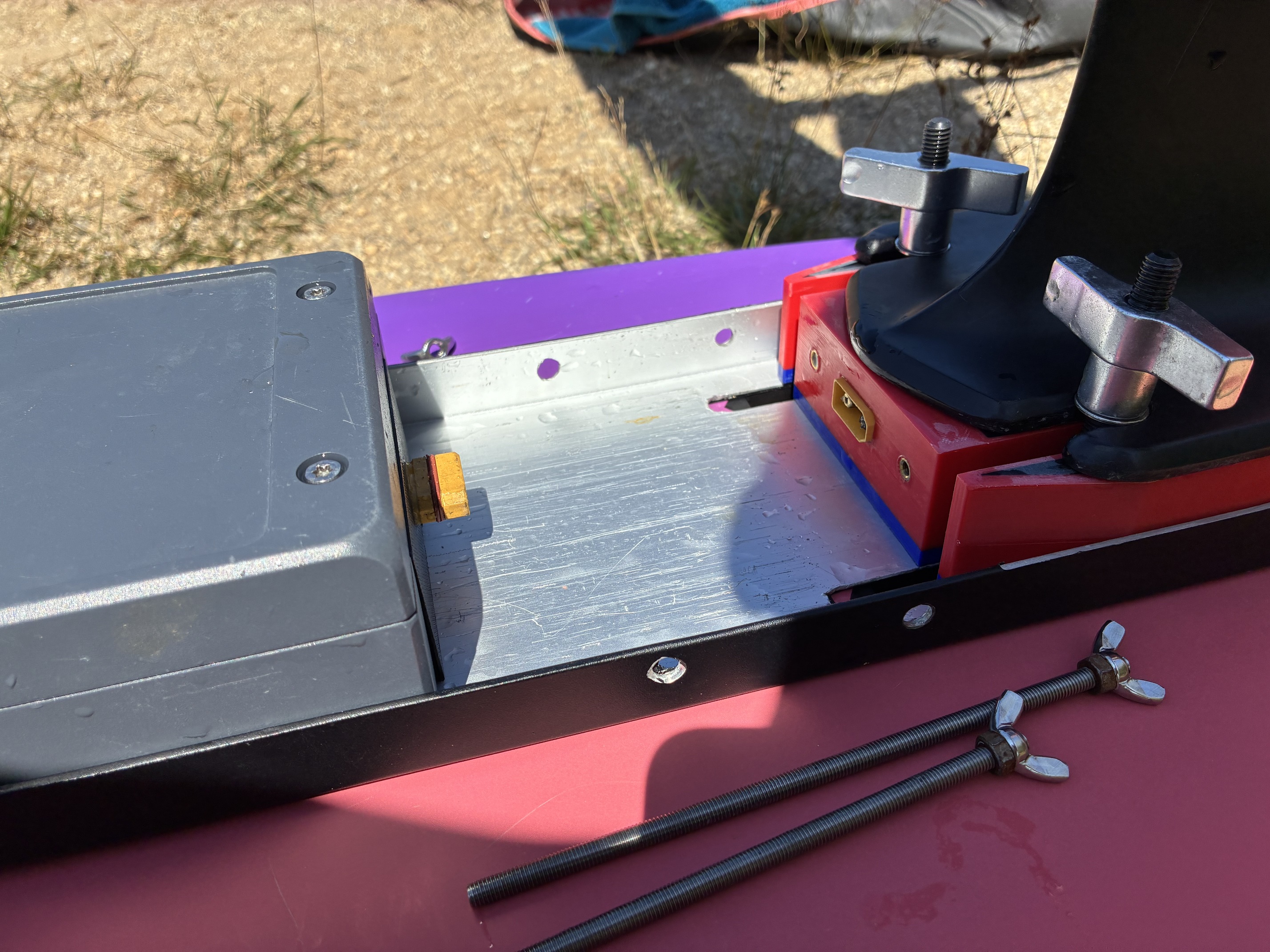

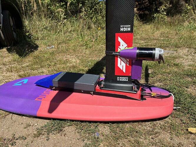

I tested a different motor mount today on my smallest board (90cm). See pics:
Unknown-4
Starting this setup was different as the motor pulls the board down and took me some time to figure it out. But once up it felt OK and pumping was OK too.
But still just half kids safe.
A jet/impeller based solution would be the best.
Maybe something between mast and board!?
Would be great to hear some ideas from from this great community!?
