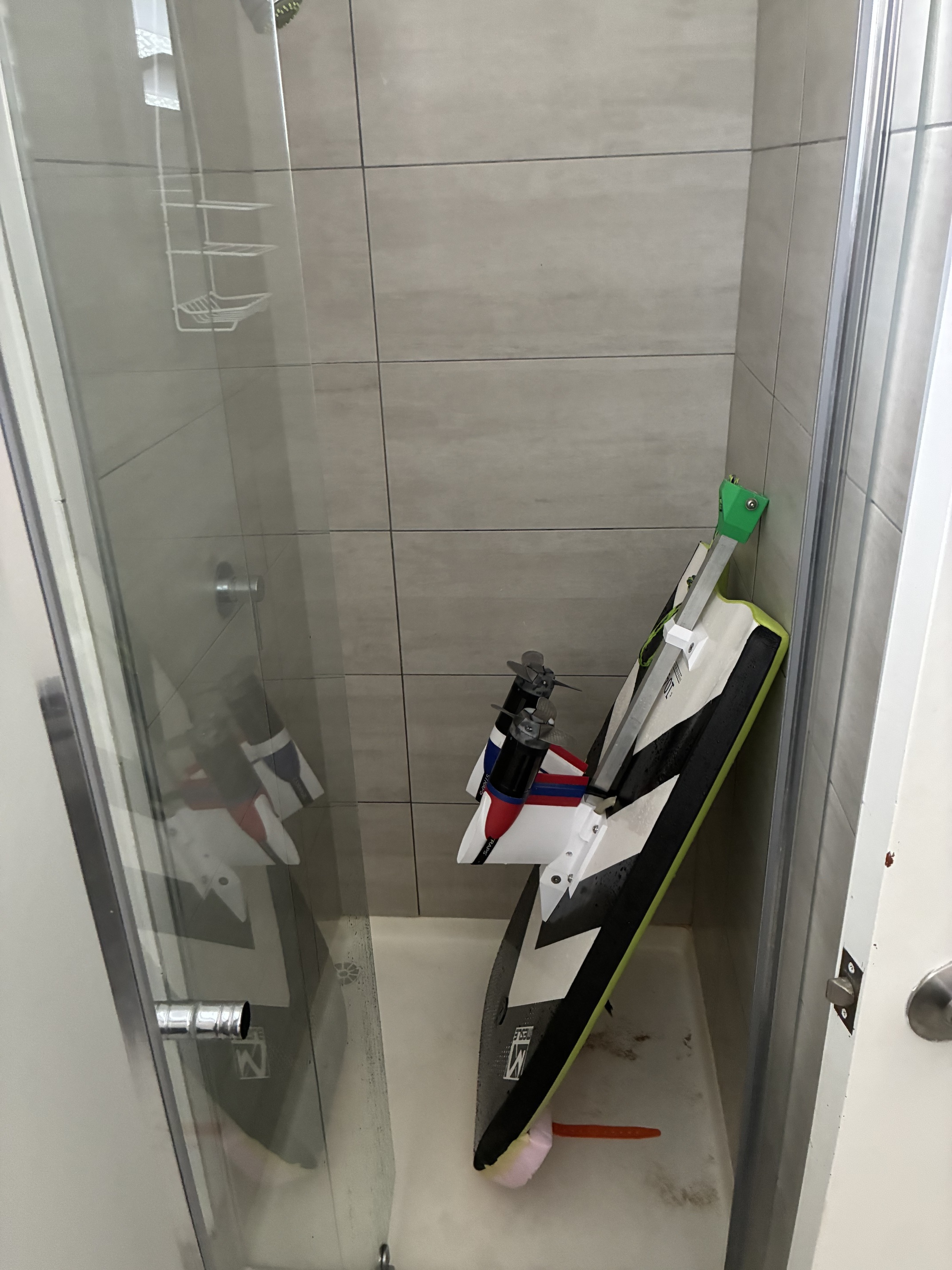

Had one week of great fun around Melbourne.
Most of the time on tow sometimes on backpack.
Thanks to Jonathan for his guidance!!
Everything works without any issue yet.
Next week Noosa Heads :-).

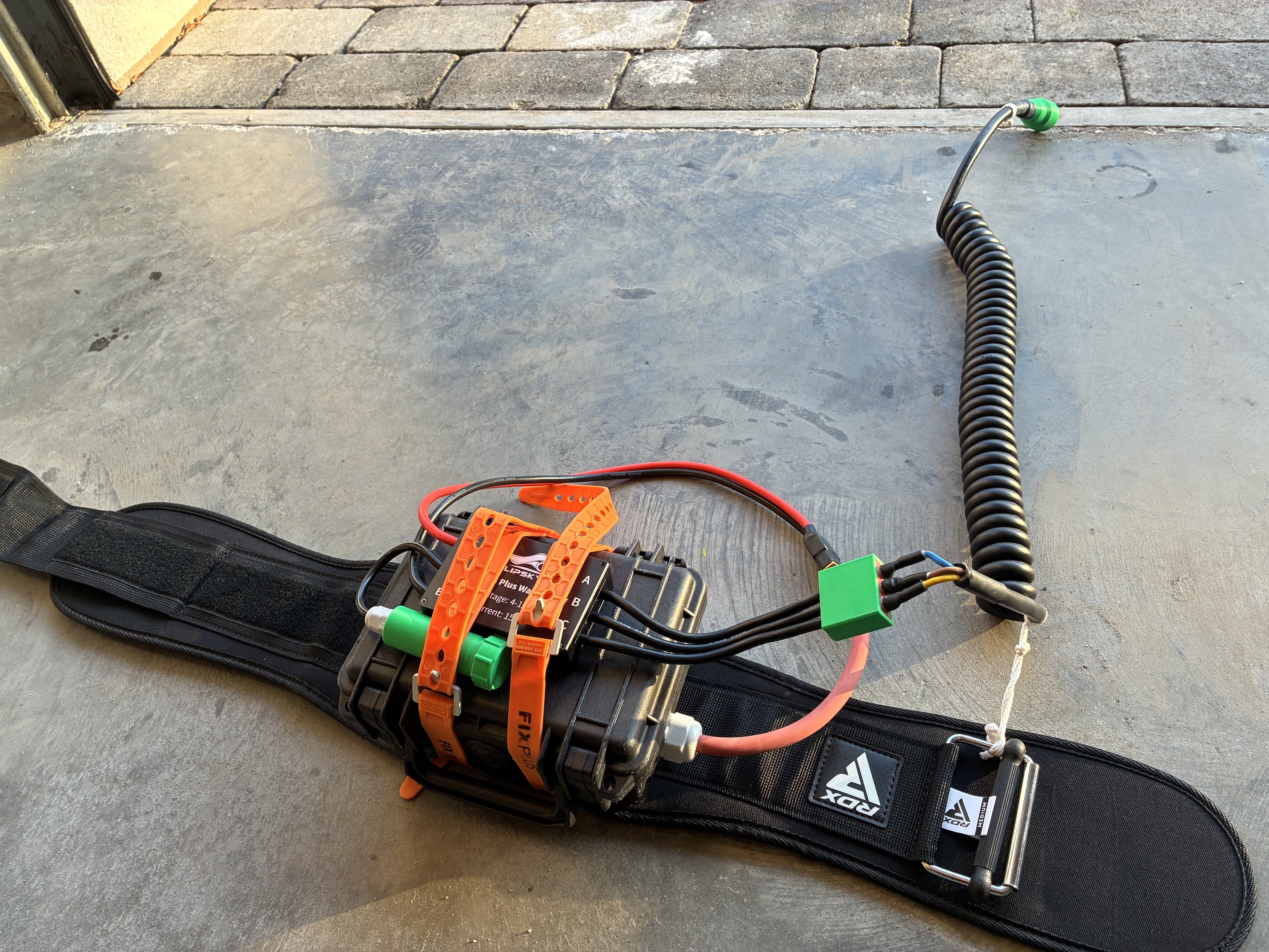

Will test this most simple waist assist as soon as our lakes are free of ice:
I used the following:
https://www.amazon.de/gp/aw/d/B08V5L57Y7?psc=1&ref=ppx_pop_mob_b_asin_image
It could be a bit thicker. Let me know if you know a better belt!

Clean Setup. Nice Plugs :call_me_hand:
Wow! Your builds look awesome. I have a few questions for you if you don’t mind.
I’m planning to use a Pelican case on a waistbelt in saltwater. At one point you potted battery packs in epoxy. In another post you used plastic bags for extra waterproofing. Which method do you prefer? Did you have any issues with waterproofing when you were in saltwater in Australia?
Have you had any overheating issues with putting a (12s4p?) battery pack in the pelican case?
Are you still using these cells? (Samsung INR21700-50S, molicel, Tenpower INR21700-40TG)
Are you using a 6384 motor? 150amps max burst?
Thanks for sharing your builds! I’ve learned a lot from reading your posts already.
