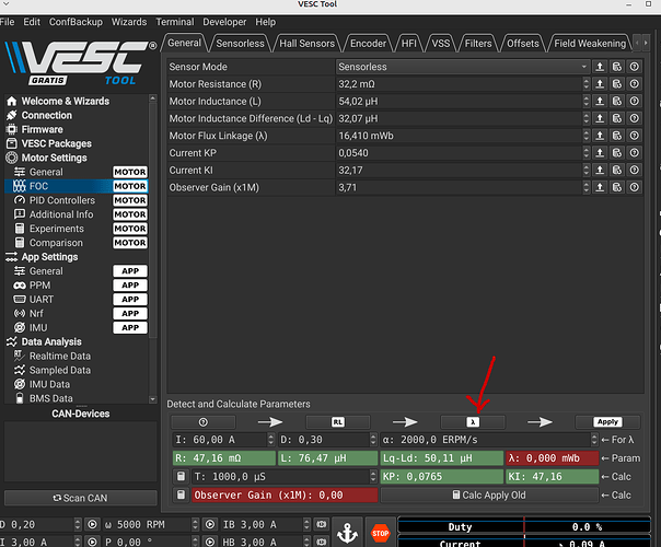

When clicking here the motor turn but nothing fill the field and the data remain to 0 and red
in fact, i’ve seen the same message and then impossible to reconnect the software to the VESC without reboot the computer. I just tried under windows and it is still the same problem but i can reconnect without reboot the computer. This is the only difference observed

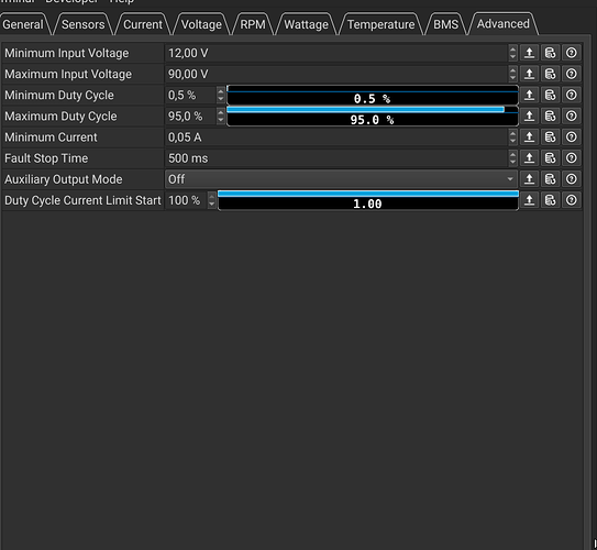

I’m not sure in advanced if it is ok:
Cutoff start is when it starts to limit, so dont set it to 4.2V per cell, rather to 3.2V per cell and the cutoff end to 3.0V like you already did
So set 38,4V and 37,0V for start and end
Advanced looks OK
