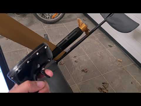

Hi guys, I have a problem with setting the VESC program for the Fkipsky 65161 100kv motor, the controller is Flipsky FSESC 200A 60V ESC, battery 12S lipo 22Ah. When setting the BLDC engine, the engine is restless and noisy at low speeds, when changing to FOC it is calmer, but it does not turn immediately - I have to give more throttle. (I shot everything in the video below) Please advise what’s wrong
So I changed the settings and did the firmware and it’s OK.
