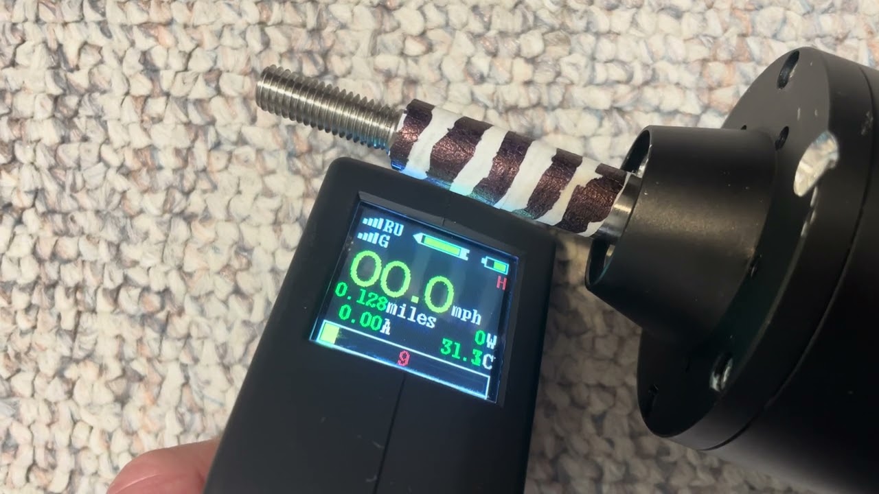

Hi. I have a problem:
When I press my remote from 0% to 9%, the FSESC always reads 0%, no matter if the mode is PPM or UART. The throttle is dead from 0-9%.
When I press a value of 10% or higher on the remote, then the FSESC jumps to that value.
I tried to start the wizard again, and tried to change Input Deadband, but no results.
FW Version: 1.7
Please help.

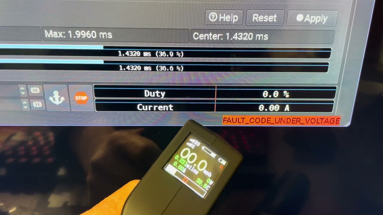

When connect to vesc configurator, you dont see the first 10 percent input on their either? Im guessing it is seeing it just motor is not spinning til 10% because it hasnt received enough current yet
I see this in the VESC Tool. At 0%-9% it reads 1.0020 ms in PPM mode. And at 10% it jumps to 1.2120 ms. You can see this on another video
Not sure if this was mentioned before but think you can recalibrate the on the remote itself then recalibrate on Vesc app. If not fixed you can try manual adjusting the min input to 12000ms on app
Both remotes are calibrated.
I adjusted the min input to 1.200 ms already, and I lose the first 10% of the lever movement. It is like a dead zone now. Not good.
