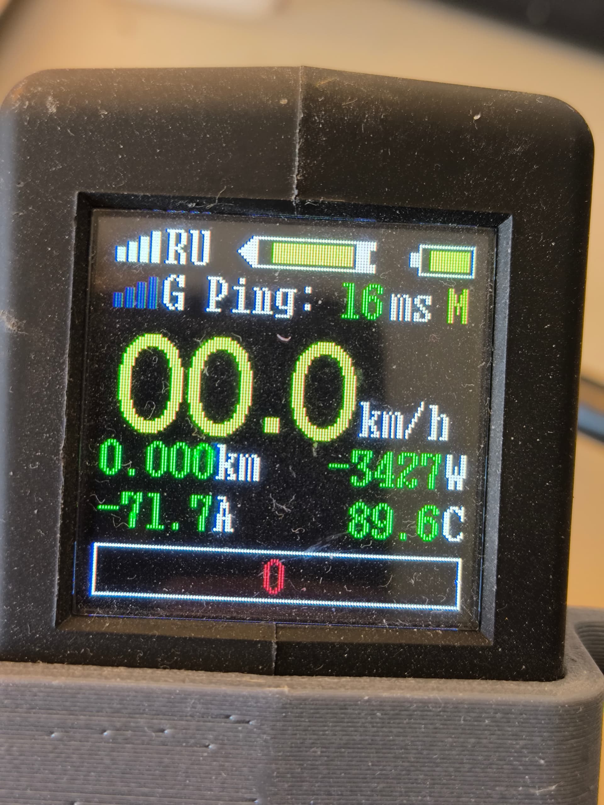

VX3 pro strange on screen info suddenly added to the screen with the same setup.

Looks like some vesc data, though my setup is esc.
Everything works, but there is that extra “telemetry”
When I run my VX3 through UART that what I normally see. Do you normally not see temp and power with your esc setup? (Also your esc looks a bit hot if that’s real haha)
I use simple 12200 esc. Of course I don’t have any telemetry aside voltage.
And suddenly showed up that corrupted telemetry that I don’t need here…
You use uart with vesc probably, right?
Yes, with a vesc all that data just comes right over (when you plug in the uart cable to the vesc). But honestly hard to see it all on the vx3. Temperature of esc can be good to have just to know it isn’t too hot. Power/current are not that interesting and I prefer to check the log afterwards
I’ve seen that before with a vx3 when I had water in the control box, moments later I lost all coms and I was swimming home. Check to make sure it’s all dry in there.
I think what happens is that the tx or rx in the uart goes high and then things go haywire.
With UART mode I also get this basically all the fields work but in PPM mode you only get the speed, mileage and battery. I like to have all the data I can, because why not so I use UART. The power indication is really useful it shows you how efficient you are if you want to maximize your battery and you are far away that’s useful.
Agree, I love the power measurement to the remote. The whole time I’m doing maths to see how far I could go at the current speed based on the capacity of the battery.
The receiver pcb was pressed with a tape, as soon as I released it, the abnormal telemetry disappeared…
