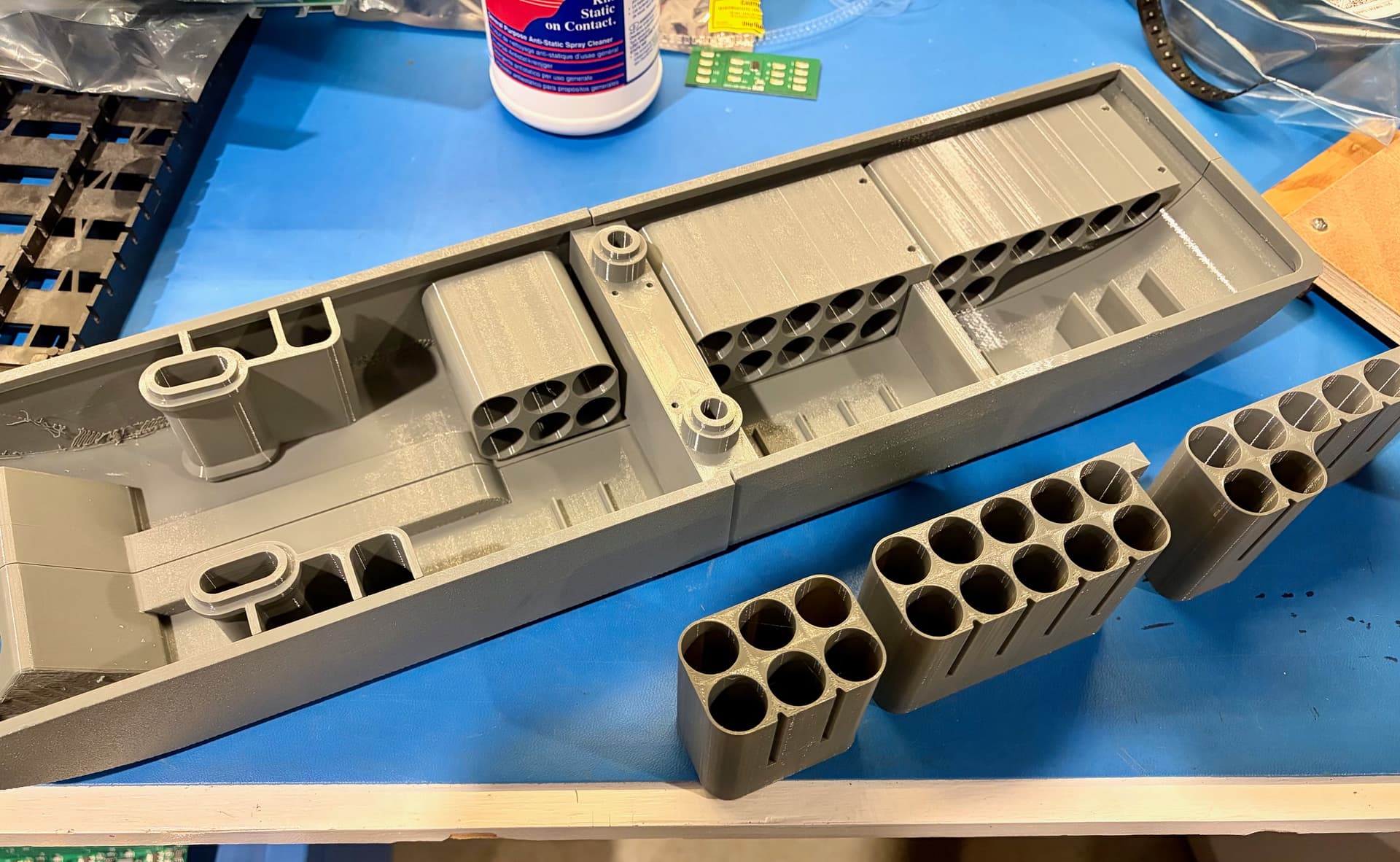

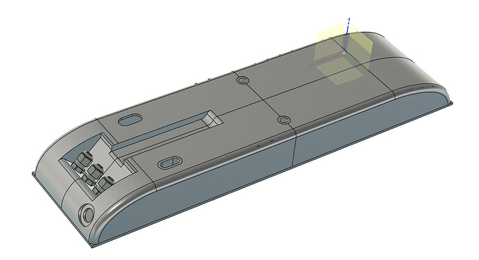

I’m building one right now… I’m using 3D printed plastic as the form, then I’m going to glass over the print and add an aluminum plate for heatsinking and rigidity.
The whole thing will get epoxied together. No screws, no access, the whole thing will be one waterproof unit.
Will it work?
Not sure yet.

Wow thats sick!
Any chance youd be interested in sharing that file?
What 3d printing material do you use? Not an easy shape to laminate over. 3mm radius insted of sharp edges helps, even when you put the part in a vacuum bag. I made some over laminated parts from asa. Maybe you could glue parts from 3mm solid carbon boards to the side to support the compression load between mast and board. Or use carbon tubes instead of 3d print as spacing sleeves around the mast screws.
Once I’ve validated the design a bit more I’ll share the file… It’s in Fusion.
The material right now is PETG which if sanded will take epoxy and glass OK… but I might print the end version in Polycarbonate. The existing prints will be used for a structural test and a frame to construct the battery.
I like your idea of carbon spacing sleeves… right now I’m hopeful that the supports will be OK since they’re always in compression once the mast screws are tight.
I used carbon tubes as supports when I printed a PETG front foil and that worked OK… I should see if I have anything left over.
