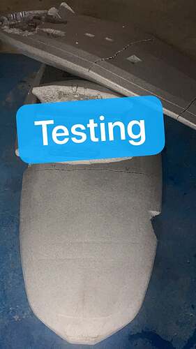

A Waydoo Rep on the Facebook Kickstarter backer’s group reports that they used some of their prototype castings on some of the first boards that were distributed and these castings have since been redesigned to increase strength and will be replace for those who experience a failure within one year.

I am in all of the owners groups and none of them have had problems like Waydoo. Fliteboard also uses aluminum but they have NEVER had a single bent mast. Not one. The Waydoo backers group has AT LEAST 6 bent masts and they only started receiving boards a month ago.
Do you also condone the way they lied about reinforcing the fuselage? When the first fuselage broke they promised they would reinforce them before backer boards shipped, but now many backers have had their fuselage snap for no reason:
Clearly it was not reinforced as Waydoo promised. Speed is not what Waydoo promised. Battery life is not what Waydoo promised. Quality control is a disaster. No one can register their Waydoo because they don’t have proper paperwork. Distributors have no parts for warranty service. When will you realize this is a company full of liars?

The issues shown are not ”early prototype” issues…
If you can’t cut a thread properly or are so eager to ship that you let the customer handle it then you’re a pretty poor company.
If you can’t design a mast that does not bend in ordinary use then you obviously didn’t do any verification or, again you disregarded it then you’re a shitty company.
