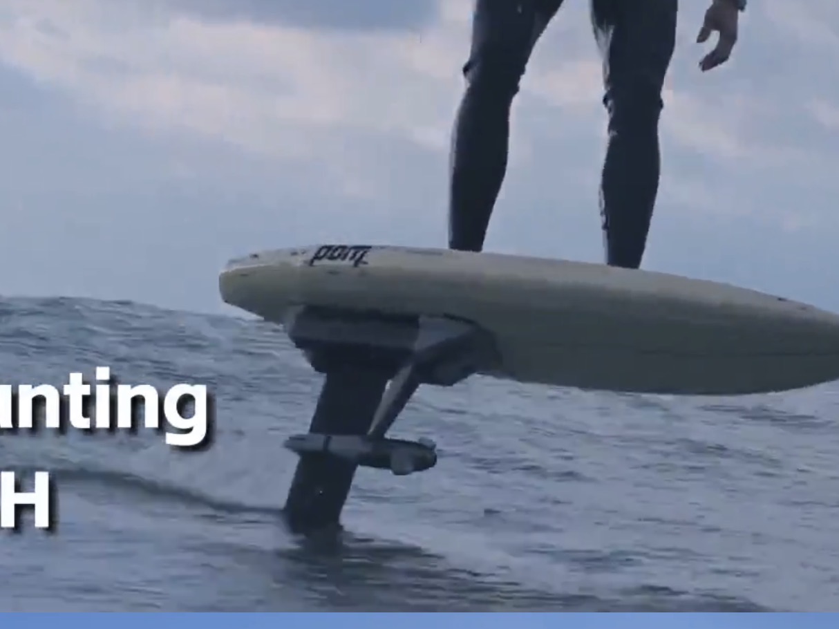

Don’t see the point of the pull direction though.
Prop wouldn’t fold in that orientation and I’m not sure how this would be better than traditional push mode. I would think that wave riding would involve some riding in disturbed water no matter what.
The complete contraption looks like so much drag, it is crazy. Not sure what they are thinking.
Especially now that many even use trench boards for foil drive.
But I can see upsides in the pull direction.
You have better undisturbed flow at the prop.
And it would probably completely eliminate the tilting effect, with the nose of the board coming up.
You also have the weight of the motor near the center of gravity for a more balanced system.
all sure this is real? on foto’s seagull it is pushing (motor at back) foto foilguy it is pulling… same system/company ??
i also see 2 different systems online even in 1 print :smiley: maybe made by AI
or maybe possible in 2 directions ?? :smiley:
yes 2 ways possible top (looked at youtube film now)

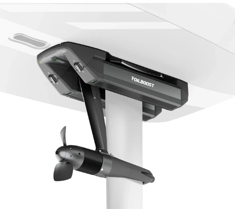

Looks like it will create a lot of drag when entering the water, step back even from FD gen 2 max in that regeard
It looks kind of big.
It really looks like no effort was made to smooth out the shape, so boxy! There were images of this product about a year ago and seems they didn’t do much to it.

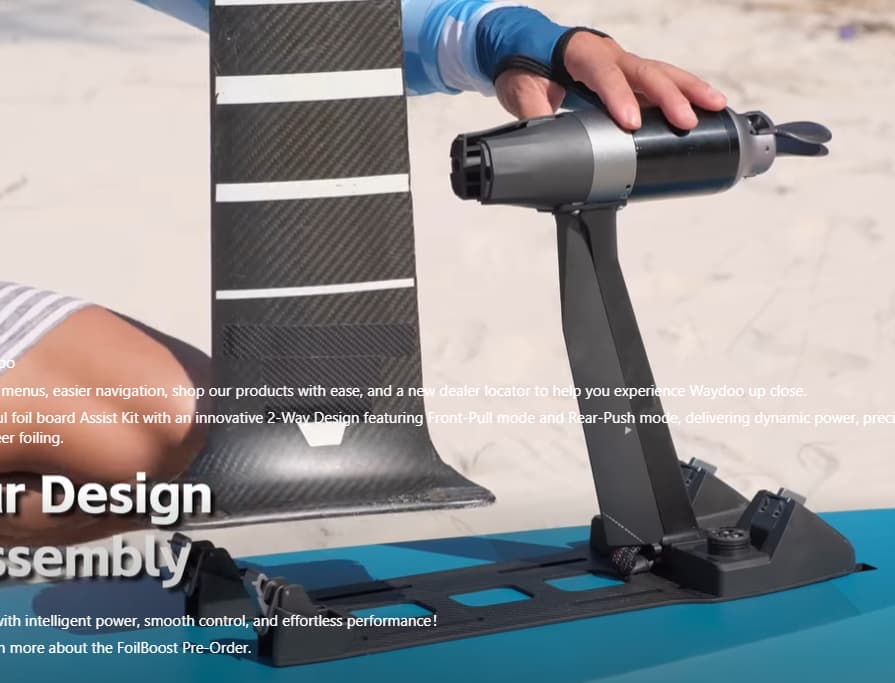

A friend could finally get this foilboost and we tested it for several days now… works perfect. Thrust is more than needed and as assist it gives you about 50 take offs with enough power to get foiling and then go with the wing at low windspeeds :smiling_face_with_three_hearts:
Riding in efoilsetup (motor down near fuselage) with Axis 1050 png wing & 78kg is about 45 minutes which is quite amazing for such a small unit with less than 5kg weight… Feeling is about the same as Foildrive max with slim battery… Big advantage mastplate is connected directly to the board, no batterybox in between which feels a bit more stiffer in overall handling…
Give it a try and test it… there`s nothing comparable in this price range of 2500€ net. In my opinion it will take over efoilmarket… If you ride like a pro then you definately want to get rid of the heavy efoils and prefer the super light foilboards with an assist system!
