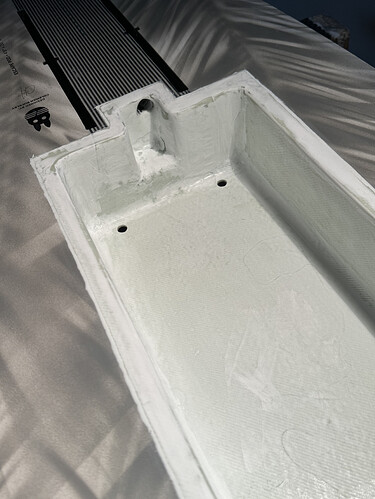

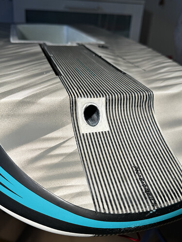

Bopla cave successfully completed.
In the last few days I have inserted the CF tube into the board and laminated it.
Then I filled it twice and sanded it.
Finally, the cave was painted.
I applied a ConceptX deck pad to the top of the board.
At a later date I might glue a frame or spoiler onto the board.
The box has a 4mm overhang to the underwater hull.
But first I want to see the transition during the first trips to see if there are any cracks.
Now it can finally be finished.
