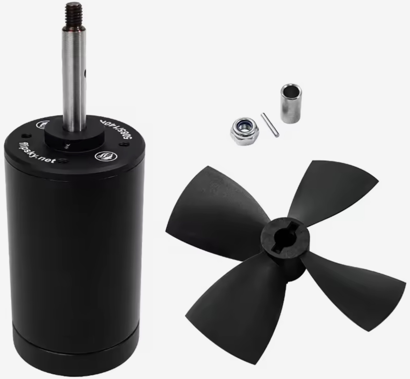

My 63100 reached end of life. RIP
I‘ll test the 5085
Any suggestions for a good prop? That one looks so flimsy.
I would advise you to use a scaled Volker propeller )))
I’m afraid that’s what it will come down to.

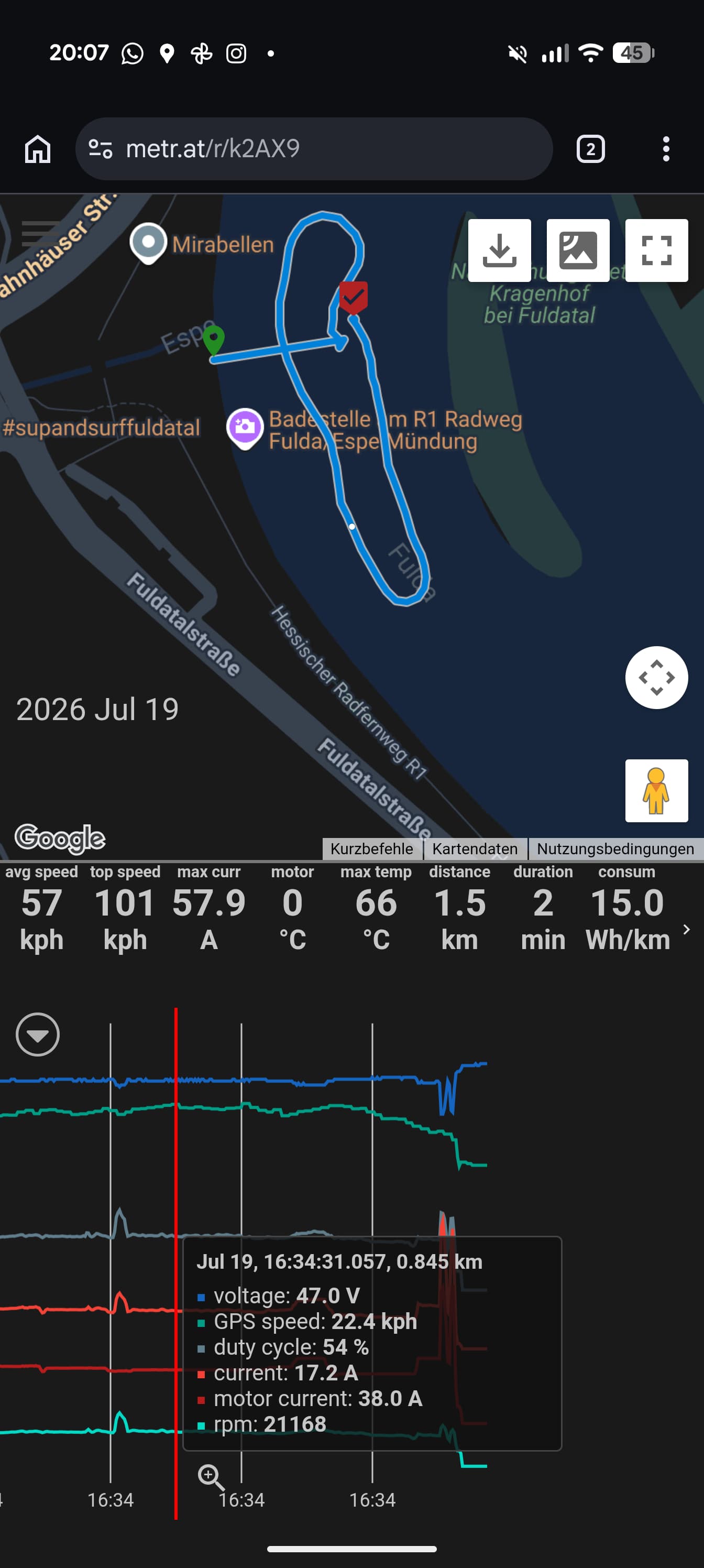

Works flawless
800-850W at 21-22km/h.
(ignore speed and consumption. Based on calculated Speed, but wrong settings for Transmission in Vesc)

It might provide a Usefull alternative, for a surf oriented efoil it probably is less dragy
Definitivly less drag. Motor performs really well, is sealed and potted properly. But the bearings are Low Performer. 8h, No salt and ready for the dumpster.
Back one for replacement: SS608 2RS
Front (two piece) SS688 2RS
Once we find a folding prop for this motor it could be a very good choice for a low drag efoil :+1:
5085 works like a charme. Even though its on pinky atm.
Only downside: Outrunners are always Kinds noisy

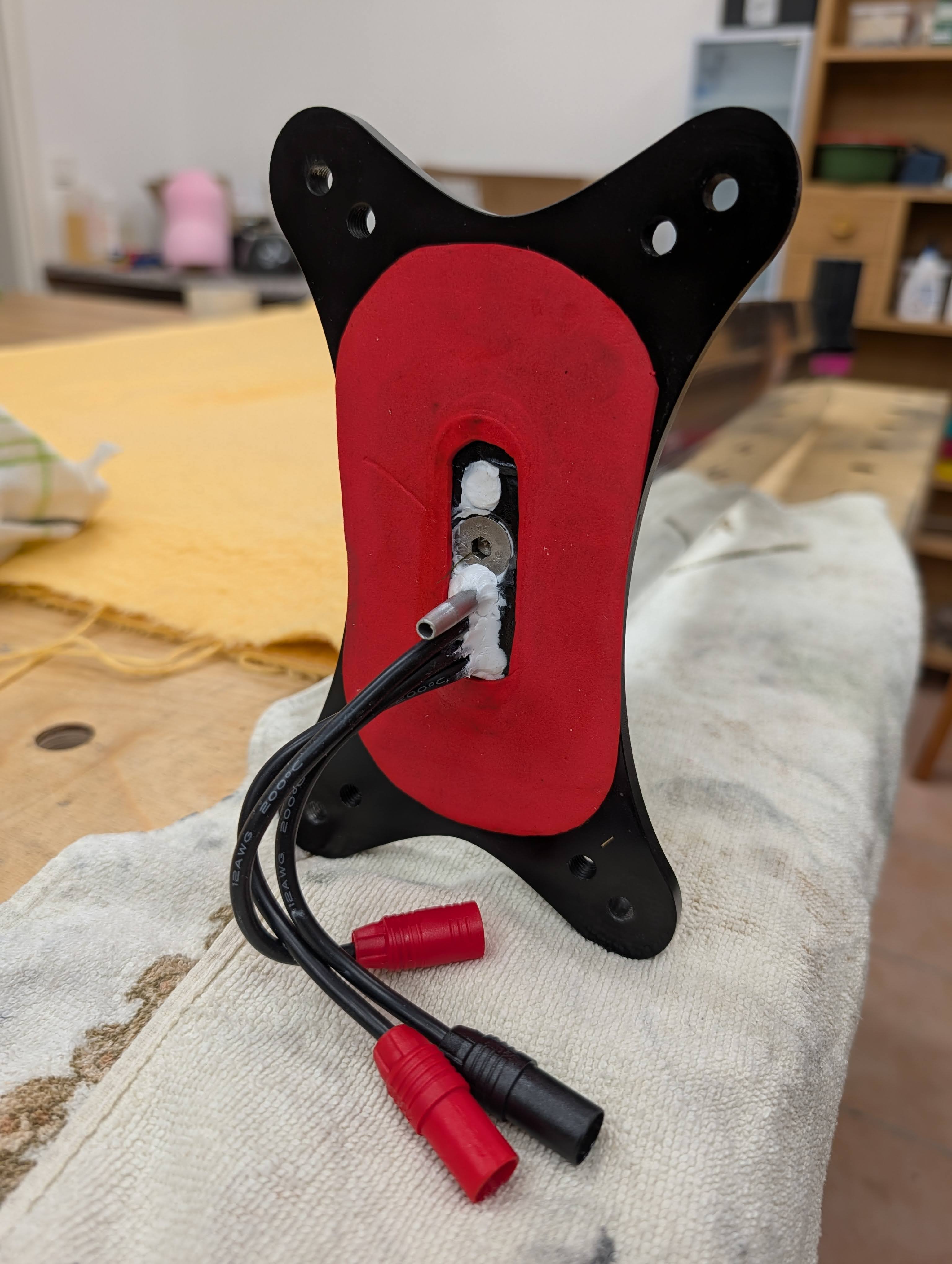

I am thinking about starting a project like yours, but can you show some details about the conection, and waterproofing off the mast/ bottom of the board please ? I am not to sure about how to proceed for this part.
Board: a small oval hole
Mast:
The red stuff is 2mm foam rubber
