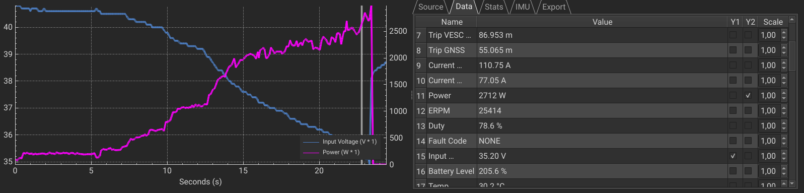

I had a few days ago my second test I had much more success than the first one.I tested with a few friends and we managed to get on foil a few times.

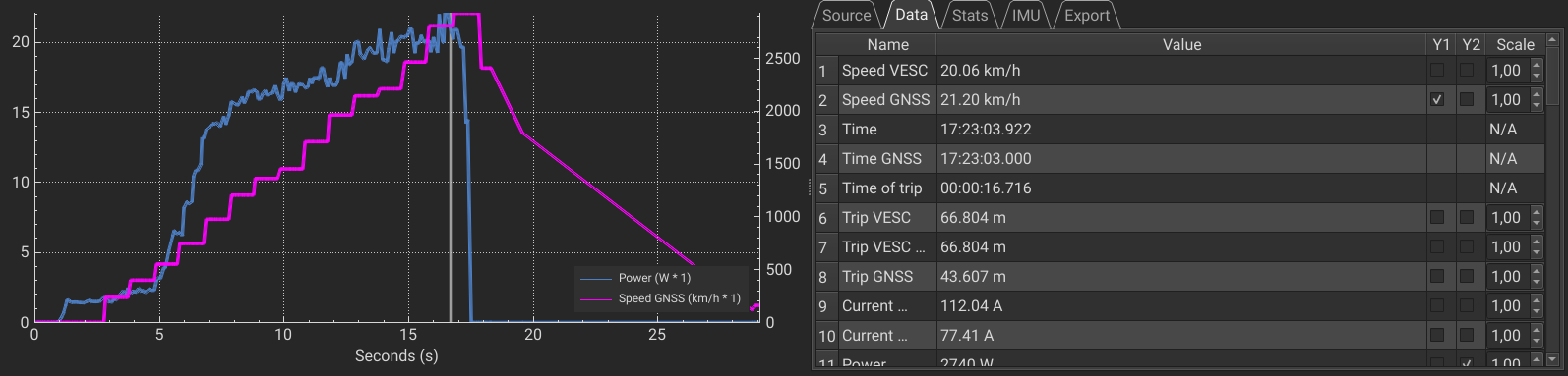

I am kind of surprised how inefficient the flipsky flodable prop for the 6385 is, with a 85 kg rider and an xover v3 xxl setup 2900 w on foil. It is while still accelerating and so on, but at this speed the foil should be around 600 w at the most
On other notes i had a recursive ABS_OVER_CURRENT which usually ended with the rider falling down. i am not 100% sure if this is due to battery amps or motor amps, any help would be appreciated!
The biggest problem and the reason why the test got expensive at the end is what I still do not understand. At some point, without further warning the foil stopped working, an i got a MOSFET blown, same as when the cable got cut on the first test. Only this time, no cable was cut, the only thing it happened is that the BMS cutted the power since i had both the BMS and the VESC cut-off at 36 volts (3v per cell).
I think it is unlikely that a BMS cut can kill the ESC, what do you think? this happened under load… (2700-2900W)
i still have to check if there might be any shorts in my motor cables, which i think is very unlikely…
and regarding cut-offs, i am thinking about starting the VESC cut-off at 3v per cell, and ending it at something like 2.6-2.7v and the BMS cut-off at 2.5v. ludwig_bre recommends 3v startand 2.5v end.

Cutting power under load is a no-no and probably one of the easier ways to fry a mosfet.
What is the purpose of your BMS anyway?
Oh yes a BMS cut can kill a VESC… but it depends on the quality. I feel like Flipsky controllers can vary enough that one will die while another survives. My first 75100 was killed by a BMS cutout. I am running a Spintend 100a right now that has had BMS cutout many times without issue. It really just depends on your ESC.
good to know, I thought that the capacitors would protect the mosfets…
I have a built in BMS because i want to charge with a dumb charger and at the same time i thought to use it for discharge as well, i might use a fuse for discharge in future batteries…

it comes to say from the power delivered by your battery how much does it finally end up as propulsion. The drag in your foil at a given speed is constant, so if you assume the xover xxl with 85kg has a power draw of 600w (drag in newtons * speed in m/s)
with an efficiency of 25% you will be drawing 2400w. A more efficient propeller, lets say a 40% would only draw 1500w for the same outcomes.

I have modified the BMS/VESC parameters to the following, for reference i have a 12s2p reliance rl50 pack (150A max continuous) and a 75200 from makerbase:
VESC:
cuttoff start 36v - end 35v
Battery current max 100 A
Motor current max 120 A
Absolute maximum current 180 A
The BMS config looks like this
so 31.5v cutoff start and 30v cutoff end (2,5v per cell end)
I am hoping to never get to this voltage with the VESC cutoff although i did some test with my power supply and no load, and if i was under the cutoff the VESC would not start from still but if the voltage dropped to 35 while running it was not stopping. Although this might have happened because the motor had no load
any suggestions would be much appreciated!
Between cuttof start and cuttof end, the vesc reduces the current but you can still use the motor as long as the voltage stays above cuttof end. This can help getting back to shore without discharging the battery too low. Depends on the discharge curve of the batteries, if it is going down steep towards the end, you won’t get far.
Why don’t you use the default values for VESC cutoff?
Your 36V for start of cutoff is 0% SoC.
There is basically no room between 36v and 35V.
Even with minimal load, you can expect your BMS to cutoff at the same moment.
(Or even before, depending on how accurate the voltage reading is)
If you want to avoid damage, make the VESC start to cut off at minimum 3.25V cell voltage.
To be safe make it 3.5v so you can still get to land.
good point,
i thought that the VESC defaults are too conservative, since most people say start cutoff at 3.0v per cell and finish at 2.5v
VESCs is 3.4v cutoff start and 3,1 end.
I will give it a try :+1:
Looking at some output of your foilcal app my own it underestimates the power by a lot.
In my case using a gong curve v2 L and my 90kg I can foil@25kmh at 1000w. Thats using the flight prop which is know to be near if not the most efficient prop available. I have also the curve xl and xxl and the power is only marginally lower but thats also lower speeds The L is much more fun for me and I think I will get an M size coming up.
Those small wings are sadly not yet built in as I started working on the foil calculator when i was doing dockstarts and efoil was not yet a project. But when a soon as i can i want to add them.
Keep in mind while reviewing the results that the values are only the front wing, in order to calculate the overall power I assume the foil drag to be twice as the front wing alone. I have not found any Source which provides a better way to calculate this value.
a somehow close wing to your curve L is the Xover XL v3 ( slightly more surface, very close AR and thicker profile) for that wing and 90Kg at 10°C of water i get at 23.7 Km/h 213W if the wing is polished (Laminar) and 314W if the wing is completely scratched (usually a real wing is somewhere in between)
For that case the whole foil should be somewhere between 426W and 628W, if your foil is pulling 1000W, when considering the efficiency of the prop, I think they are somewhere where i would the results to be expected.
I am looking forward to measure with my efoil totally different wings (like for example a x over XXL and sirus XXL) and to provide better references than to say from the predicted 213W you are actually pulling 1000W but that will take time…
if you have VESC telemetry for the wings you have and you where prepared to share them i could used them as a reference to improve the foil calculator :grinning:
I dont think I saved any vesc files but possibly some others have. Another quite big source of drag is wind resistance of your body. Very noticeable on a breezy day when you change from an upwind to downwind course.
You calculations are probably really good but the total power seems not to be dominated by the wing. Its not even 50% typically. My friend rides an xover v2 L and his result is almost the same as mine on a given day.
No matter how good the wings are I think you will find 1000w at 25kmh is about as good as it gets unless you reduce total weight.
