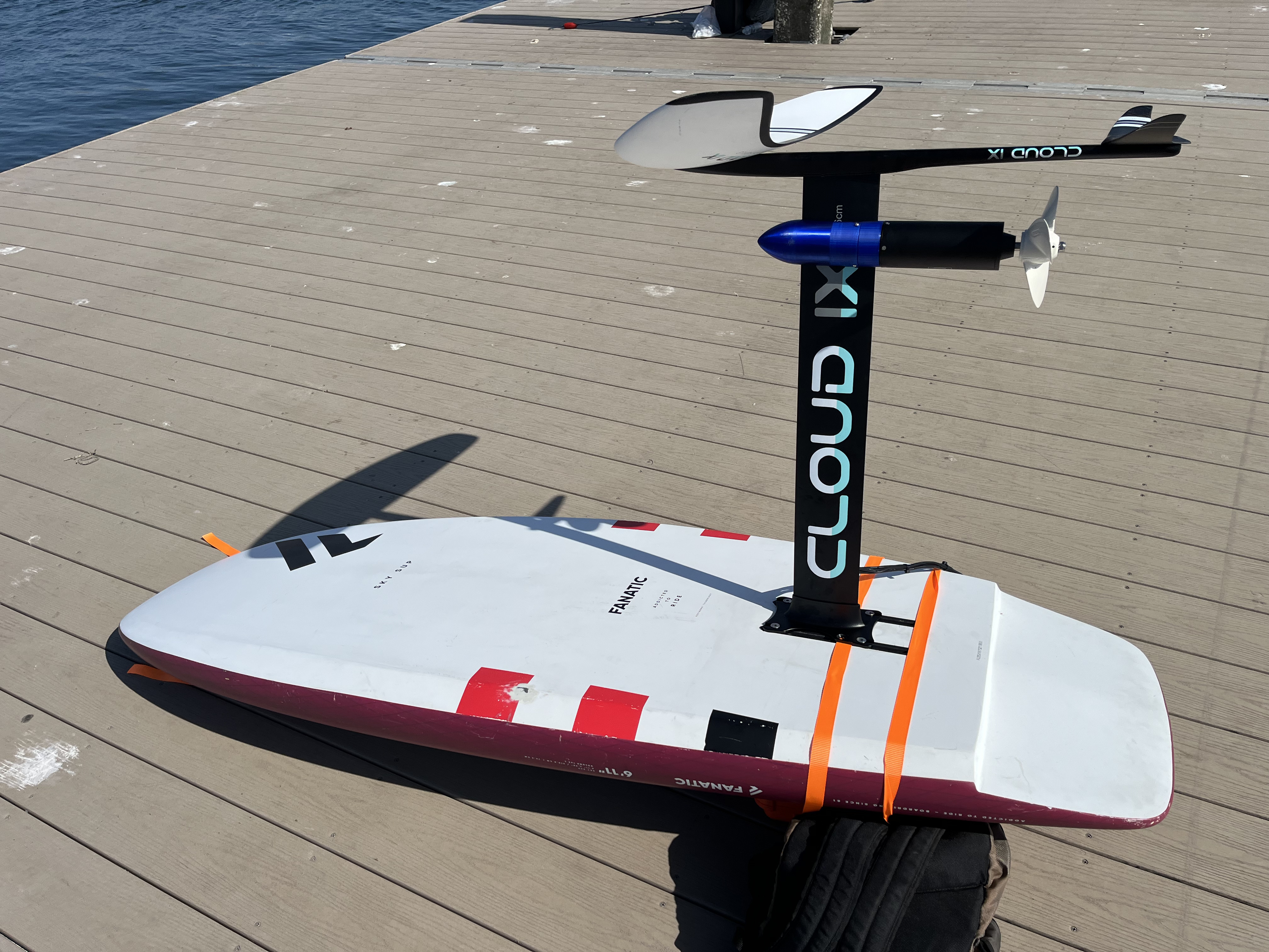

Finished my winter efoil build and slowly learning to ride it but am hampered now by getting a bad electrical constant buzz in the water on bare hands on the board when above about 50% throttle. First two sessions were fine, getting used to balancing on my knees and getting on a consistent “plane” but not on foil. Then during the 3rd session I realized my hands, placed towards the front of the board to balance and put pressure on the front to get on plane, were getting shocked continuously, and uncomfortably. I am running a 14S, 40Ah battery pack in a “Pelican” box also housing the VESC, and strapped to the back of the board. At first I thought it was my motor wires conducting to the mast, maybe through the holes cut in for running the wires in and out of the mast. But I am not showing any conductivity from the motor wires to the mast or motor exterior. But I am seeing very low resistance (maybe 0.1-0.2 ohm) between the motor wires and the motor shaft.So it seems that I have a semi-short somehow in the motor from phase winding to motor shaft. The motor still provides plenty of power (up to 5000W) when accelerating and about 3000 W when cruising around on my knees on a plane but not on foil, as it has since inception (I can upload VESC .csv file if helpful). While I can cruise around on my knees, in a wetsuit and booties, no-hands pretty well, I was just starting to work on getting up on foil and need my hands to push up and balance on the board and that is uncomfortable. If I was further along and getting up on foil quickly I might not care about the conductivity, but it is probably not good for the motor and I will probably leave a trail of stunned fish behind me. Any tips? I am not really looking forward to opening the motor, as I recall it is a little hard to get back together and well waterproofed, but am prepared to do so. I have other Flipsky and Maytech motors that have failed on me in my outboard 10hp motor conversion on a skiff, due to bad bearings or circlip or water intrusion and have opened those before to find burned windings, etc., so have a little experience getting the motors open and put back together. But hoping there might be some trick or common cause for this “shocking” phenomenon. Anyone have a spare 65161 or equivalent for sale? I want to get back on the water!

  1. Looks like the white prop bundled with 65161 motor - it’s too large for efoiling -well documented here.

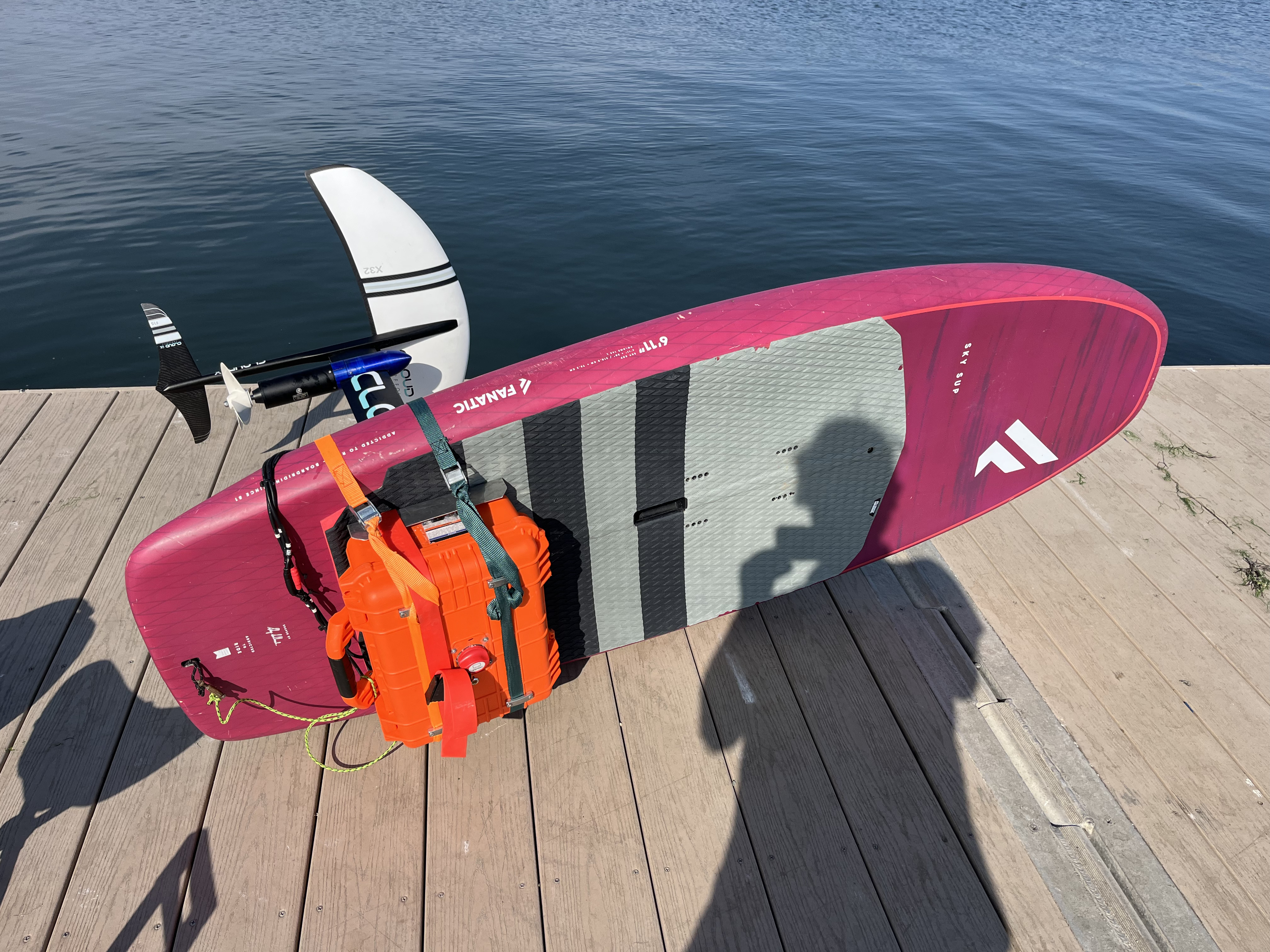

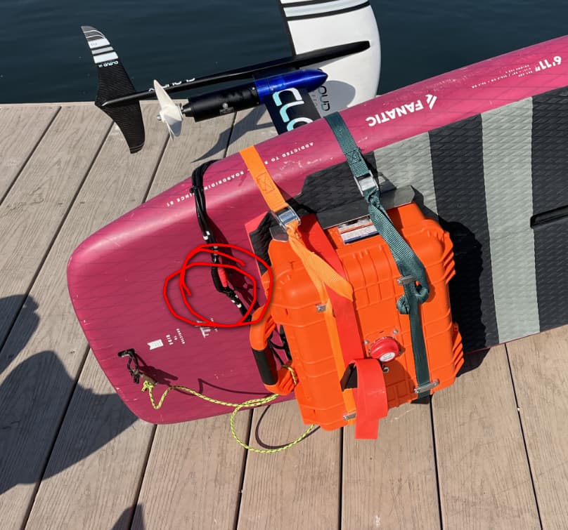

  2. The battery box looks like it is right where your back foot should be when standing - might be camera angle but have a look at forum for proper placement.
Those connectors look like as150 and are not waterproof.

Good points. Yes, I am using the stock prop for now. 7". Sounds like efoils are using higher quality 6". I need to review here to see which is preferred, is available in the US, and is an ok price. Let me know if something stands out. And yes, I am concerned about having the box in the way of the back foot. I can cut off some of the raised footpad foam so that I can move the box back some inches. On my knees it has not been an issue but that is not the intended use case.
The connectors are the standard issue gold plated bullet connectors. I had them each in their own “waterproof” cover made from modified “glands” and that worked pretty well, but I saw a small amount of moisture in one of them after a session so I thought the same as you, and I got rid of the covers and just covered the joints with waterproof heat shrink which I think is actually keeping them dry. I also tried tieing the connector bundle you see up higher to the box to keep them out of the water and it seemed to make no difference. That led me to think the problem is with the motor. And seeing the “short” (very low resistance) from motor wire to the motor shaft seems like confirmation. Interestingly the motor wires are “open circuit” to the motor case and mast and fuselage. So I suspect some winding in the motor is somehow contacting the rotor. This should not happen but I have had other issues with these “waterproof” motors on my outboard engine electric conversion using most of the same parts. What the path of current is, from my hands in the water on the board back to, is unclear to me. Here is a photo of my disassembled Maytech equivalent motor from 2 years ago, where some windings seem to have burned out. Anyone have a good way of repairing this? Seems like I will need to open the Fliupsky motor on the efoil to inspect.
