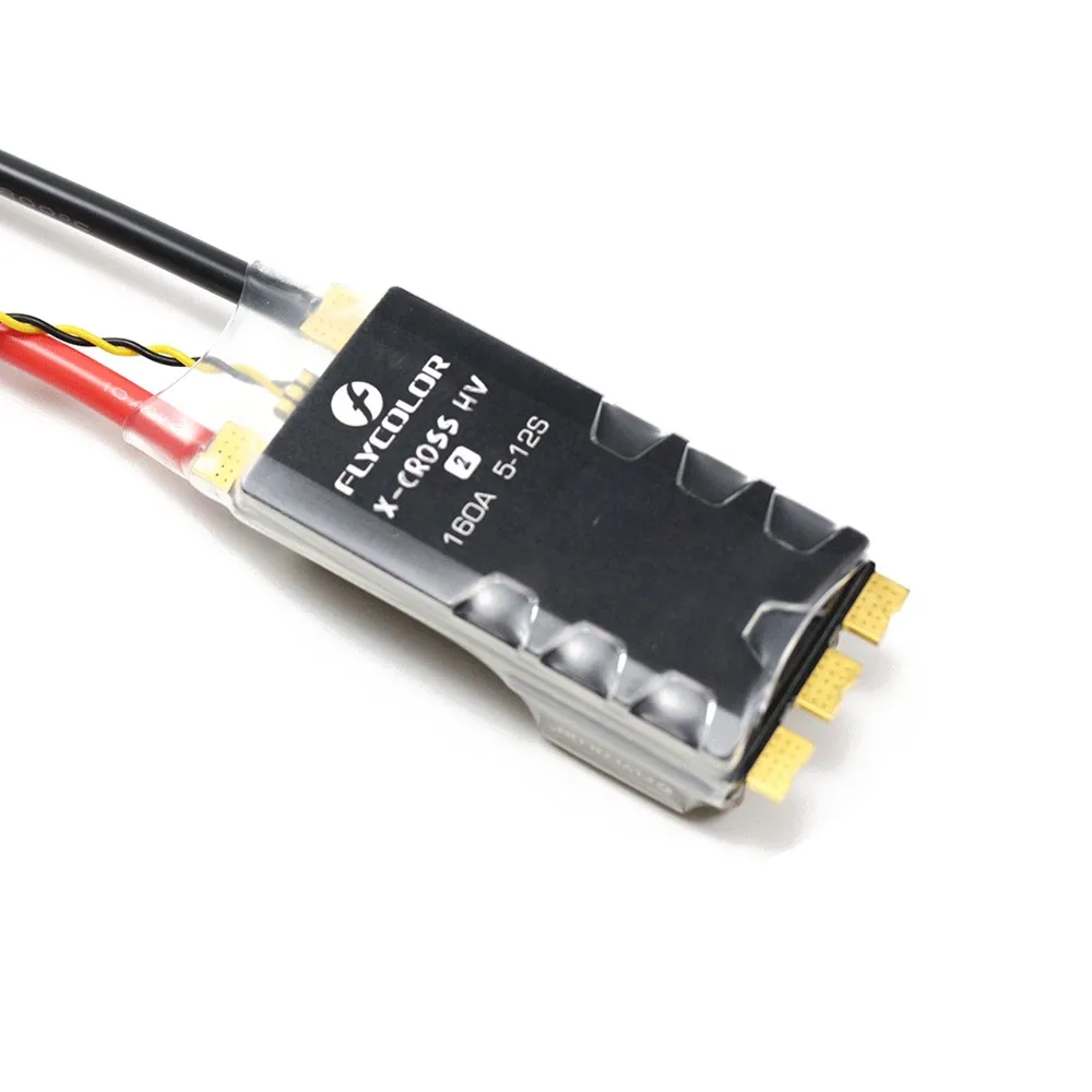

Hi, ESC 12S 160A.
It’s 99$ on Aliexpress:
AliExpress.com Product - 82X34X21mm FLYCOLOR X-Cross HVII 120A 160A 5-12S BLHeli32 Brushless ESC for RC Multirotor X-Class Airplane DIY Parts
FW looks promising, did someone tested it ?

Hi all, I use the X Cross ESC 160 A since several weeks, very happy with it.
It’s fitted with one thick heatsink on the battery side and an other thin heatsink on the box wall side I opened to make contact with an outside heatsink glued with 3M 5200.
I kept the original battery cables and I had to weld the motor cable with an angle of 45 degrees to fit in the Foil Drive assist box.
This controller is setup with Blheli firmware, a lot of options are available, I change the setup with a usb dongle connected between my phone BL Heli app and the PWM/GND/PLUS cable. Very quick and easy to do. I use mainly the motor direction, rampup power, acceleration rate, voltage slow down, current limit, temperature cut off. There are a lot of BLheli video on YouTube.
