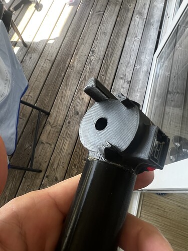

just got a pretty challenging situation where the tube of the trigger broke… and I was full power… a moment of solitude. Fortunately I was not super far from the beach but this was not expected and the only tow went full throttle.
I ordered another BRemote just the Tx and also sent this feedback to Jasmin but this is definitely a critical part
Sorry to hear, was this a preassembled one or printed yourself?
Any external forces when it broke or just out of nowhere?
This is a bit of an expected issue for me since the magnet holder is a thin pillar with a mini-screw that doesn’t go through the whole channel to add support. I’m surprised it’s got the strength it has actually.
pre assembled one. Works like a charm for like 20
rides. I ordered a new one but not sure I can fix this easily because the part is pretty well hidden into the build with foam and epoxy. I can 3d print parts if needed
As far as I understood from the picture it’s not the magnet rod that broke but rather the square tube around this rod
I have fixed one normal range remote like this - see pictures
Basically cut the side piece off flat and replaced with a new one - the foam is strong enough to stay in place
May need to work around the antenna though on the LR version
can Jasmin add some magnets?
I am also going to try your fix but ordered a new remote
I will forward the request to him :slight_smile:
