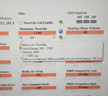

thanks, everything seem to work now (on land), i have just a small problem.
sometimes when i’m not touching the remote, motors have kind of small pulses alternatively left and right (Bi motor) .
i have a big deadzone on the remote … is there any parameters who can cause that ? thank you.
Thats a problem of your ESCs, not the remote.
Set the min timing in BLHeli 100 higher and disable auto calibration
The one in this image (dont copy the value, add to the one your ESC has saved)
The deadzone can be made smaller in the config (deadzone value) but first I would try to recalibrate the remote, as usually the default deadzone value is fine. It should be kind of big since the plastic / steering-toggle mechanism can drift over time
