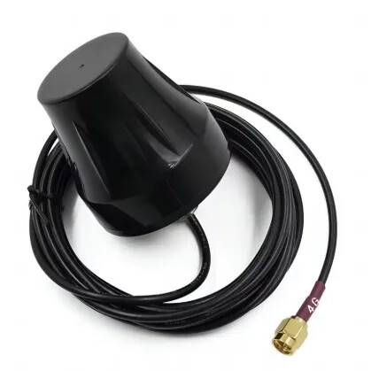

And this antenna:
In that case, raising the boogie antenna up with a pole should provide plenty range
TX 22, RX some value, normal small antenna.
Range is plenty, as long as I can see the boogie.
Will the other antenna help significantly with penetration through water, that is no LOS to antenna?
Trying to get radio waves through water always sucks, can’t do anything against that
But a higher positioned antenna will reduce that. You can also just extend the small antenna or buy any 868MHz antenna that is good quality and waterproof
Just note there is many badly tuned antennae, that will reduce your range :smiley: Try to find SWR measurements in the reviews or measure yourself with a NanoVNA for example

Is that antenna waterproof ?
Yes

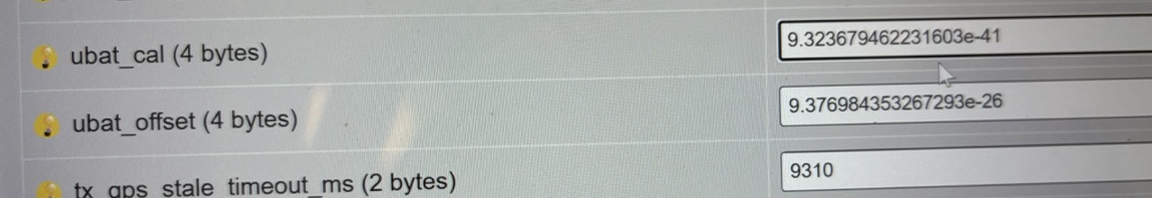

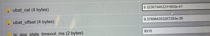

i have 4,2 v delta between Rx and my battery.
Rx read 54.2v and my battery 50v for exemple …
I tried to offset it with “-” didn’t work, and know i can’t even change the values ??
that’s the original values
Something is off with the whole config from what I can see, did you maybe mix Tx, Rx, V1 or V2 when setting the config?
I recommend to do a ?clearSPIFFS on the Rx, then reboot, then do the config again
The ubat-cal should not be changed
The ubat offset put -2 for example to shift the measurement by 2V lower
