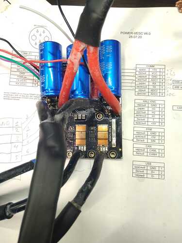

The season is ending! Time to tell stories. I have two for you! The first story is about the long wires from the battery to the esc. My friend, the owner of the blackboard, assembled a new battery and installed new connectors. These connectors are sold with wires, he did not shorten them. While skating, white smoke passed out of his board. When the esc was disassembled, it turned out that the capacitors burned out!
It was not possible to find exactly such. There are none of this size. Others have been installed. Three pieces, but of greater capacity and voltage.

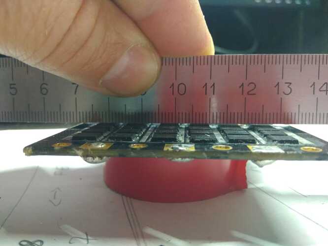

He did not install the board in the case. And installed directly into an aluminum box through a copper gasket and thermal paste. These power keys are ceramic. They have no voltage on the body, so they dispensed with thermal pads.
And he refused water cooling. After the build, everything works. Rolled back 10 hours. The esc temperature does not rise above 30 degrees. But it’s cold now. Let’s see what will happen in the summer.
After the repair, it is still working!
