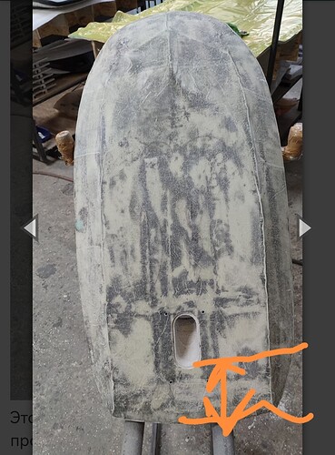

I managed to lift this short board on the wing! To be honest, this is already some kind of circus act. It is very difficult to stand on it! Especially with my weight. But I did it!
And this protruding hatch is very uncomfortable! And it lets water through. We need to redo everything!
that is the length of the board?
The length of the board is 118 cm . And there is no stern behind the mast, she immediately tries to rear up! So there is no stop after the mast! But she’s fat! 85 liters approximately.
