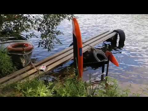

This lake is next to our workshop, the problem is that there is a lot of algae.That’s why the falls!We must go to the open water!

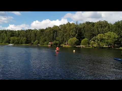

Hi!Finally we are on the wing!!!
