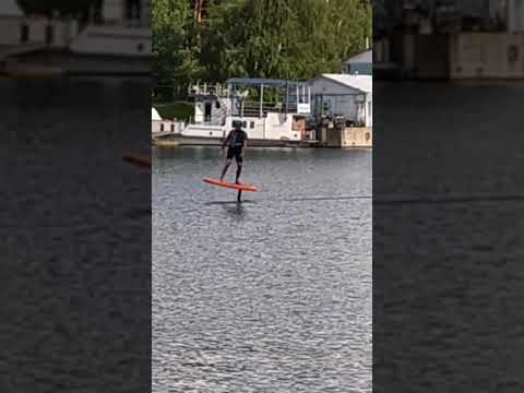

Cut the screw 7 1/2×7 in the image and likeness! As taught! Up to 145 mm.
We can test it in two weeks. We’re on vacation!
Hello everybody!We were finally able to check the cut-off propeller yesterday.It works!At higher speeds, the wing rises!Air and water temperature 10C!It’s good that we have a sauna on the beach!
We also checked our new remote control printed with 100% filling.It’s finally completely waterproof!
We changed the remote’s erganomics.We abandoned the classic trigger and added another start and emergency stop button.It is clamped with three fingers when you hold the handle.Now it operates on the principle of self-control.
