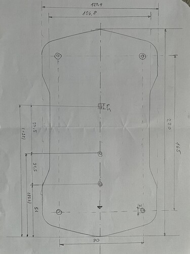

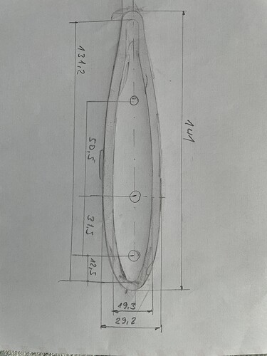

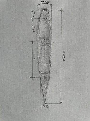

Measurements for GongV3 19mm alu mast, screws are 3xM6
Thank you. I believe that the step file for the 19mm Gong V3 mast was already shared some time ago.
Does it correspond with your mast data?
*Edit. found it: 19 mm Mast by Nabazul | Download free STL model | Printables.com
