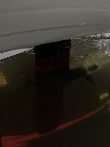

Finally tried my setup and I’m getting some significant cavitation on the propeller, using a FD 3blade prop. Anyone know what this could be caused by? Is it just too close to the water surface? Seems to be still 5-10cm away. Wondering if anyone had the same issue.
During my stationary pool tests I also had to go deep into the water with my motorpod. Approx. 30cm from the tip of the propeller to the water surface.
At high speeds and less distance from the surface, you could see air being carried along the propeller.
I couldn’t tell anything about it during my first driving test. I think there is a difference whether stationary or while driving.
If it’s an outrunner motor then the cavitation might come from the inside of the motor. I’ve had this and it killed my motor. Efoil depth of motor position.
Interesting, thank you, and yes it’s a 6384. I haven’t potted the stator and rotor, so could it be that the extra ‘space’ inside is causing the cavitation? did you find a solution or just not running it as an efoil ever?

I’ve had several outrunners, happened to all of them to some extent depending on riding conditions but the best one was smoothed stator and rotor, streamlined rotor bell and streamlined cap covering the coils at the stator ends. That motor burned eventually but i ran too high motor current, i think it would’ve survived otherwise.
Other people seem to get by without all the smoothing so i’m not sure about the root causes. As cavitation is caused by pressure drop it might be that you need more water intake at the front of the motor than i had, but this is speculation.
I run a 63100 on an efoil for 3 years without problems. I covered the slots at the end of the bell. In the beginning, I only coated stator and rotor with epoxy, I did not fill the slots between the magnets. When I serviced the motor last time, I filled them with a mixture of thickened epoxy and glass bolloons. I didn‘t notice a difference before nd after filling the slots.
See here
I tried a 65161 high on the mast, and got similar cavitation/bubbles. I think it is due to the proximity of the surface.
Both 65161 and 6384 down on efoil position run well and smooth btw
