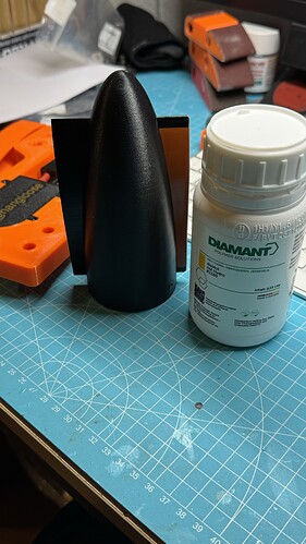

I sealed my 3D printed parts with DIAMANT Polymer Sealant. The sealant makes a very good impression. It seals the surface nicely and penetrates the material like oil.

You cover with the Dichtol the motor mount?
All Parts under water.
Did something push you to do this, or was it just to do what’s right?
I still had the sealant from another project, so I just wanted to test it and see how it performs in the long term.
