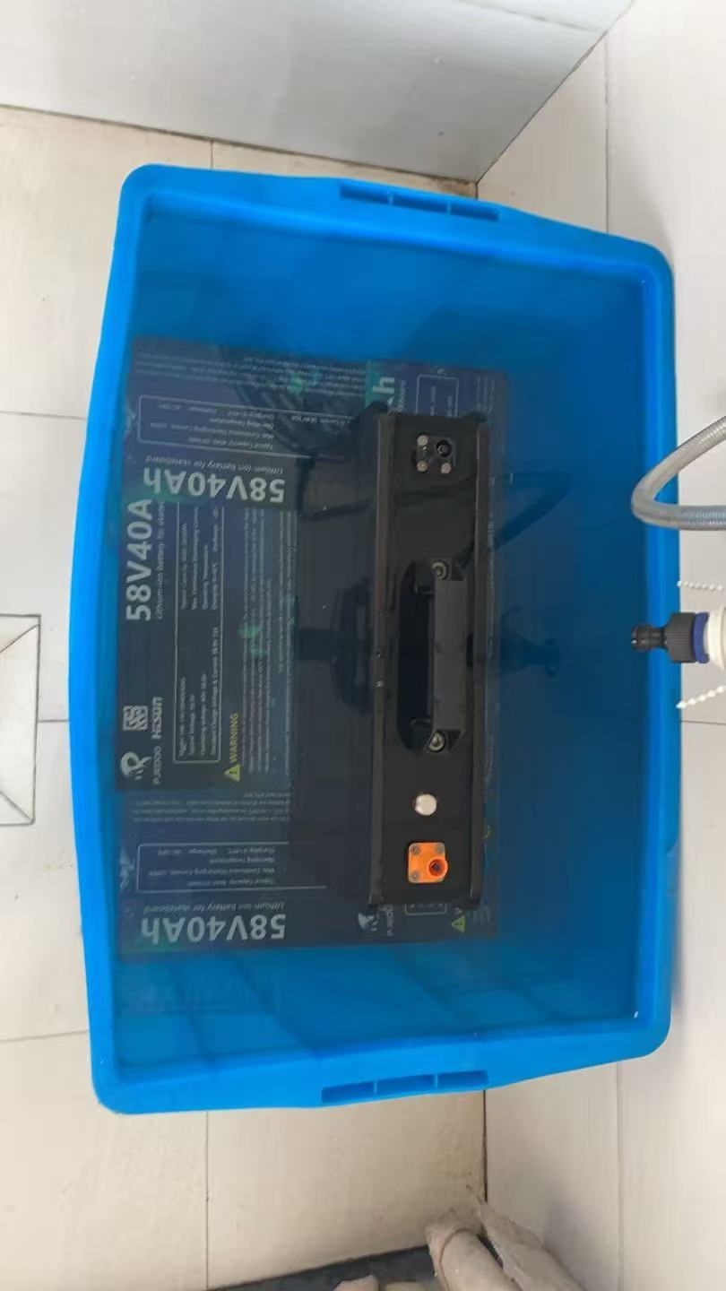

Hello, did you mean that the dripping water is from the battery part? This is a completely waterproof product.
