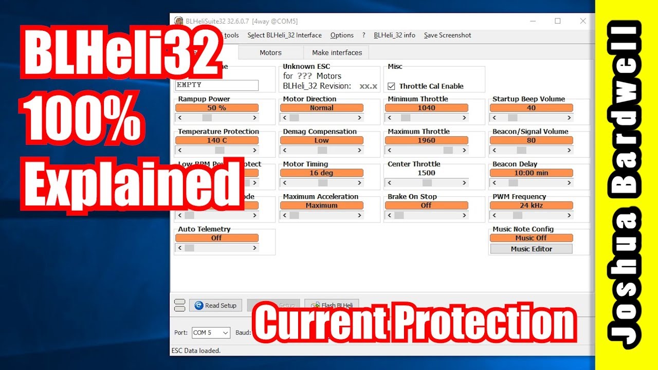

Your observation of turning off current protection reminded me of this video.
They recommend leaving it turned off as it will affect the ESCs ability to accelerate the motor.

One of the more interesting recomendations I have seen with the FlyColor X-cross was to turn off current protection and leave temp protection on. For an assist this should be fine. For a tow-boogie it might be an issue though!
I haven’t had anymore issues since I turned current protection off and temp protection at 100c on my tow boogie.
