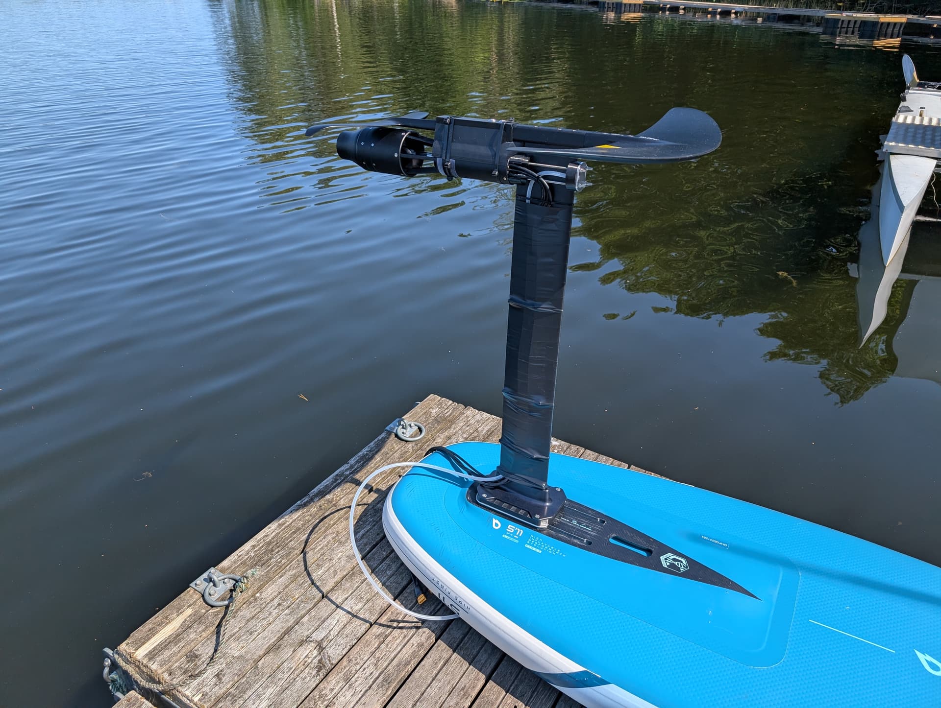

Buy a few more rolls to tape and tape it continuously down the mast. Even with perfect jet/ prop I doubt you could foil with that much drag of the exposed cables!

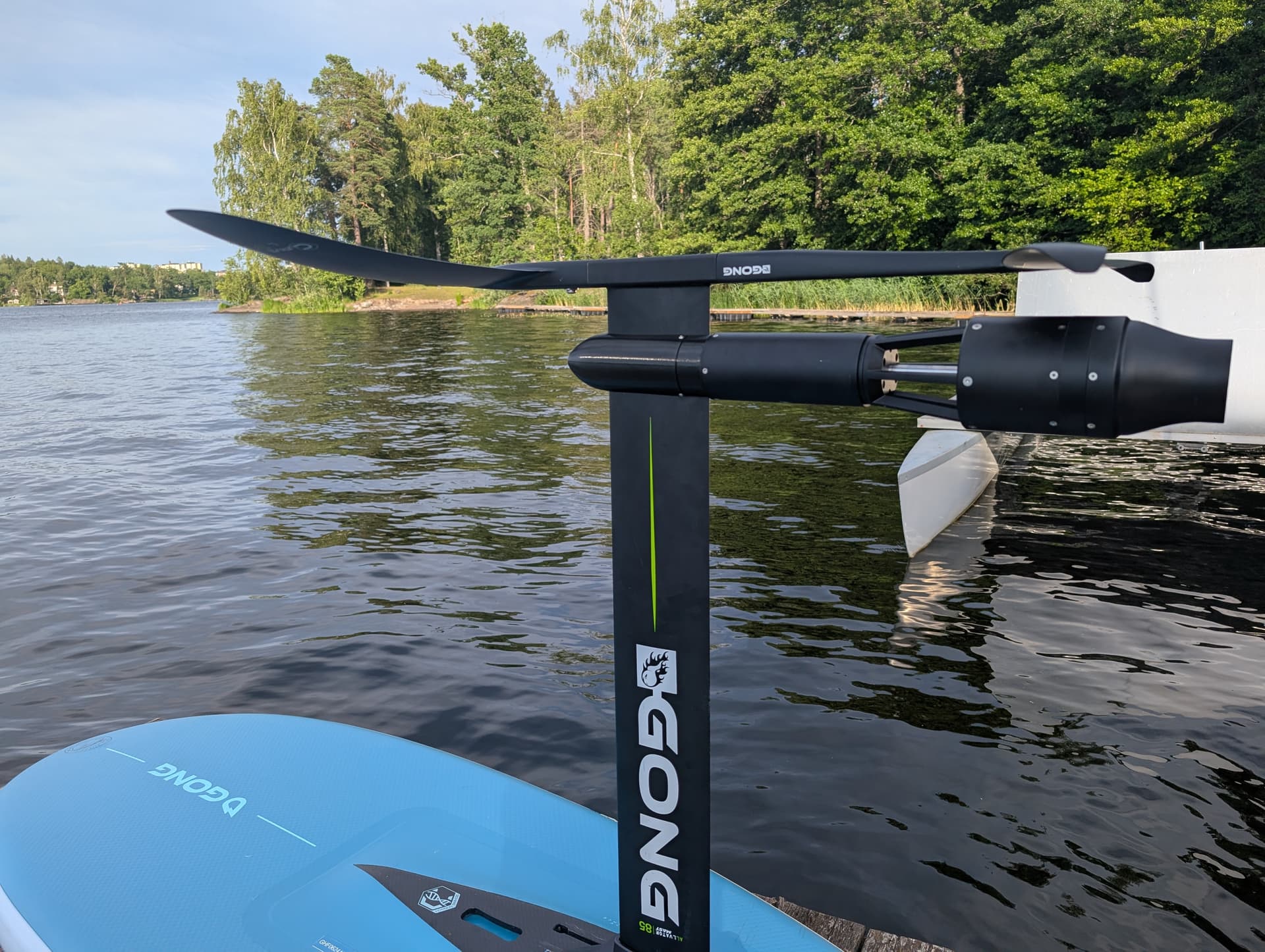

This is now It looked like:
The first try:
The motor only start after holding in the throttle almost to max for about 3s. After it started I could release the throttle a little bit. But I did not get enough speed anyway to get on foil(only about 12-13kmh). I stopped and raised the max motor current i VESC to 200A (from 140A) and the battery current from 80A to 100A.
Second try:
With the higher limits I could get more speed 17-18kmh that was enough to try to get on foil. But I never managed to get on a stable foil. It was extremly unstable! I think the reason is exactly what Strongarm is saying in the post above. My “quick and dirty” running the cables on the side of the mast created a uneven drag (the board turned to the side as soon as I got on foil) . That together with the fact that I dot now have a nose-cone or cover on the mast-clamp created allot of drag everywhere.
I am printing a cable guide now to put on the trailing-edge of the mast and I am planning to make a new try tomorrow.

I had a lot of control issues on my first build due to running wires and water tube external to the mast. I tried printed pieces to allow make things better and they helped a little (maybe :grinning:) but the fix that resolved it was running the wires etc internally.
The other thought I have is the “block” you made to attach the motor to the fuse might be severely disrupting the flow of water to the intake.
Yes, I have been thinking over night and I decided it is probably best to just run the wires in the mast. I did not want to cut a hole in the mast before I have decided where I wanted the motor. And if the Jet did not workout I was planning to use a normal 65161 with a flite-prop (that need a higher mounting point than the jet). That is the reason I was running the wires outside the mast to start with - to be able to decide the position of the hole later.
But now I am going to cut the hole anyway since this is not working. I did print some cable-guides to put on the trailing edge, but I am afraid the mast will be to wide with the guides on and will probably make it harder to turn. So lets cut the hole anyway!
I will cut the hole higher to be able to use a flite-prop in the same position later. This means I will skip the motor-support (to the fuselage) for now and only use the mast-clamp. The clamp is significant more robust than I was expecting anyway. And as Foilguy is saying the support might actually make the jet work less efficient. Also the stab might also not work very good with the jet that close.

I have now finished the new mount and the cables are now inside the mast:
I took the board to the lake for a short first test. The result:
The board had allot more power now. If I accelerate to much the front of the board pitch up and the foil try to engage (with failure since the speed is low). It was almost impossible to get speed and push down the nose. I changed to a smaller stab (from Curve L to Curve M) and it was much better. I finally got up on foil successfully! But I still had to be very careful not to accelerate to much other vice the board pitch up. The Curve M is the smallest stab i have but I could probably use a even smaller.
