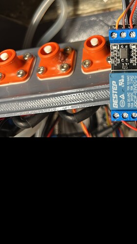

Anyone else having the issue that the IO function is not working? I added a relay to my waterpomp/receiver but it won’t trigger.
Is the pin on High/Low? Please check and let us know.
Yellow wire is used a ground, braun as input. on the relay side I tried several options (no,nc,etc)
We didnt test with this specific type. The relay on the logic side is for 3v. The output you connected is 5v.
The relay works by setting the pin to low. We didn’t test any low side switching, so we cannot tell if this is the issue. Please check if the pin is switching from 3,3v to 0 to ensure that the receiver is operating like it should.
